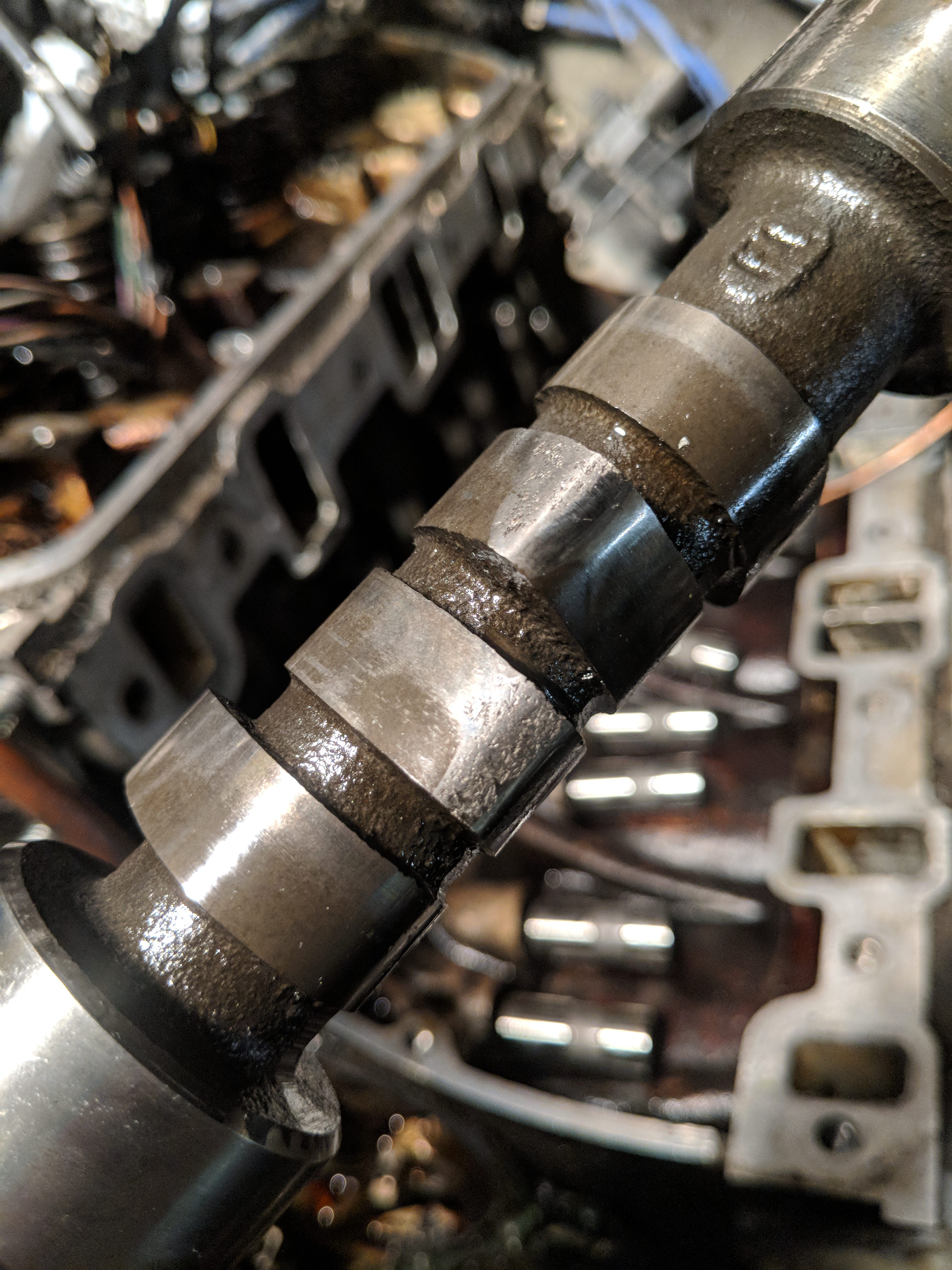

Oooohhhhhhhhh boy. Thanks for the well wishes, fellas. Unfortunately no such luck. It appears I've got 2 lobes wiped on my Kent Sports cam. Only 25k miles on that sucker. I don't blame the cam though. The guy that did my head gaskets also installed my cam and I've had trouble with every single thing he touched. Luckily the cake was the last bit, but I'm still a bit bitter about that. $2500 worth of work down the drain. Exactly the reason I don't trust mechanics to touch my vehicles anymore.
Oh well, life goes on. I guess I'll have to get a cam on order from L8 also. Any idea on the ship times for a Crower cam? Do they keep them in stock? I sure hope so; I don't want to go back to the factory cam.
Anywho, here's the pictures.

Carnage!! I'm surprised a flickering oil light was the only symptom. I don't know about crower cams, but I have a Kent 180 from Turner.

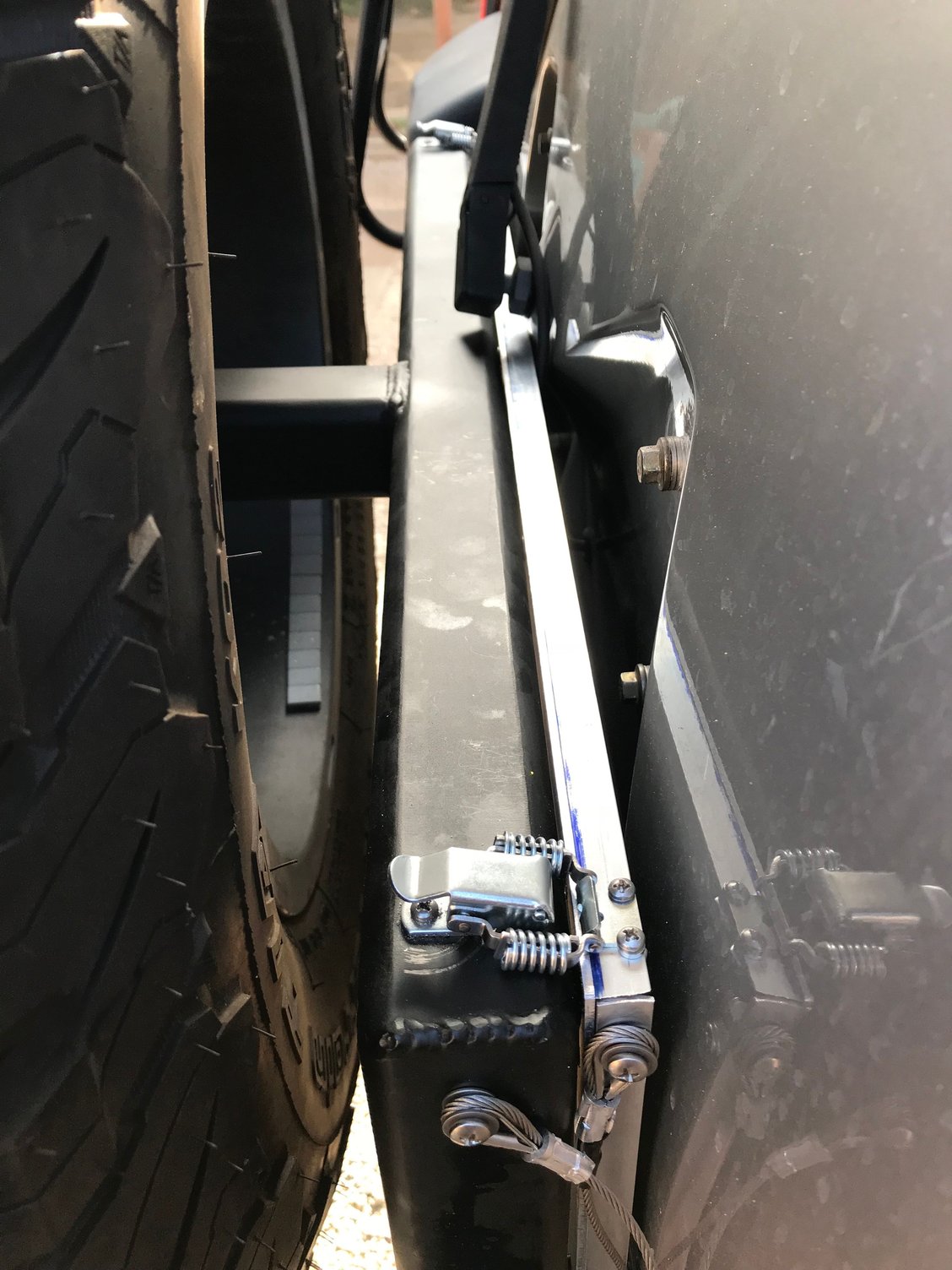

I made a table for my tire carrier today & yesterday. Looks simple, and I'm no perfectionist, but damn it ended up taking two 6 hour days to get done. Having a $15 tap and die set doesn't help either.. ended up having to use a crescent wrench for a tap wrench.
Also whipped up some removable tables with the scrap aluminum sheet and angle. Bonus, you could use these for campfire pot stands too

Your table looks awesome, Jeff! Definitely worth the investment to get some nice taps and a half decent tap wrench. It makes a world of difference. I never use nuts any more on anything I make.

I was gonna go with the 53230 which is the next step up, but it says they're backordered 5 days. Same for the 53229 like yours looks like I'm gonna be going for the 53231 which has 8* more duration and more lift. Wasn't my first choice, but I'm good with it anyway. Better than going back stock.

Jeff, l'd add another screw/roller for the cable, down low on the upright, at a point where when you close the table it pulls the cable tight...less chance of rubbing on the paint of your door or listening to them rattle. Not trying to be critical, just a thought.
Looks great though, two thumbs up.
