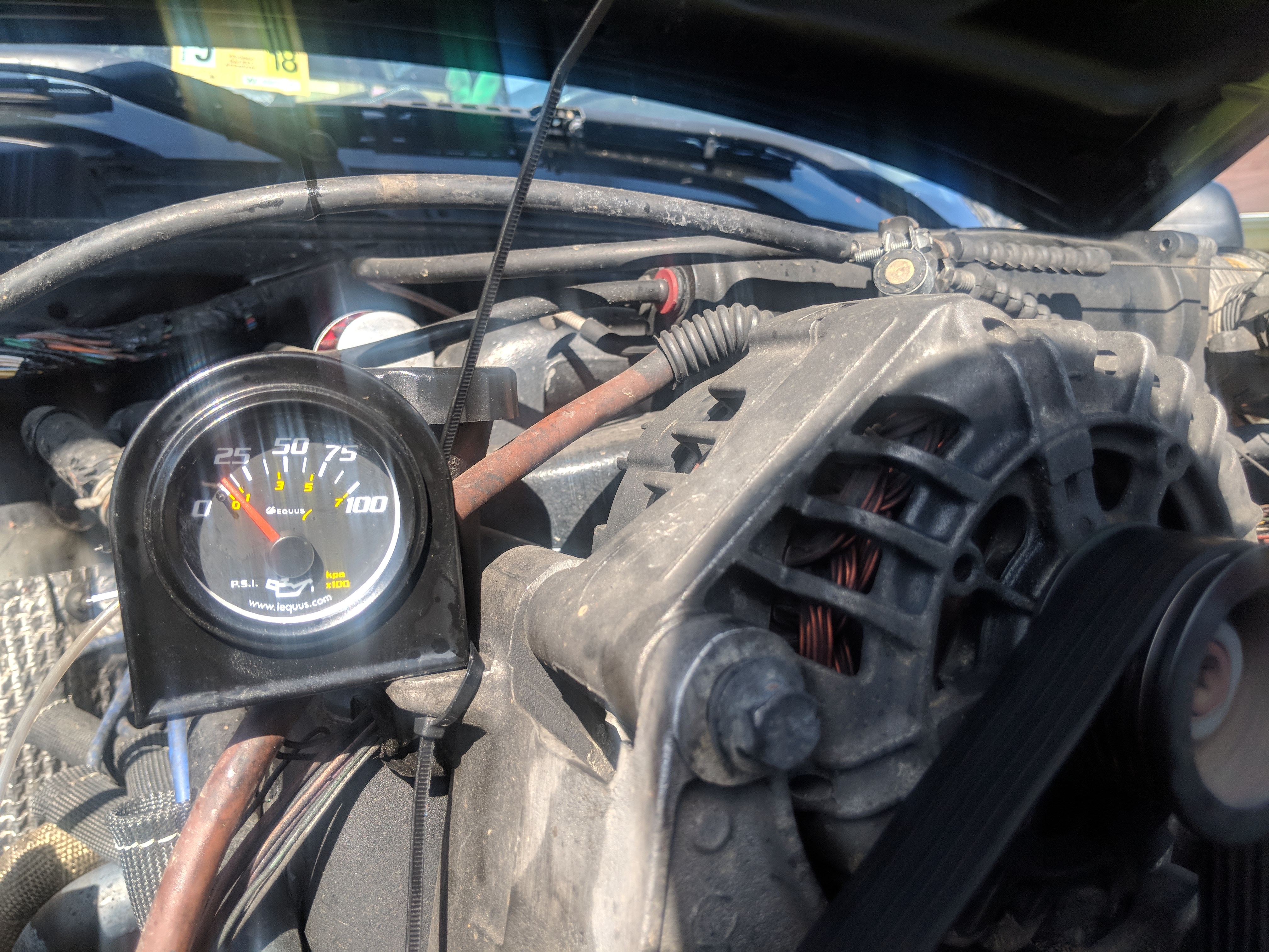

I also changed my oil, and while I was at it I did that thing I've been putting off for about 4 years. I added an oil pressure gauge. I drilled and tapped that plug that's above the oil filter. I did remove the plug to do so; didn't let any metal into my oil passages.
Part of me is glad I installed it. Part of me wishes I hadn't. Check this out (warm idle)
THAT would explain why my oil light has started flicking on here and there at idle. She goes right up as soon as she gets any RPM in her, but idle is pretty sad.
I'm supposed to drive 7 hrs next weekend for a week long beach trip. Guess I better get to dropping the pan on Tuesday to see what the issue is. Pleeeeease be a crusty pickup o-ring.
There's also some cavitation going on. Little bubbles in the oil. Any recommendations or insight are welcome.

Probably time for a new oil pump. What oil are you using? Heavy oil isn't good for this type of pump

Hmm, easiest possible fixes are low oil, a worn relief valve spring in the front cover (highly unlikely), clogged oil pickup or bad o-ring.
Next easiest fix... oil pump.
Next "easiest" fix... cam bearings, main and rod bearings. These are the most likely culprits imo. How many miles on the engine?

156k on the engine. Oil pump is unlikely. It's new maybe 10-15k ago.
I'm fearing a walked cam bearing. Reeeeealy hoping for that o-ring or that the pickup tube is clogged. Probably find out Monday or Tuesday. That is, unless I get a hankering to tear into her tomorrow.

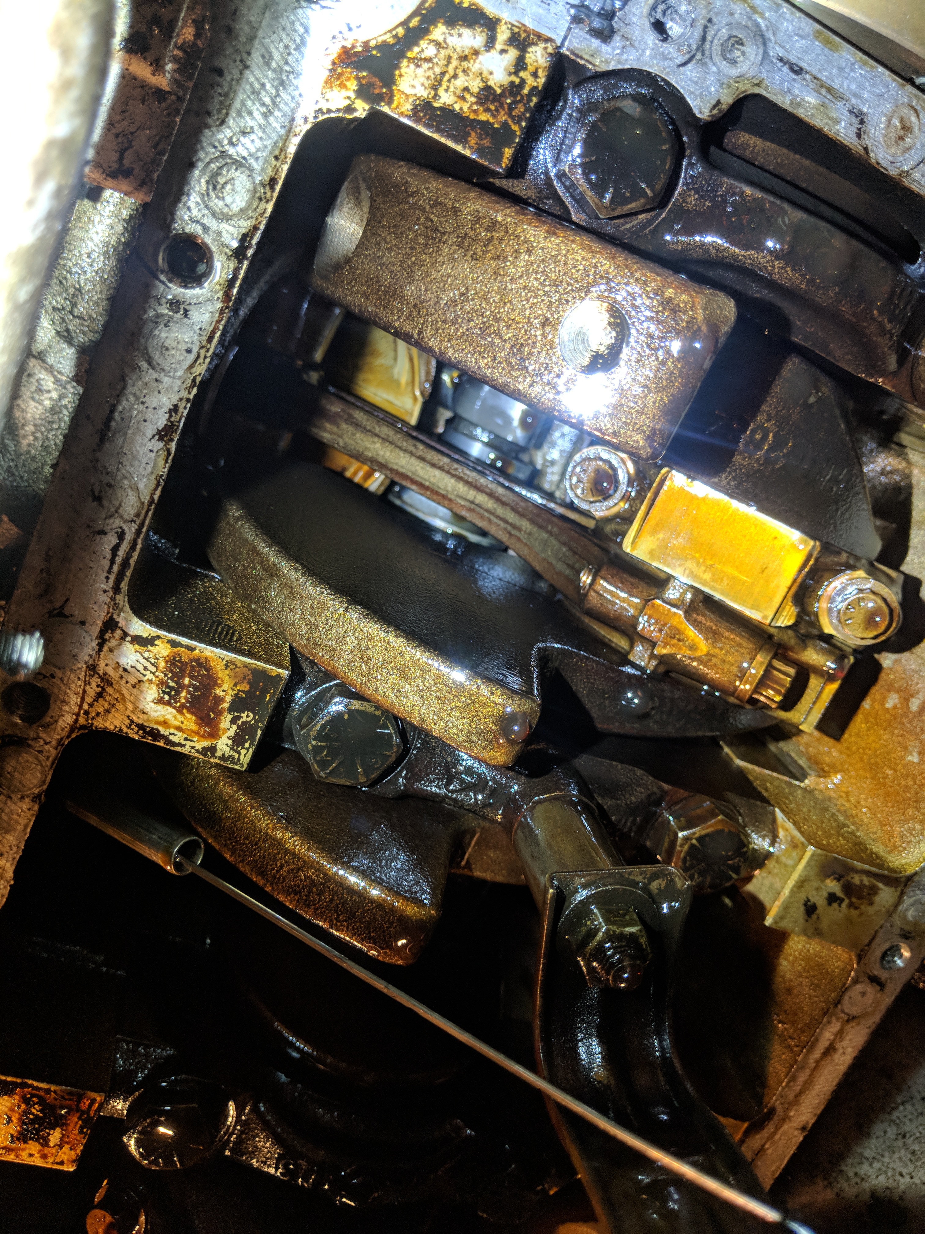

Welp, we're f*cked, boys. #4 cam bearing has walked out. Guess I need to get one overnighted from Lucky 8 tomorrow and see if I can find a bearing installation tool locally.

Damn, that sucks. Might be worth contacting Turner, they're a fraction of the price and should get to you in 2 days. Ironically, made in the USA. Durabond is what you're looking for. https://www.turnerengineering.co.uk/...et-c2x20634667
More info from Turner on oil groove vs smooth bearings:
The camshaft bearings we us do not have the oil grooves (they are Durabond) Durabond offer an option for a bearing that replicates the oem bearing. In reality all v8 bearings tend to wear quite heavily on the thrust side of the front bearing. You could argue that the oil grooves give less bearing surface area. The oem bearing only has oil grooves on the non thrust upper side which may help distribute oil. The reality of the situation is they are all good bearings and they all work however the heavy wear described above appears to be a fact of life with the V8.
