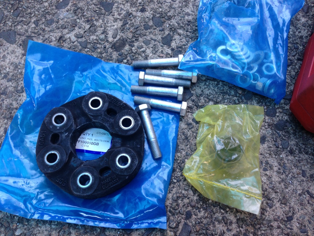

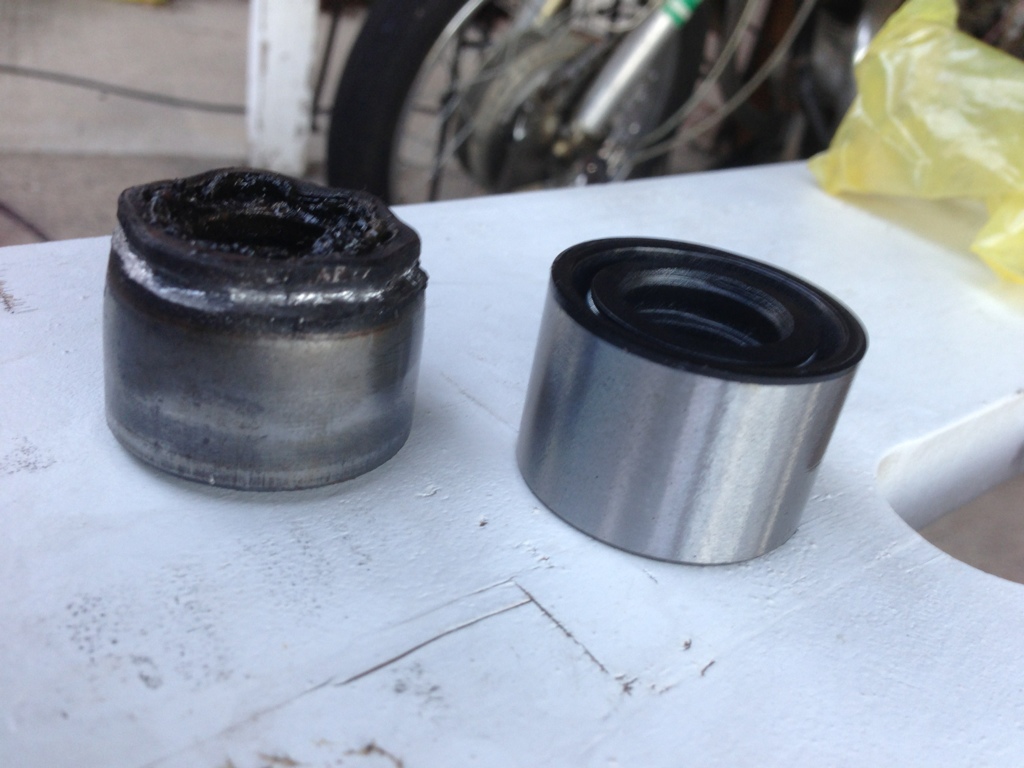

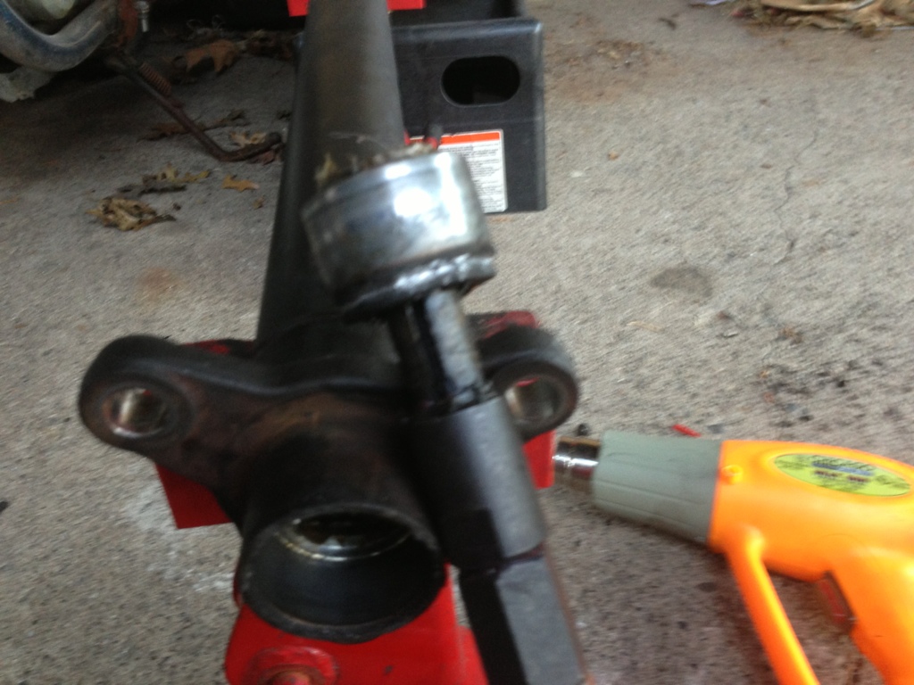

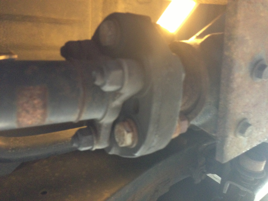

Did the rotoflex donut.

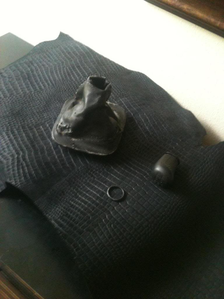

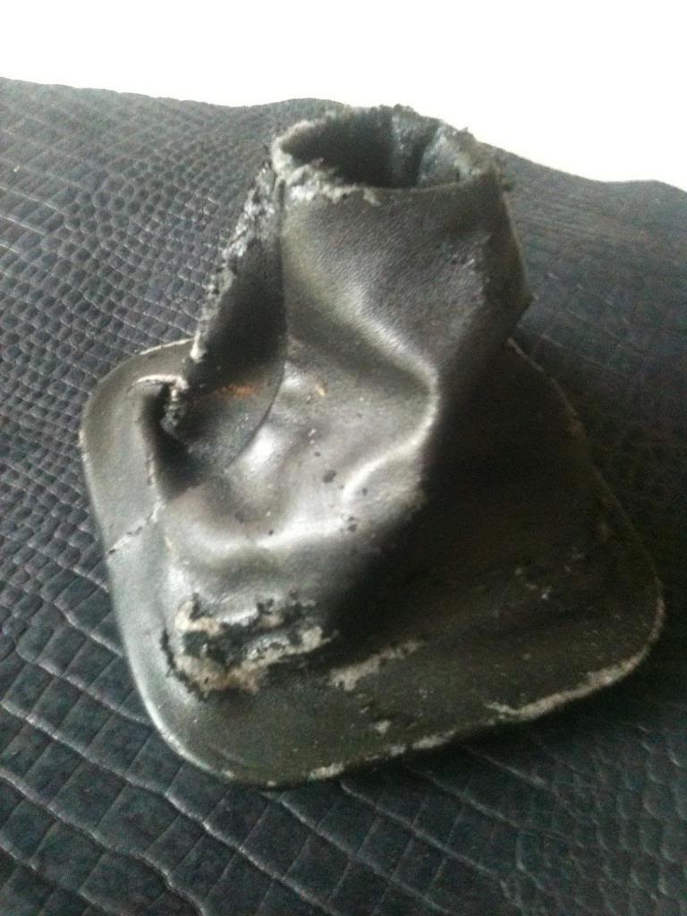

Figured I would share my project. It's a simple and low cost replacement of the crappy boots (CDL/e brake). I absolutely did not want to pay so much for replacement materials that would basically rot again. So I found a nice size piece of suede leather (4 ounce wallet liner leather) with a crocodile print. This whole project cost me around $40.00 and roughly 2 hours of my time. I used a 20"x2" strap to create an overhead console gun holster. Materials needed: leather or material of your choice, white crayola, scissors, 3 tubes of Gorilla super glue, some needle in thread, and a knife or razor to cut the old boot threading. Pull the boots out of your Rover. Peel/Remove the boots from their clips (they are just sticky glued on), split the old seem with a knife (the CDL boot has two seems, only need to split one. I cut one solid piece and sewed one seem. MUCH cleaner look), Lay your boots out over your material and use a white crayola to trace the pattern. Cut it out, sew the seem with the material inside out (this will hide your seem when you reverse it.), run a line of glue over the stitching to add strength. Once the glue has dried simply turn the boots rite side out, stretch it over the clips and glue it on (reverse of removing the old) I couldn't sew a torn pair of pants if I had to, so if I can do this anyone can. Some may not care for the suede look, but I am happy with the results. Save money and use real leather! Suede is durable and simple to keep clean. Using a super lite weight leather means it is very pliable.Name:  photo1_zpsb30d8c23.jpg

Nice work! But in the future, we sell a marine grade replacement for $29.99 that comes pre-cut and sewed, with instructions.
