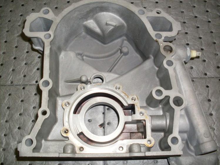

Replaced the water pump and serpentine belt. when the pump goes bad and that fan goes off kilter, your manifold pays a price! Look at those shavings.

Damn, is the timing cover still useable?

Well that's gonna be spendy to replace
Damn! Haven't seen that happen before. Good luck with it

Let the pump wobble and it eats metal. Should be part of the once a week under hood inspection, see if belt is running true and no wobble.
TIG welder? Looks pretty thick in that area, plus that part of the front cover is not under a lot of pressure. Maybe won't have to do anything.

don't worry about it, just smooth out any large burrs, that cover is like $600.00.

I didn't even give it a second thought. The thing is super thick, and I think that most of the shavings were from the aluminum propeller itself.
