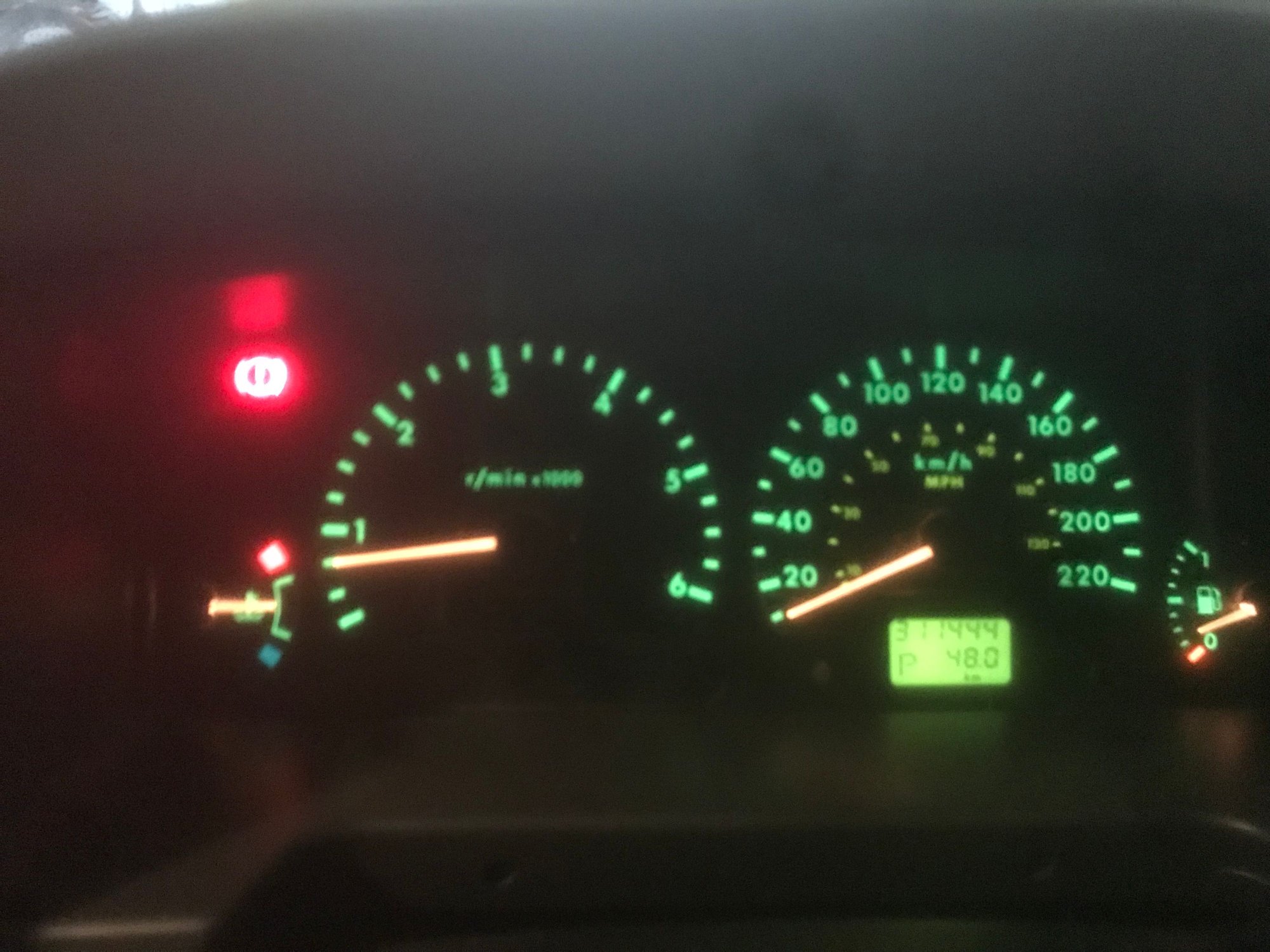

Been on the backburner lately but need to figure the 3 Amigos out. Been driving with those fellas too long and they are starting to annoy me!!!

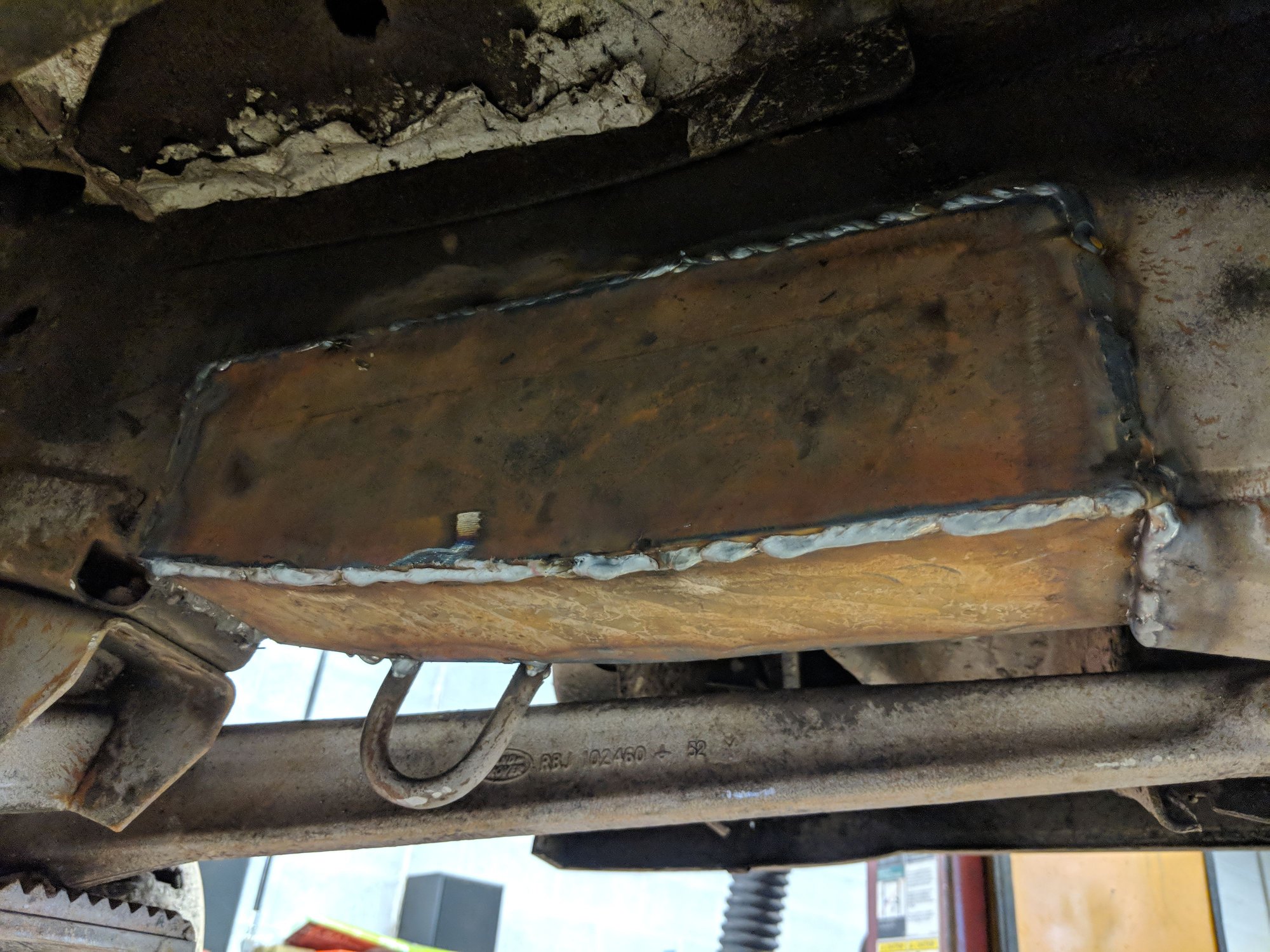

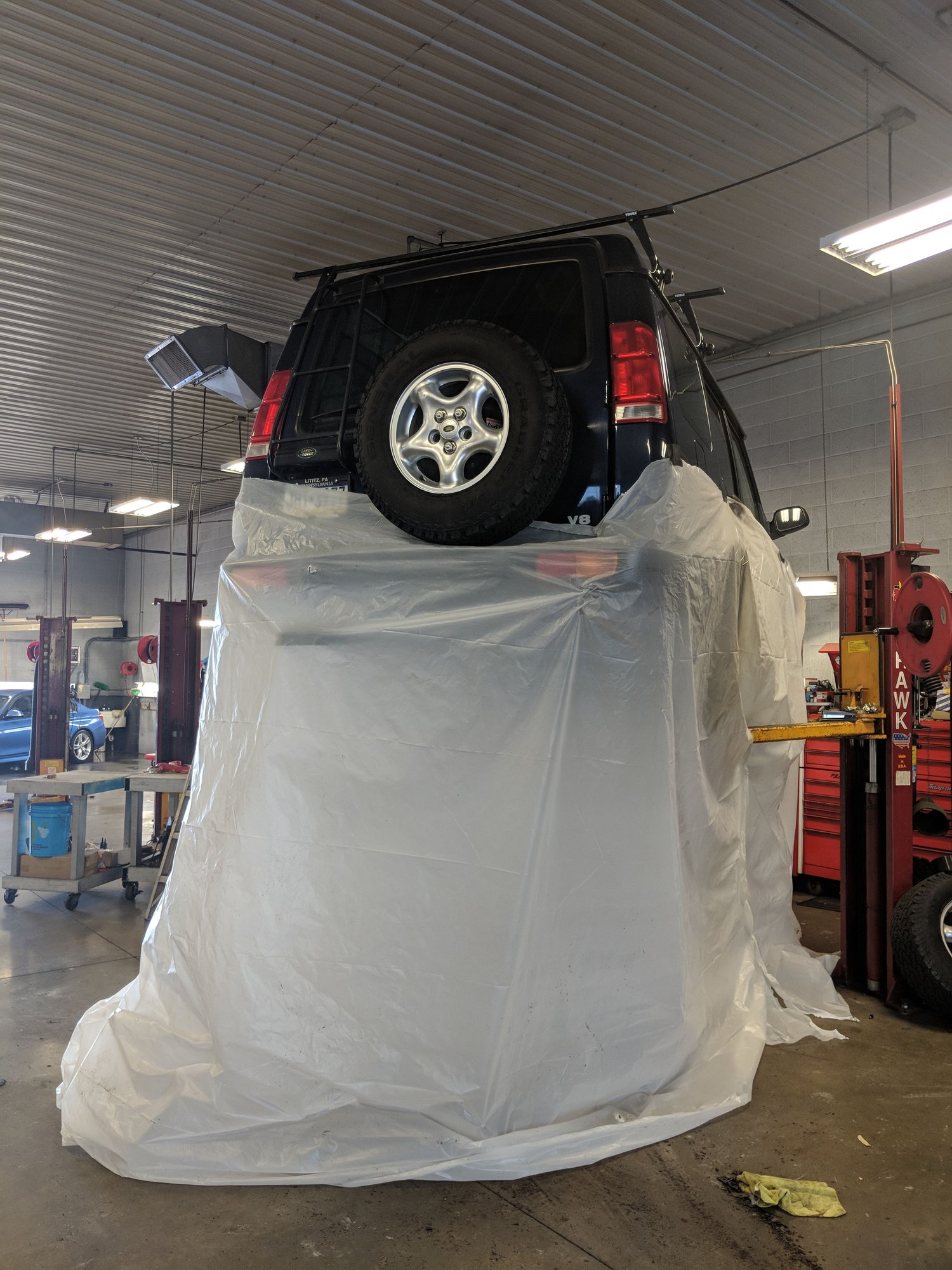

Sand blasted the chassis
Cut out some rust and welded in some 3/16\" steel plates. Once I'm done with the rust repairs I'll POR-15 everything I can. Bedliner coat everything else.

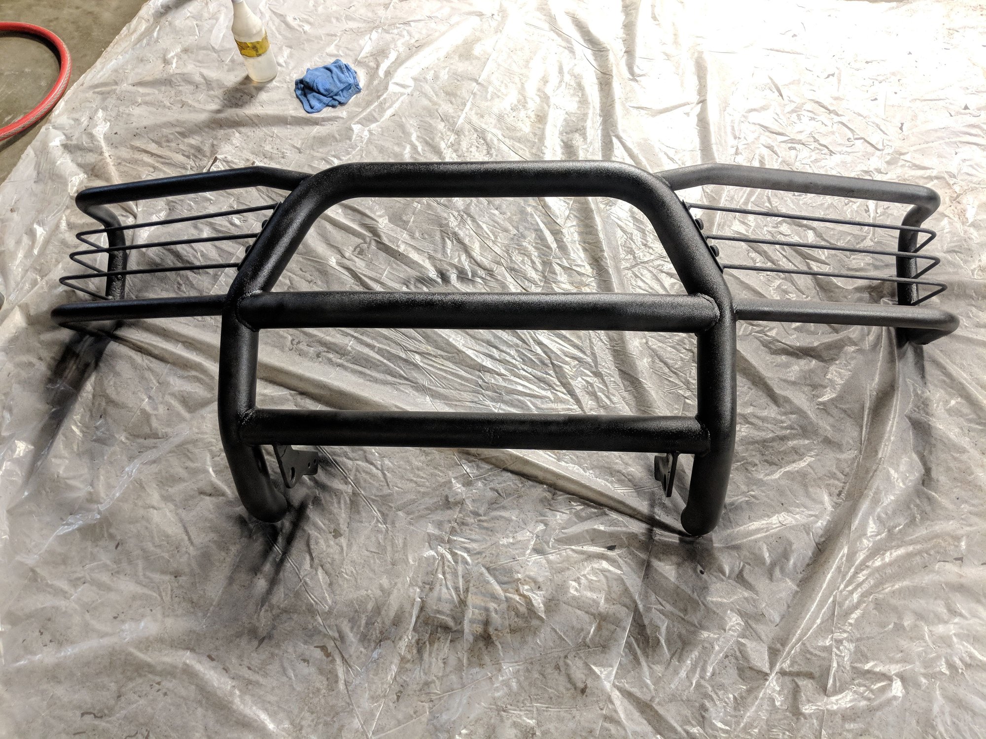

Also sandblasted the OE brushgaurd and coated with bedliner.
