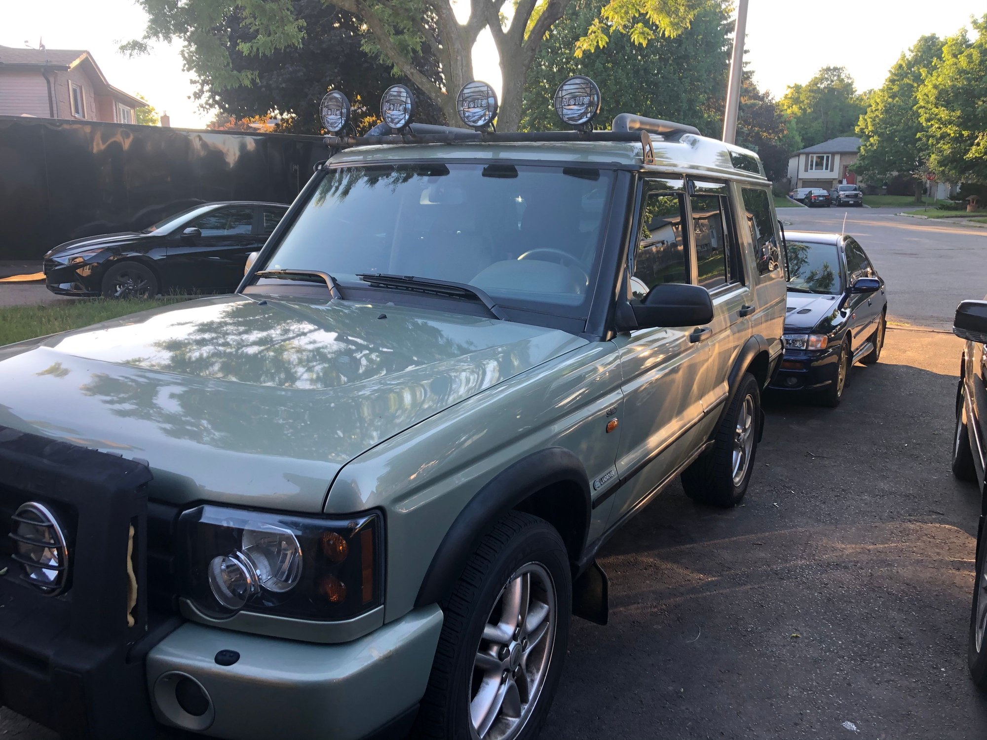

Good old wax job today

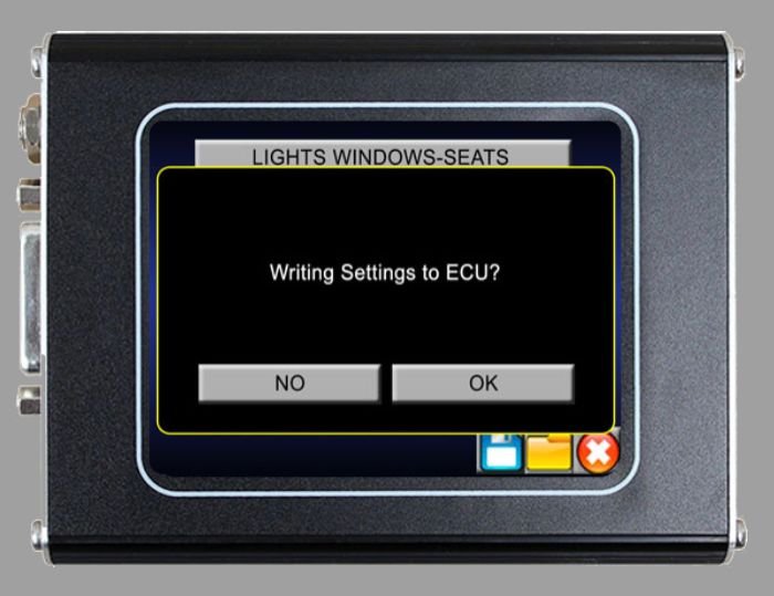

Juke do you have the Nano Faultmate or Evo? I tried turning DRL’s off on my P38 but my Evo doesn’t seem to do it.

I have the Nanocom Evo.
This is the process for a Disco 2 but should be sort of the same for a P38 BECM…
DISCOVERY 2 > TD5 or MOTRONIC > VALEO BCU (BECM) > SETTINGS > LIGHTS WINDOWS-SEATS> on Daytime Run Lights, toggle green button to NONE.
Here is the part people forget to do…
Press red X in bottom right corner > at the bottom of list press “WRITE SETTINGS” >
A pop up will ask “Write Settings to ECU?”, click “OK”. The Nanocom will then write your changes to the BCU/BECM in 2 attempts with a green bar showing it’s progress.
