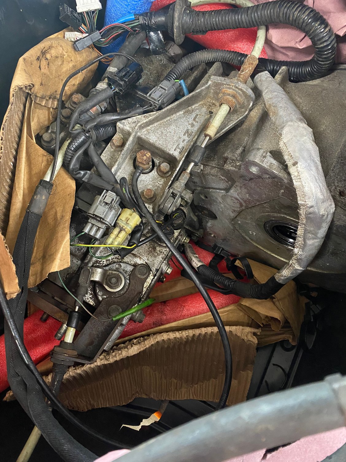

88k mile 04 LT230 just arrived from Will Tillery. Gonna clean it up and reseal a few key spots this winter and probably install in March or so. Couldn’t pass up the low mileage and condition of this unit, so had to go ahead and pick it up.
once I have the CDL in and a winch/bumper, I’ll be pretty confident to hit the types of trails I used to back in my old 04 (north Georgia, Beasley ****, maybe URE, etc)

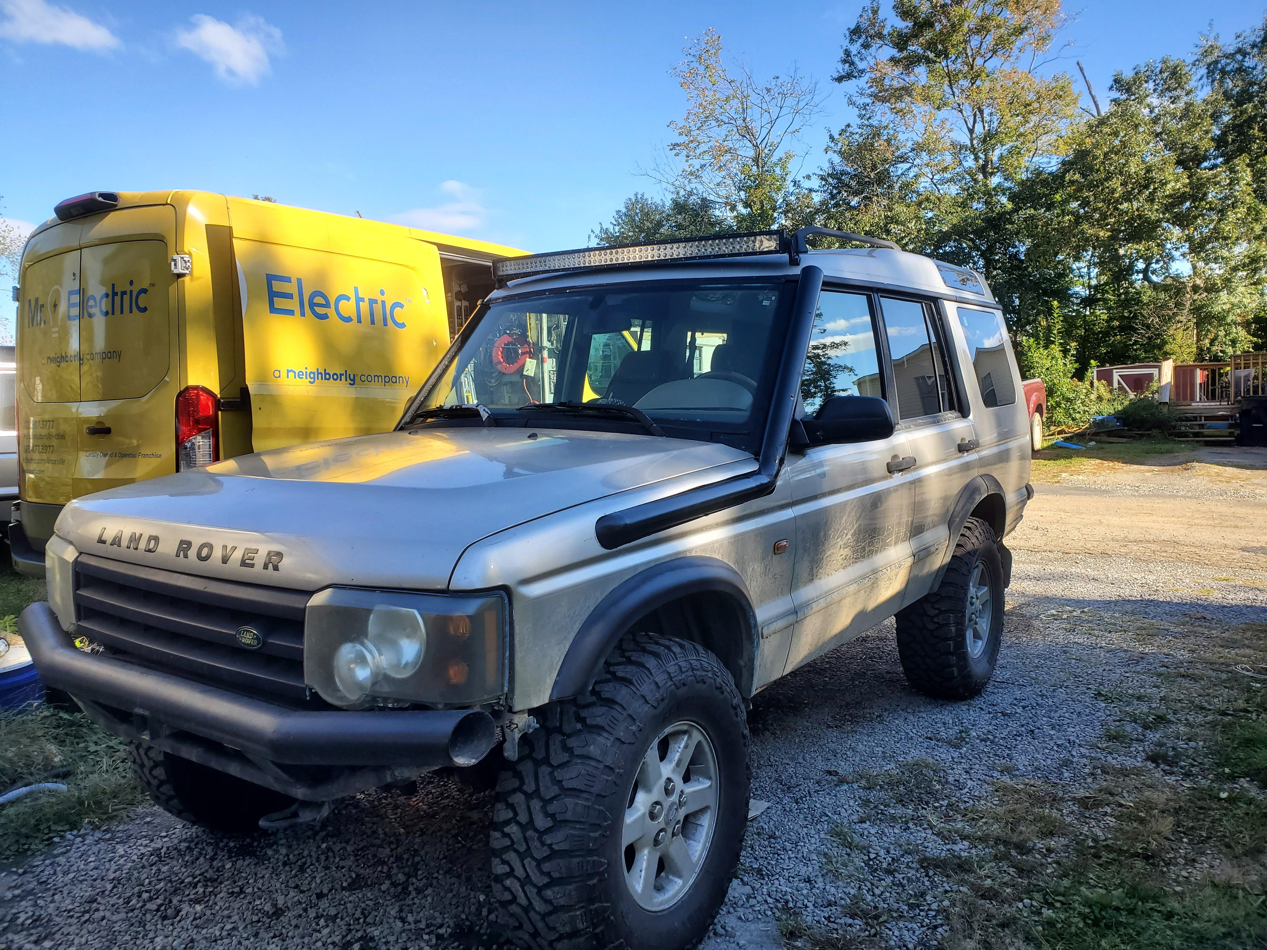

Got the positive test result on a Covid test yesterday. Brought the Disco back over from my folks house today; hopefully I'll be well enough to work on it while I'm quarantined. Intending to build the snorkel and see if I can figure out why the CDL isn't engaging.

Got the snorkel about 90% done today. Need to find my step bit to enlarge the outside holes for the screws to go through, need some 1/4-20 bolts for the mounting, and need to recover the snorkel head from my folks house.
