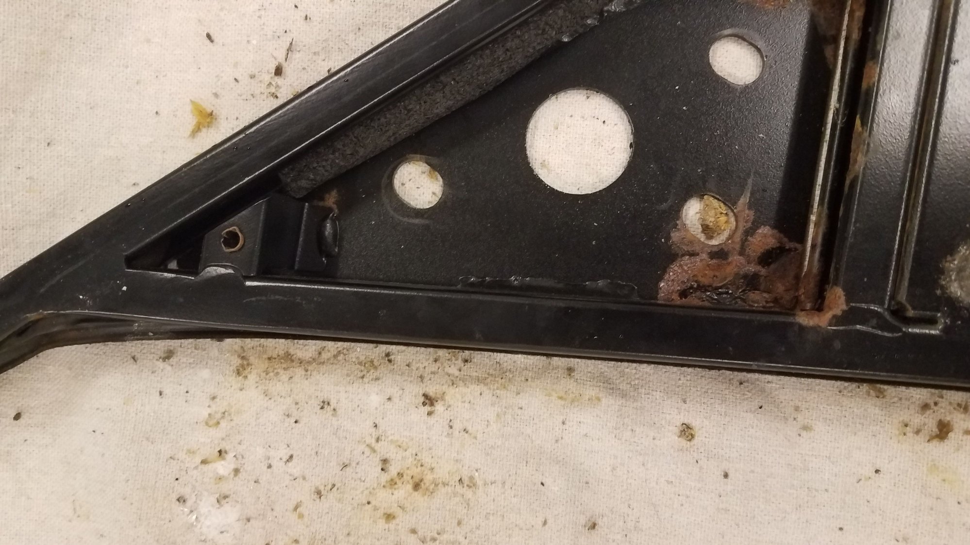

I am in the process of removing and refinishing the door frames, a few have visible rust and after this one, I think there is probably more rust that is not visible on the others. Sanded, primed, painted. Not too bad really, 20 min to remove/install and however much to dremel, sand, prime, paint. Looks much better and probably prevent future problems. One question, there is a two wire connection attached to the power mirror wires. Does anyone know what it is for? I meant to take a picture but it did not work out.

The unused connector could be for the Asian-market folding mirrors.
