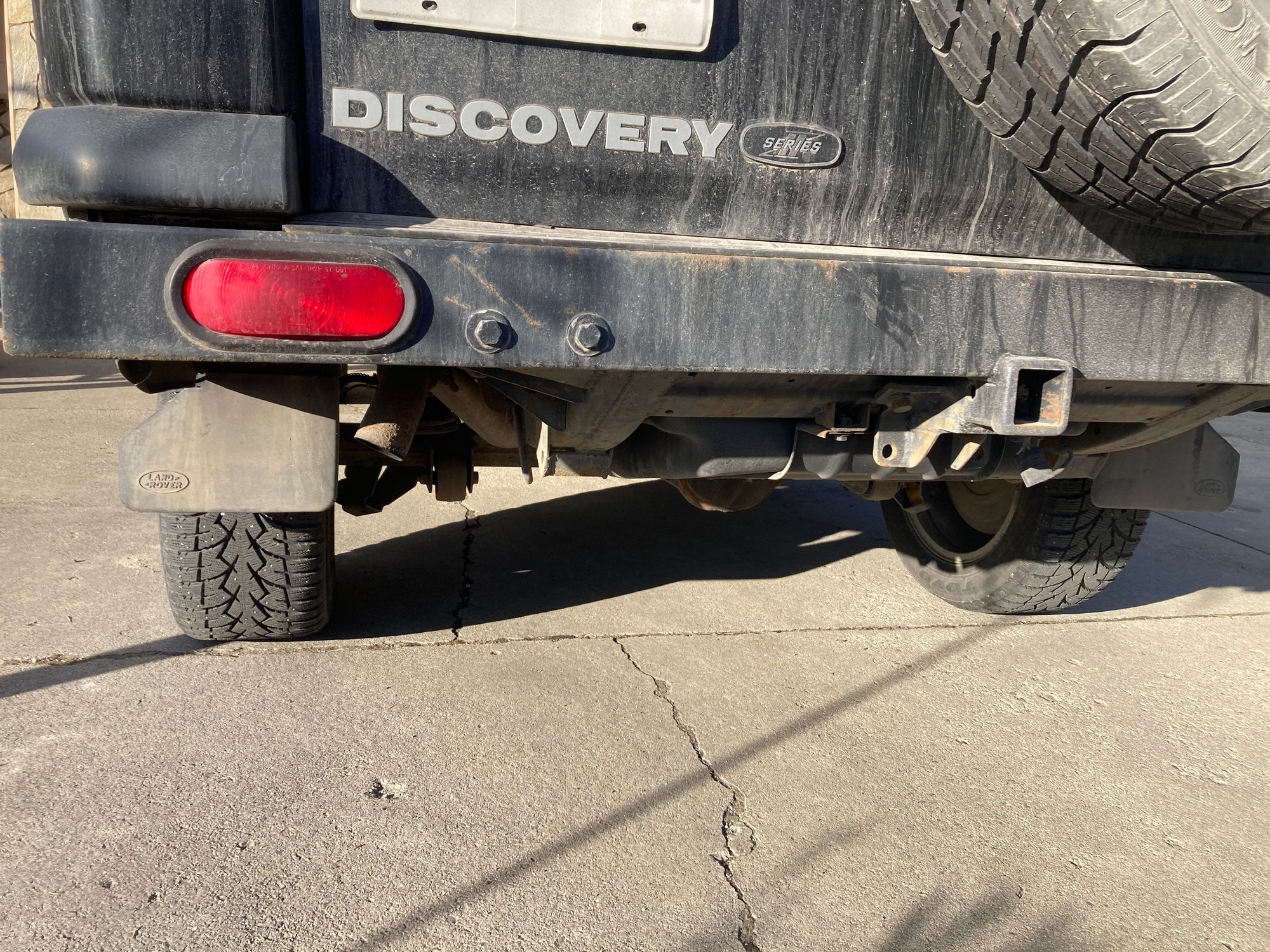

This is what I did (a couple of years ago) for the ridiculously low towing bracket. It probably still needs some better tweaking to make it ideal. Sorry for the late winter mud in the photo. I think the departure angle on the D2 might be its worst design feature.

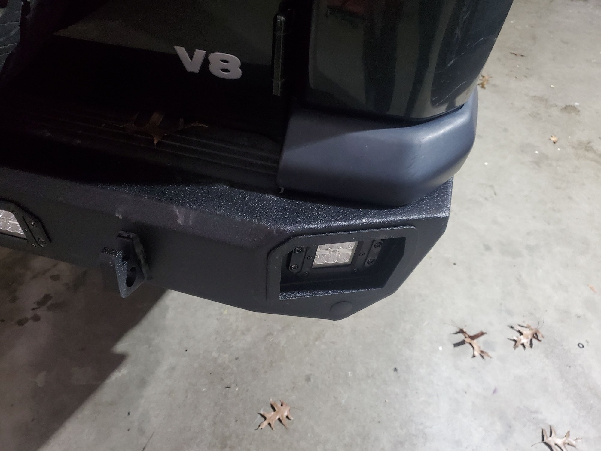

As people probably expected, the area around the back up lights is starting to rust. You can barely see it if you look closely. Looks like a project coming up.
Originally Posted by redrover75
I crushed my original bumper last week, unable to get an OEM for reasonable money, I went with the amazon one for $280 shipped. https://www.amazon.com/dp/B0CL9TFC1P...fed_asin_title
I was not expecting much at all, but the additional reverse lights is a bonus. Surprisingly it fit reasonably well. I need to pull the mounting backets off and lengthen the hole about 1/3" to all it to sit closer to the vehicle, but otherwise it is reasonable quality. With the additional adjustment room I will be able to eliminate all the gaps near the existing body lines. Not the worst $300 I have spent.
