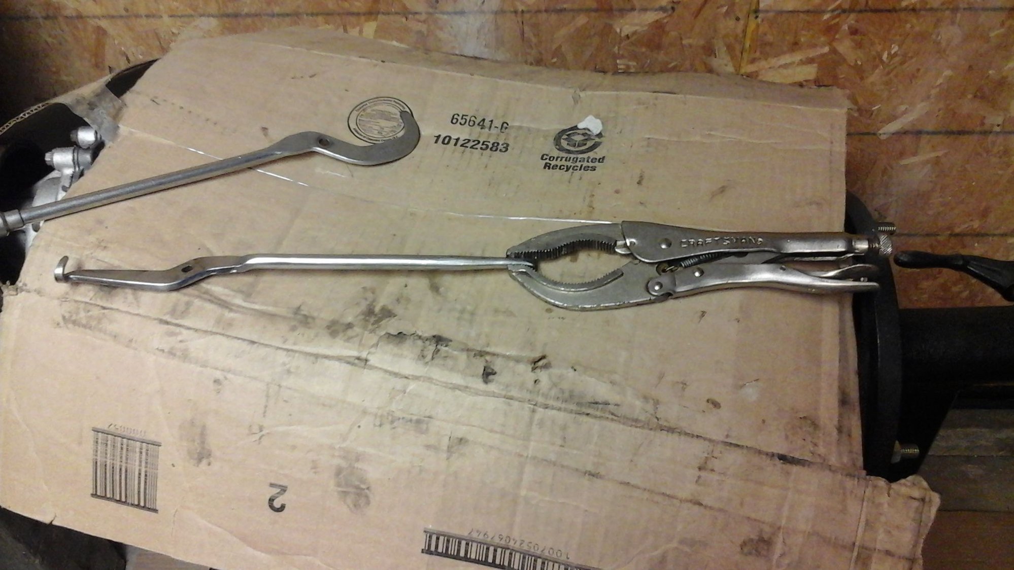

Made a tool to help hold upper portion of plug, since it's hard to get two hands up there from underneath. I snag the upper plug, just above plastic portion of plug, looping the cresent shaped portion of the tool around wires, kind of come in between inner fender and frame with tool...holding with left hand, also using the vise-grips for added leverage and length, and push the plug in with my right hand.
Tool...
The tool is easily made, out of round tubing, if you don't have an old brake tool lying around.

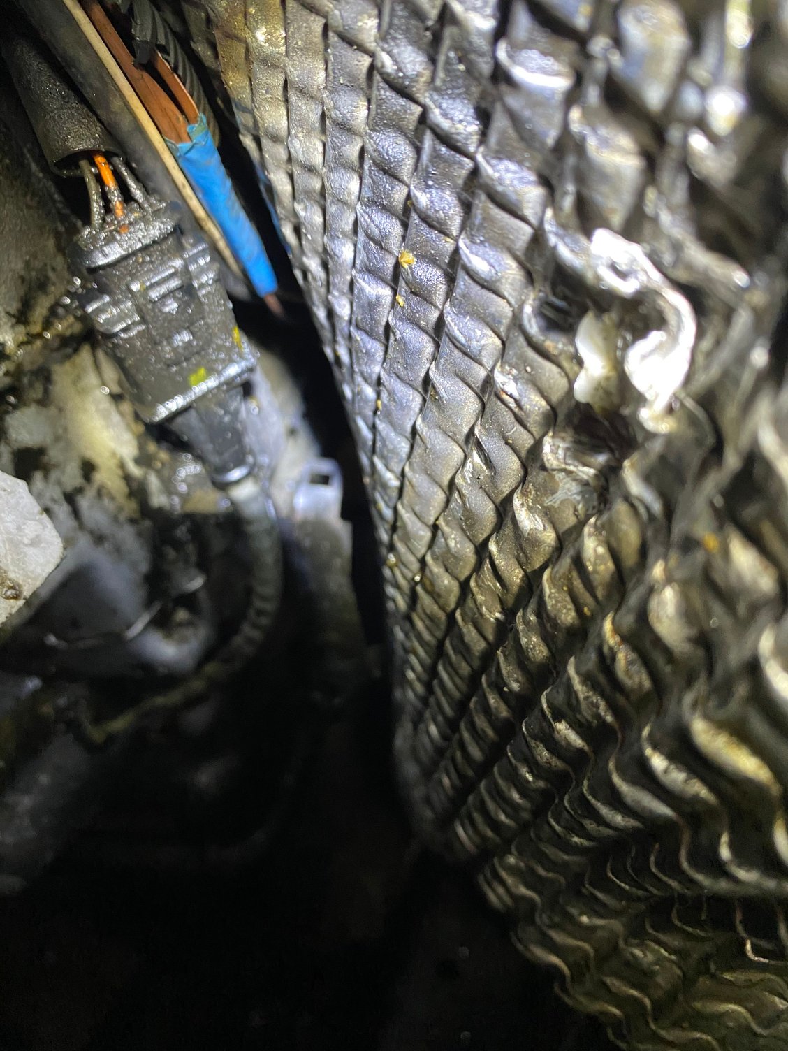

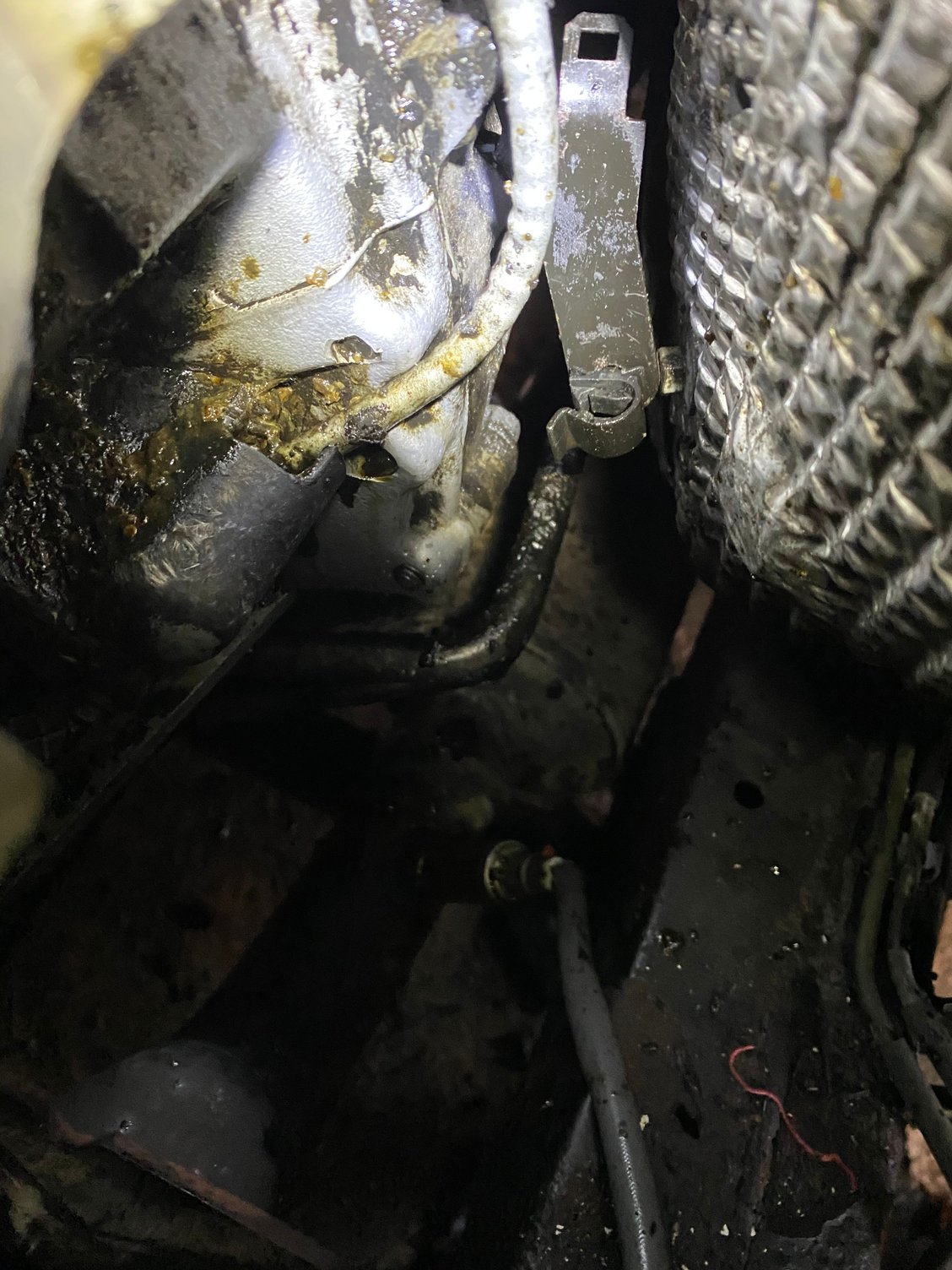

Neat tool Deputy! When I watched the AB video on doing the HG's they told you how to disconnect the plug from the bracket which I did so I have a clear view of the connection:
Yeah, yeah I know there is enough grease and crud down there to lube the tracks on an M1A1 Abrams MBT!
