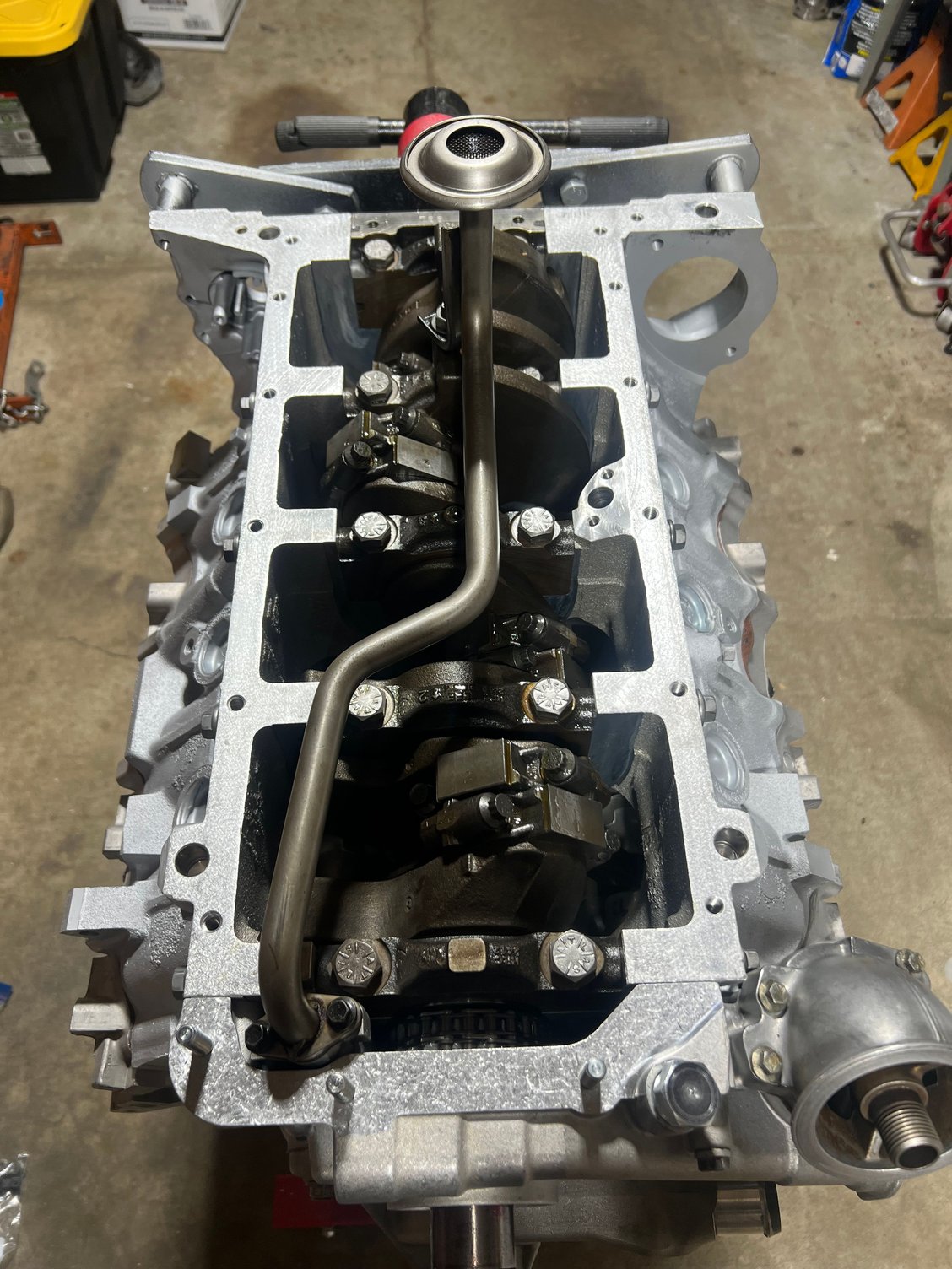

I have a good oil cooler and lines from an ‘02. Will installing this on an ‘04 (LR geniuses omitted oil cooler this MY) negatively affect oil pressure?

Found the old post I was referring to - https://landroverforums.com/forum/di...e2/#post919896
Response #3 mentions the need for a pressure relief valve in the front cover that may - or may not - be included in ‘04 front covers.
How would I be able to tell if there is a PRV in my cover? New build and new genuine LR front cover from Rimmer Bros - https://landroverforums.com/forum/di...ild%85-124413/

They will be under the two hex headed plugs at the bottom of the front cover if they are there, a piston with a spring behind it and then the cap on top of that

Nope, there are two plugs held in with snap rings on either side of the front cover (not hex-head, I mis-spoke initially).

Yep - I know what you’re talking about.
