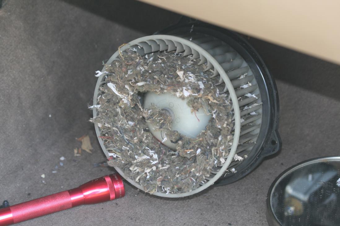

can any one tell me where the air inters from the out side so i can block the varments thanks tj

Center Air Intake Moulding Assembly | Land Rover Parts
From here.

thanks jafir ,,just looked some foam filtering is missing so il replace tj

Land Rover Filter Pollen & Other Parts For Rovers at Atlantic British

Those varmits could well gnaw right through the pollen filter material. Might want to fab your own out of some of that really coarse scrub pad stuff (like used on BBQ grilles), or wrap the foam filter in some sort of wire mesh (like hardware cloth). Since these guys are crawling into your truck, look for chewed wires elsewhere, too.

i think it happened when i did the heads and left the hood up its easy acsess ,,with the hood down theres a plastic grid ,, mite put a strip of aluminum screen then filter ,, ps cleaned all the crap out and works good again tj ,,,,,,,dont leave hood up overnite !!!!!
