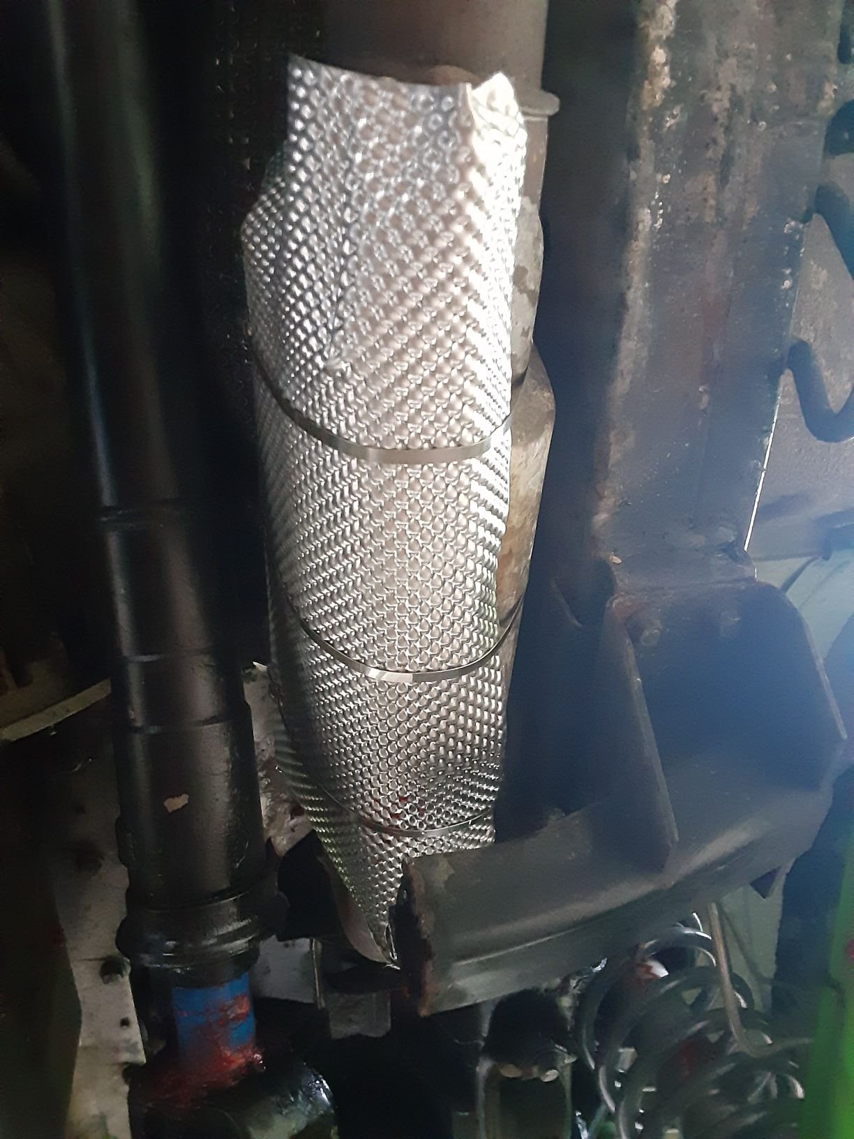

here is my basic heat shield...embossed thick aluminum makes a small air gap shield between cat and shaft. ends of shield with multiple 2" long parallel cuts and then molded around the cat (hard to see). Amazon for heat shield. It is really only the slip joint that sees the most heat...and that is the least likely to fail....
and I still have to design a removeable cross beam....

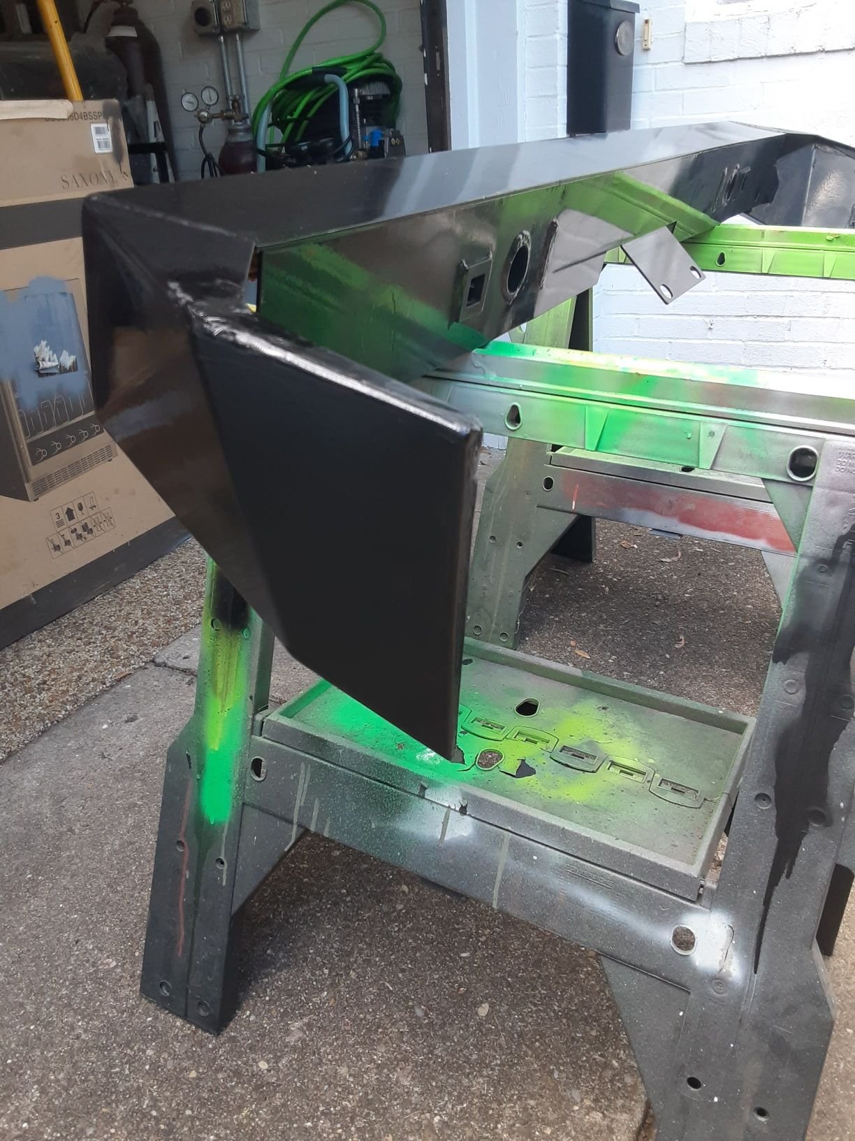

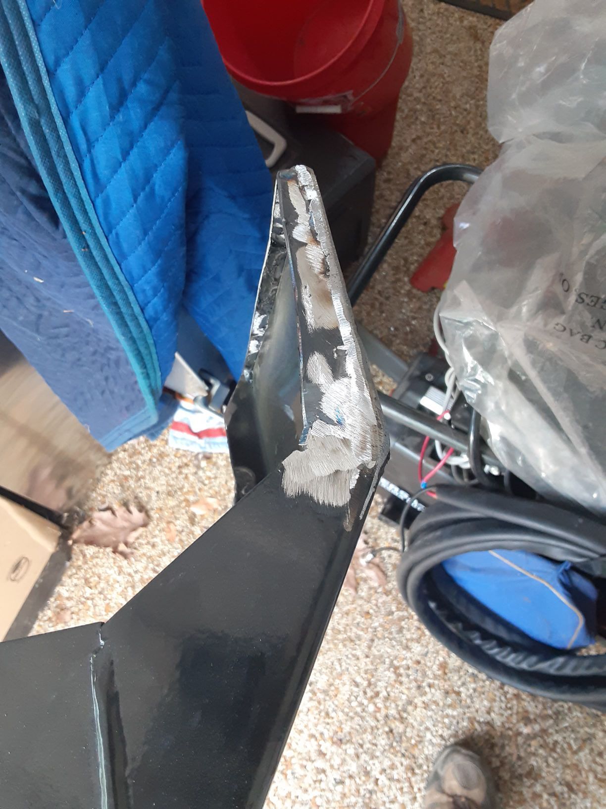

So about a year or so ago, I bought one of those cheaper chinese steel rear bumpers. I saw the reviews about the end caps being too angled. Took my chances....but ended up with one of the defected ones! Soooo....had to trim the ends and reweld them. A good 4 hours of work! Had to use a hydraulic frame straightener to spread the endcaps at least 3/4", and make multiple cuts/re-welds! The end caps were too long, too narrow, and way too high. Also, noticed that the OEM hitch mount bolts, the m14-2 x 80mm, were way too short. Only a few threads were seated, not even to the threadlock. Wonder how many of these 'accidents waiting to happen' are out there??? will mount bumper tomorrow...I also needed additional 1/2 inch steel spacers and m14-2x110mm for the center hitch bolts as the bumper middle flange was not in correct position....... BTW: rustoloeum semi gloss black is a pretty close match...

I have one of those malformed bumpers too. I didn't notice any issues with the bolt lengths or the flange.
I don't have the fab skills necessary to adjust the wraparound pieces so instead I angled the lower edges of the plastic corner trims using a bandsaw. (I have a spare set in case anything went horribly wrong.)
I did put some extra welds on the insides of the corners where there were gaps, and then sprayed with the same paint you did.

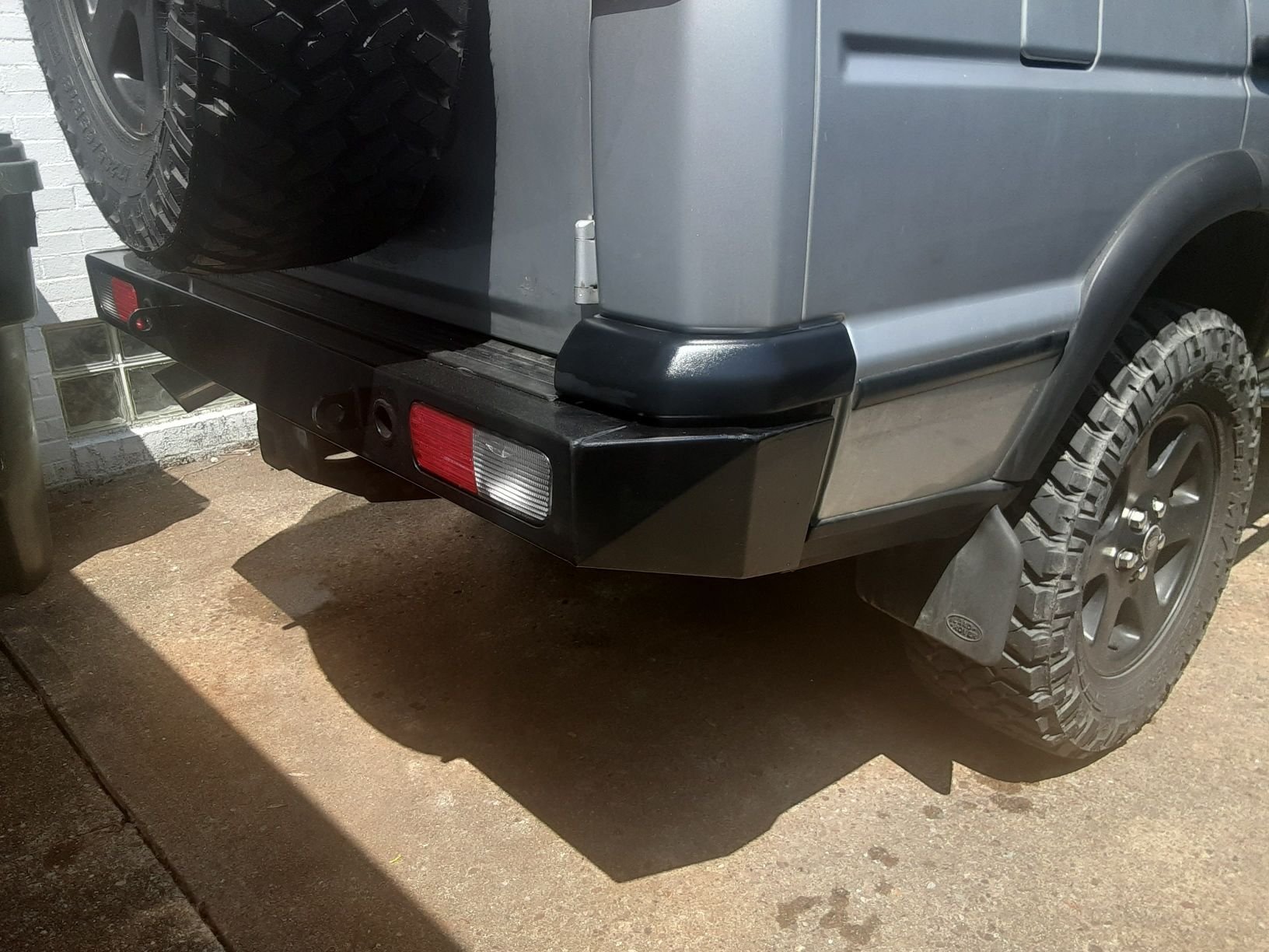

mounted.....

Originally Posted by XRAD
mounted.....
That turned out really good. On one of mine, I’m going to need to do a rear bumper I suspect. The added complexity to mine will be both my D2s have parking sensors, and I’d like to have them functional. I’m hoping I can get away with just drilling holes for the sensors and go from there. But you have shown that you get what you pay for in some instances. Glad you made it work.
