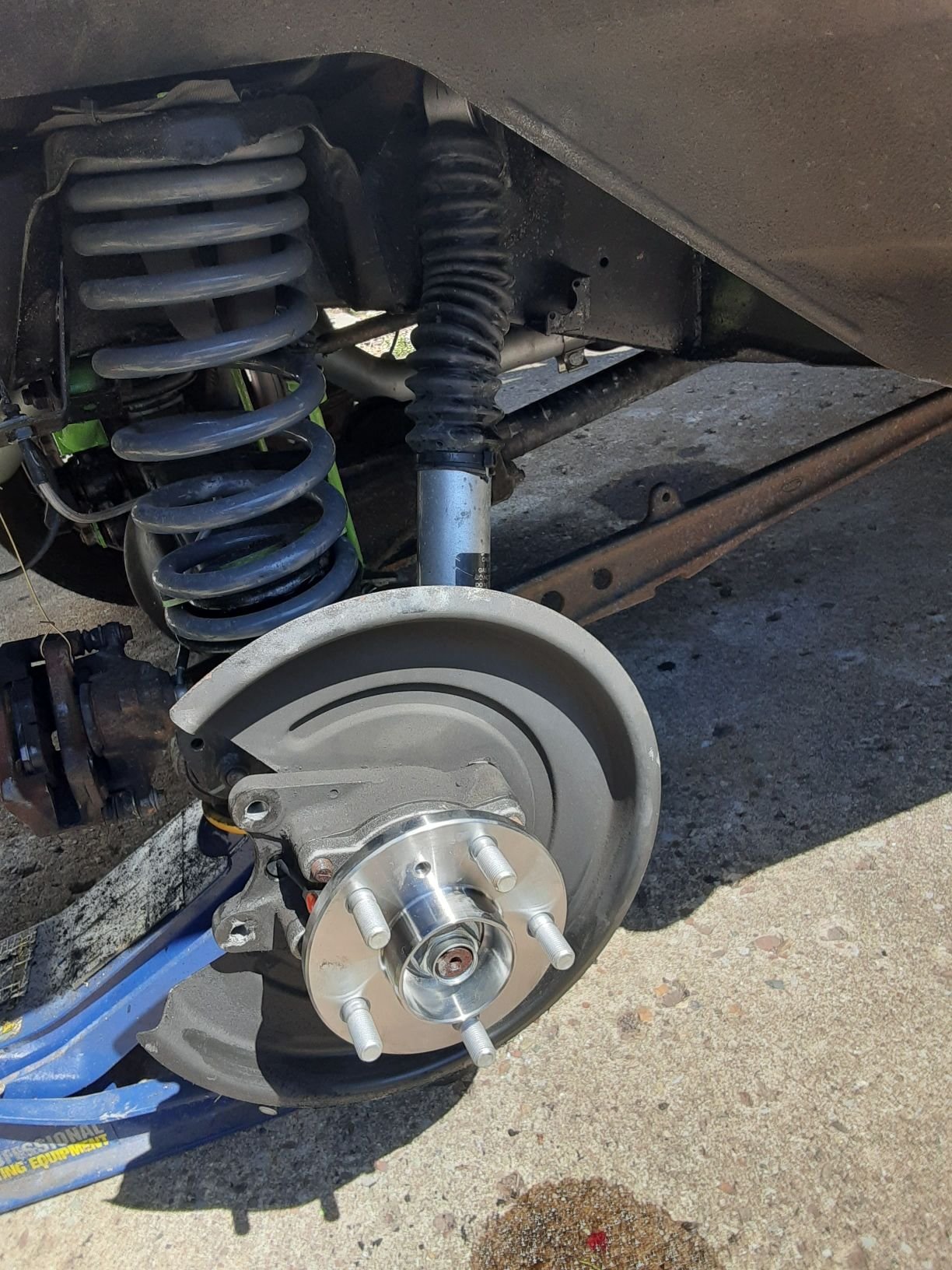

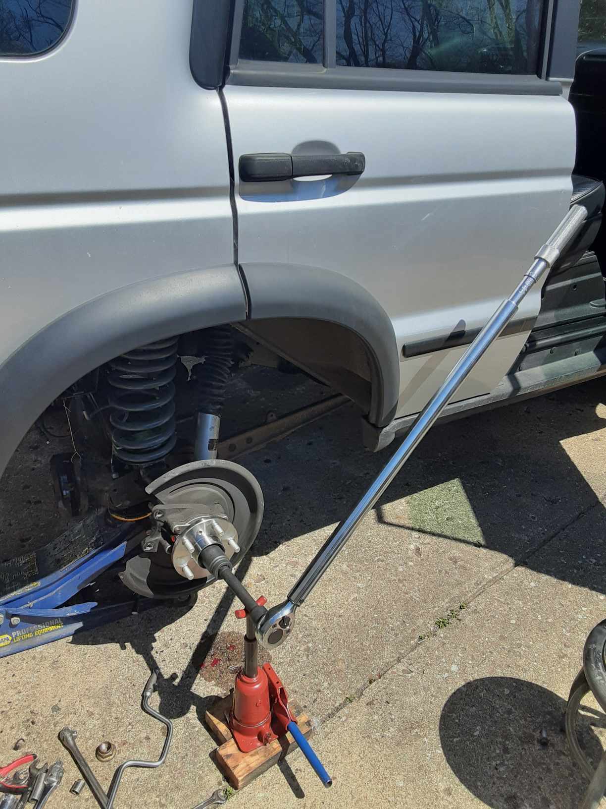

Nice day finally! Changed out rear hub. It was leaking from the bearing seal. Easy with right tools. 4 ft breaker bar and 4 ft torque wrench. Bottle jack does come in handy for something........
Also, changed out rear diff plastic fill plug to brass. It was over-tightened and nearly countersunk, and stripping with correct 21mm socket. So I used a Dremel to carefully remove the flange, releasing the pressure on the nut. then it came out easily.

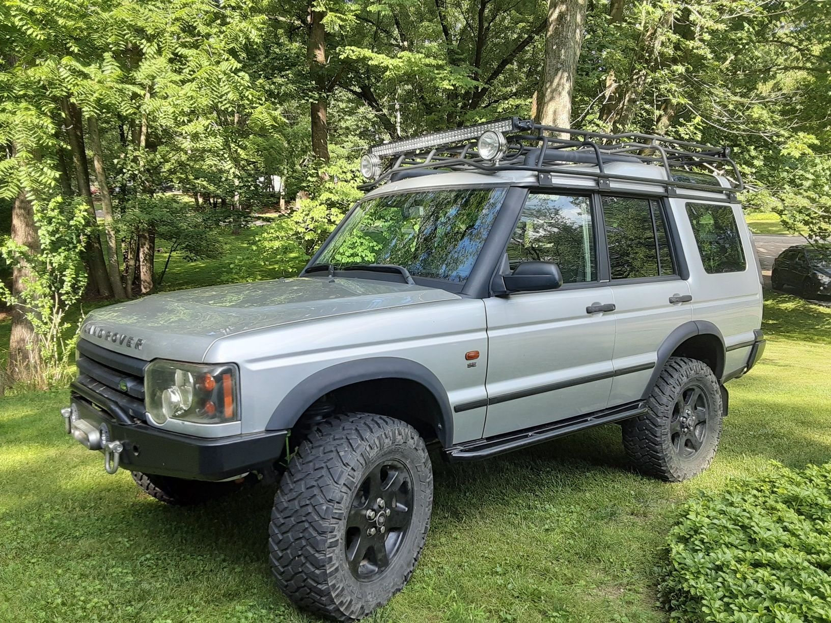

Finally getting somewhere....my son and I put on the sliders and the 6 degree rear radius links. Still have fronts to do......and driveshafts and tie rods and winch and.....etc...

installed 03-04 steering links with 'correct' taper on ball joints. new ball joints have lock nuts, not crown nuts (so you need a torx bit to hold them). installed front 6 degree radius links (Now my springs are square to their mounts). the new TF steering damper link mount was cheap sheet metal, so I used my old one. adjusted the steering knuckle stops so the tires do not hit the links. just a few more items then back on road...
edit: Here is a tip. if you are installing degree'd links, bolt the chassis link end bolt first. then use a jack to lift/align the link to the next bolt hole on the axle (which is the axle mount bolt closest to the long end of link). place the second bolt. then slowly drive the vehicle a few feet forward or back and step on brake to stop. this will rotate the axle and you can align the third link bolt hole (the one closest to the bumper) much more easily. Also, only replace ONE link at a time (if you are on the ground like me). replace both links with only two bolts on each side, then do the alignment trick.
