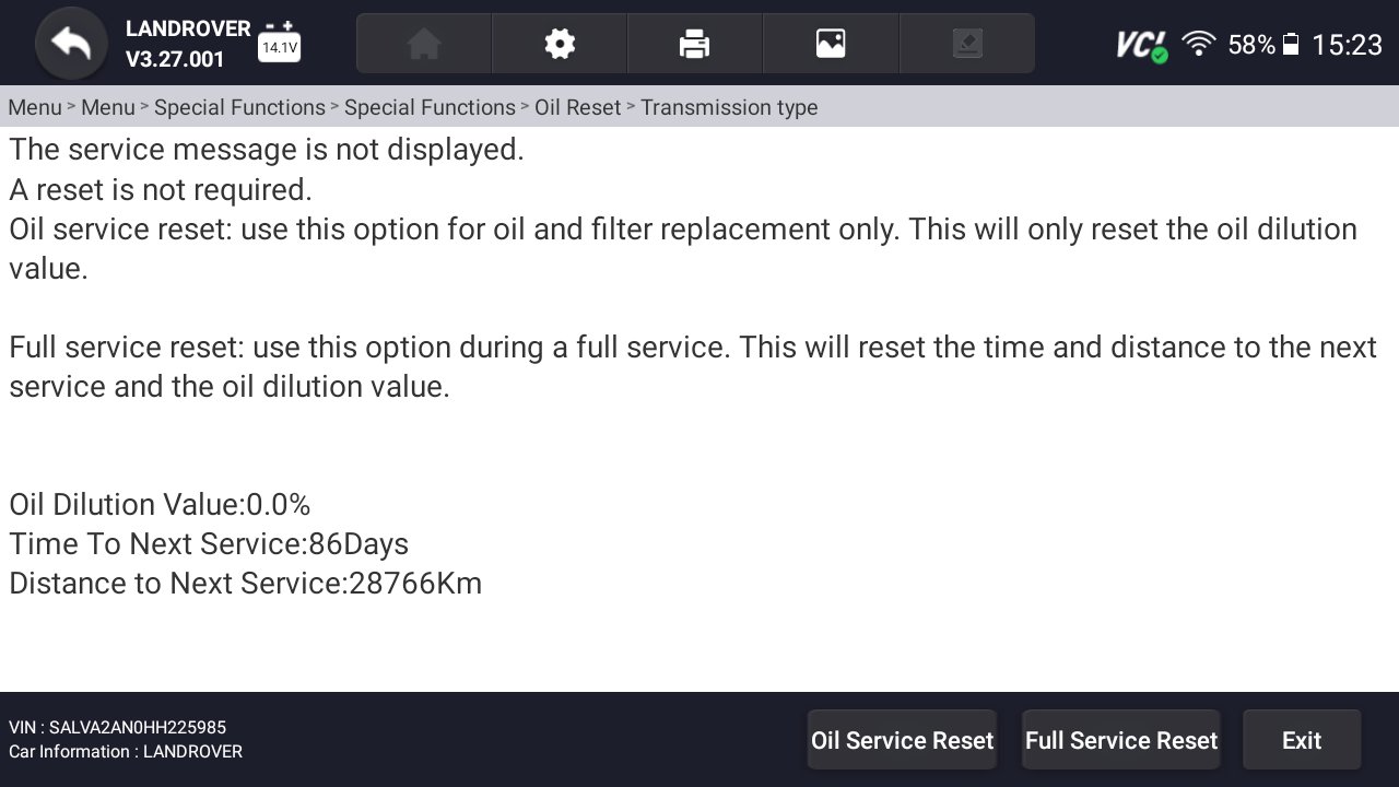

I have been looking at Foxwell Nt710 and it seems to be capable, it reset my Evoque
[img alt="Screenshot of me checking after an oil service reset
"]https://cimg0.ibsrv.net/gimg/landroverforums.com-vbulletin/1280x720/screenshot_20241212_152320_fd3ac698b396de8ef823b81 7b9f7d13b6a4064fe.png[/img]

Hmm My screenshot isnt showing for some reason, i did upload it.. ill try again here
