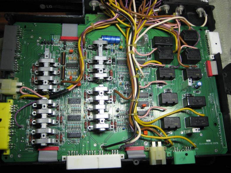

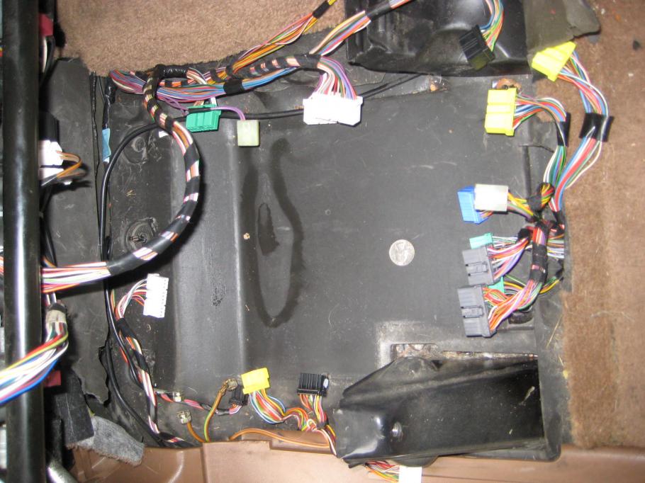

Yesterday I pulled the seat, removed the BeCM to check for water damage or corrosion but all boards looked dry and burn free, so back under the seat it went after cleaning the plugs and sockets with contact cleaner. My OBD scanner functions normal at the port when connected and there are no codes found.
