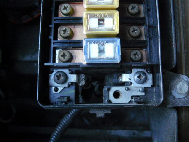

Can you advise on how to check the fuse box under the hood? Do the fuses just pulls straight out / up with plyers?
Thanks
Old Nov 28, 2012 | 08:55 PM
Posts: 16,322
From: Savannah Georgia
Mine do on a 97. There are also fuse links, which are bolted in.
Attached Thumbnails 95 Discovery won't turn over -- Please Help-fuse-box-pix.jpg
