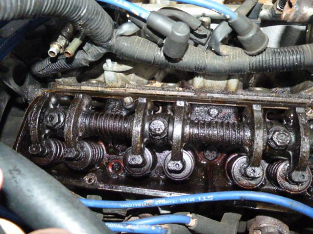

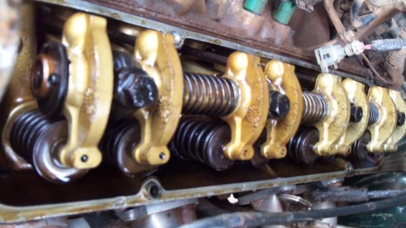

Here is a pix of two engines, both in the 185 - 190K range, one on a diet of Rotella or Castrol at 3,000 - 5,000 intervals. And mine that was not under previous ownership. Even use of a variety of snake oils and Rotella over two years was not enough to get rid of the gunk. I tried BG, Marvel Mystery Oil, ATF, GUNK.... so I must conclude that it would have looked a whole lot worse.
