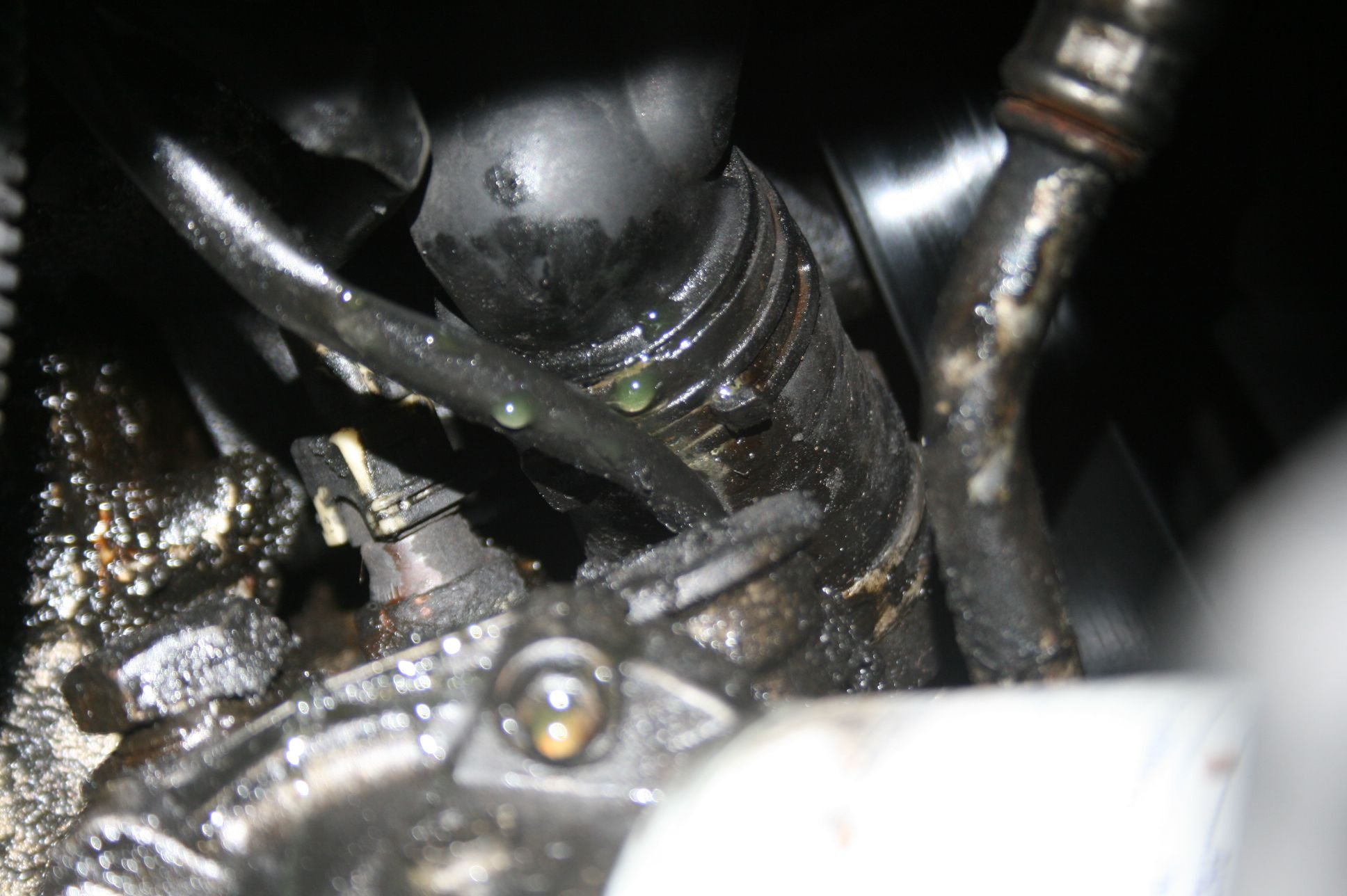

I have a picture of my disco 2 water pump. just had it replaced 2 weeks ago and it's looks like its leak from the shaft. Would someone look at this photo for me?
