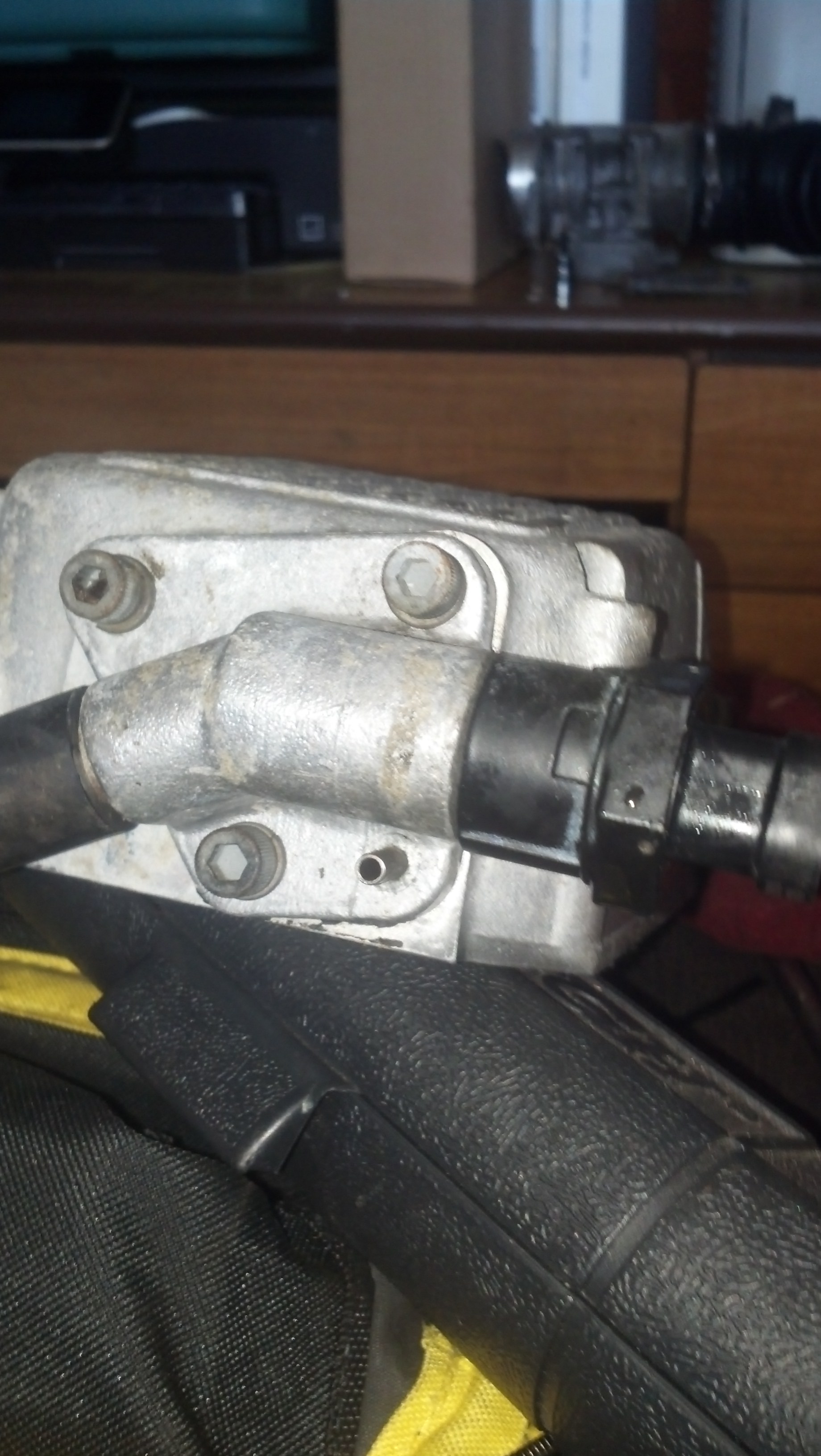

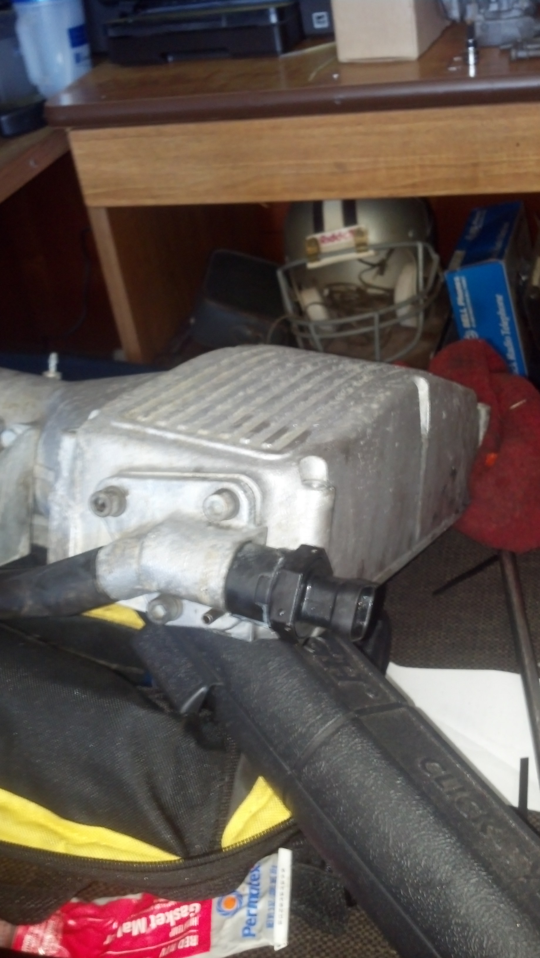

I just found this with nothing attached...I can't find it in the RAVE...help please...

That permatex is on the shelf in pep boys
Idk on that port my engine is different

Idle Air Control......

Oh i knew that it was IACV, I thought you wanted to know what that vacume line ran to

Acually I do need to know...I still can't find where it goes [vacuum]?...Nothing hanging or that I marked when I took the Plenum cover off...
