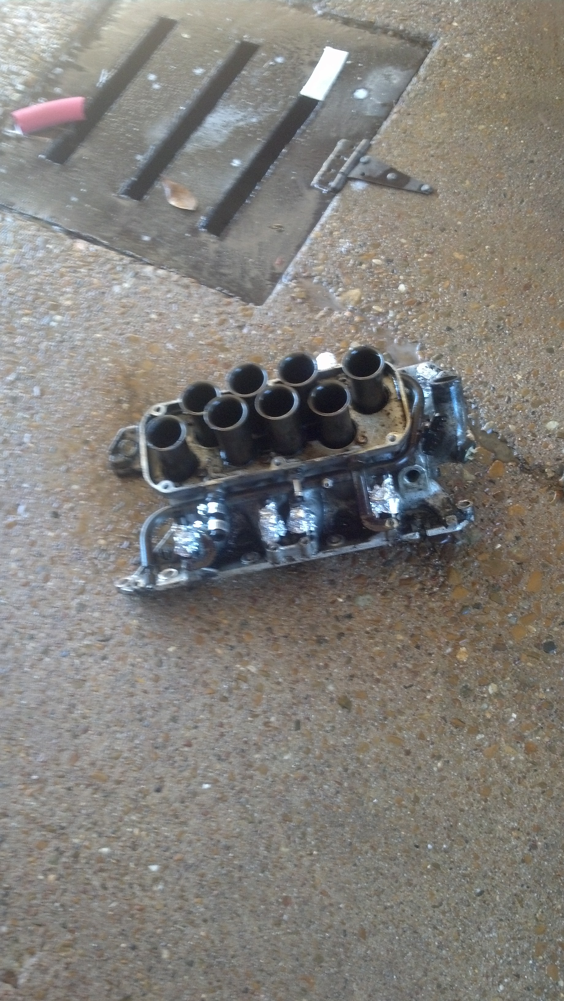

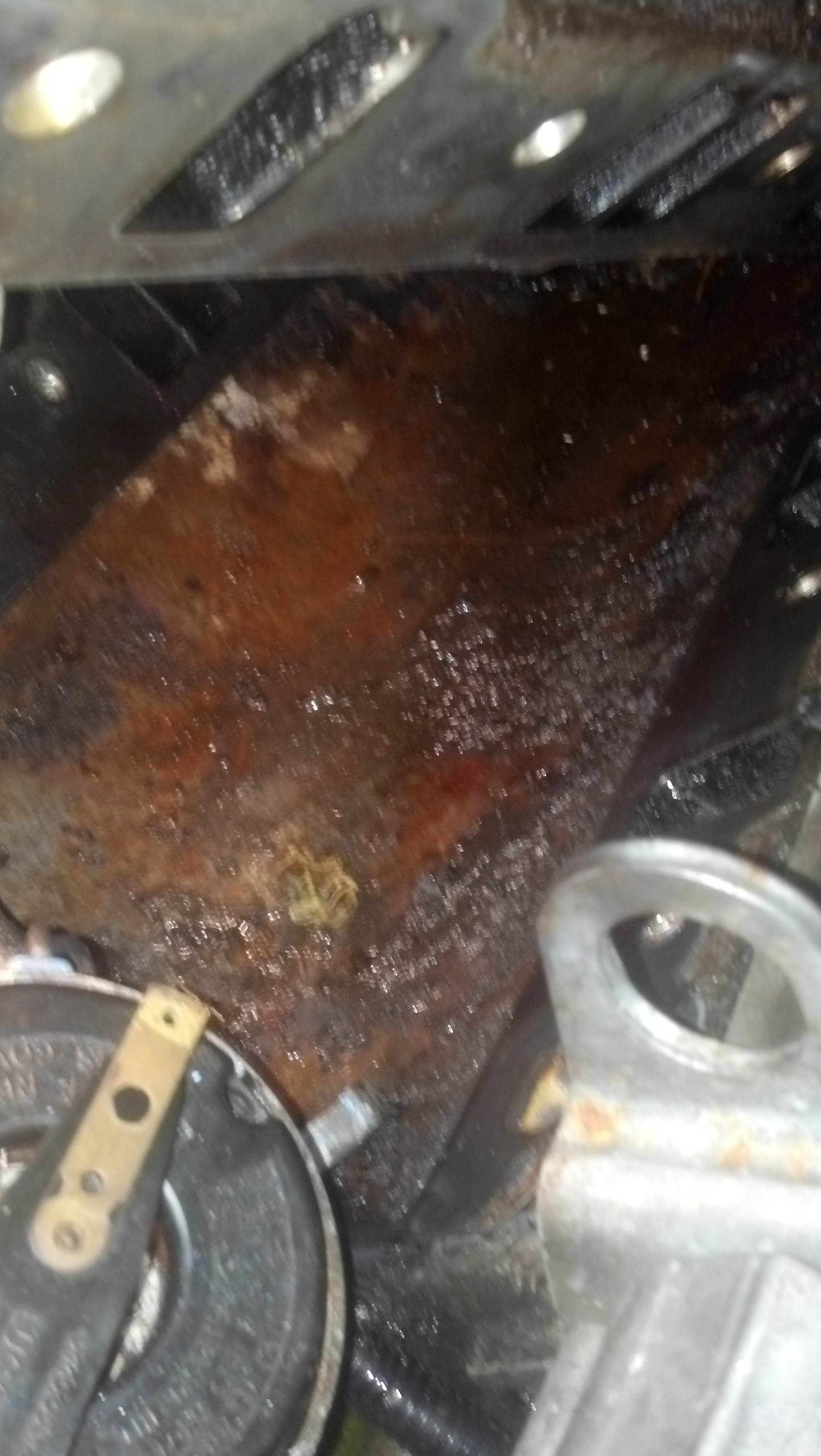

Not sure what your asking on the one piece question...here is the picture of the gasket with the intake assembly off of it. The gasket is all one piece.
"the upper to lower intake uses some special sealer, permatex sells it its in my build thread"
I didn't take the upper to lower apart. I did disconnect the injectors and take the entire assembly off to clean it and so I would be able to reposition it when reinstalling it. (For the second time )
Thanks for reinforcing the dry time...

The plenum uses special sealer when u bolt back onto the intake, it a goo that does not harden best I can telltell
By all one piece I was referring to the valley cover and 2 intake gaskets are all 1 piece on my 98
