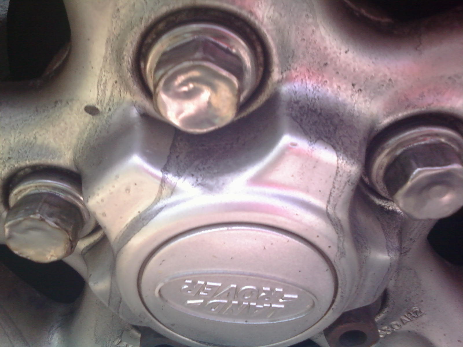

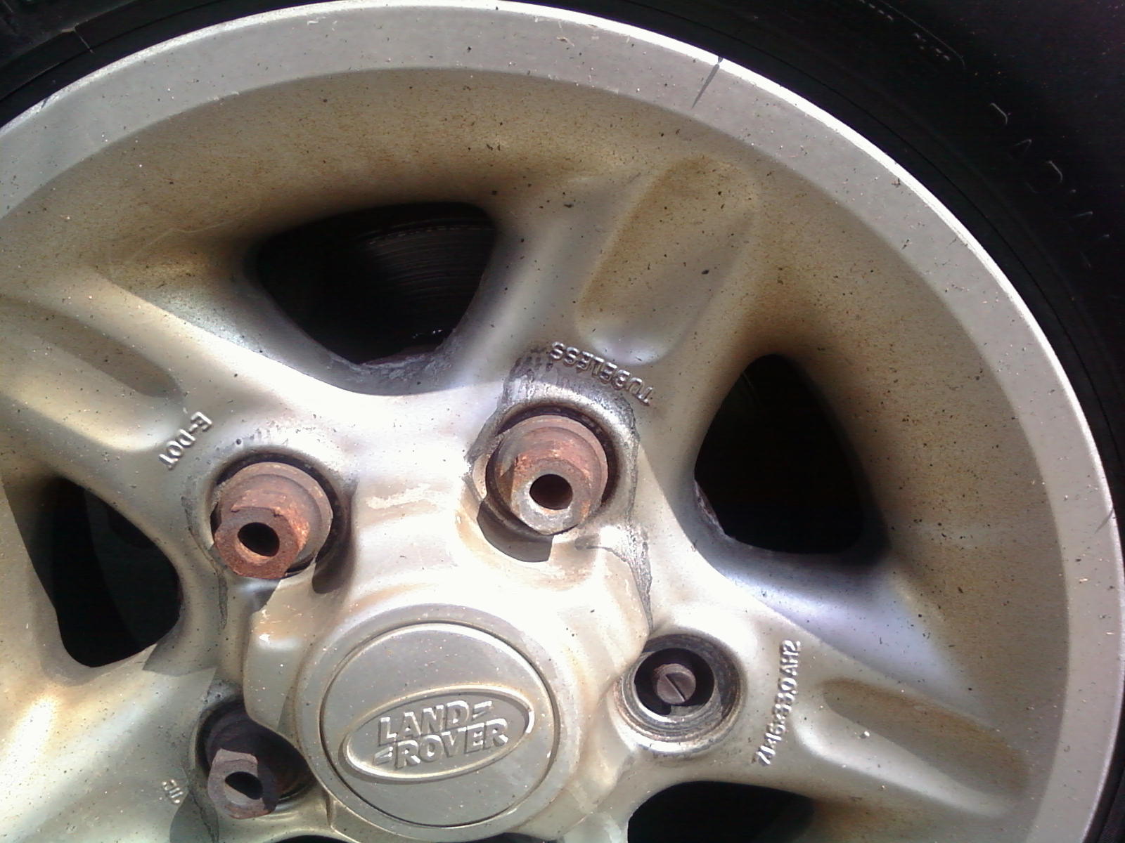

Took truck to large company for Cooper tires. 1 1/2 hours after I saw them put my truck on lift they call me and say they don't have tool to remove silver covers off the lug nuts. They said they could cut them off. I came to look at truck situation and they said my passenger side wheel bearing needed replacing so they thought I should have that fixed first. They did not want to put tires on before because it would over heat and not be good for tires. They don't have part so said it should done elsewhere. At the end as an aside statement they said the lug nuts were rusted on and that it will be hard to remove. I did not notice the lug nut off until I was home 15 miles later.
So I did not get sale price for holiday sale and I decided to go to a small shop near me that I was not to sure about. He said he could get same tires at the other shops price (see below) and charge me $225.00 for the wheel bearing with all labor costs and taxes included. So 875.00 total. Fair price? I am a female with too little knowledge. Love the Rover. Male friend who may not be right said to put LOCK EASE on the lug nuts so it would be easier for them to remove wheels.

It looks like you have a DII maybe?
What was the diagnosis for the reason you need a new hub?
$225 is good good for a new hub + installation.
You should probably get new lug nuts to replace the damaged ones. Or remove the metal caps from the ones that still have them.

That's a D1 wheel and I'll bet they had a great time. I can see they don't know squat, probably don't have an impact socket to fit the lugs either. Yeah, that's a fair price for tires and hub bearings, go with the second place for sure.

Ah, I thought it looked like a D1 wheel, but the center cap looked too small to me.
