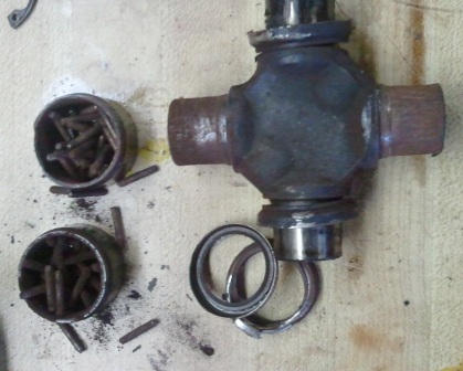

Default Front Propshaft rebuild success!
Antman/Antichrist,
Thank you both for all of your efforts in documenting the procedure, I spent yesterday rebuilding the front prop shaft and had zero issues when following your procedure. (Ok, I did have one issue due to my lack of attention - didnt realign the shaft properly and found it as apparantly a roller pin fell causing the last cap to not seat. After much effort I got the offending Ujoint out, replaced with another new one (I had to beat the bejeezus out of it to get it out), and realigned properly.
Also, thanks to DiscoMike and yourselves for insisting this be one of the first and foremost high mileage service points! Upon removing the forward most U-Joint, I discovered it was totally dry, and rusting to the point where the pins were mis-shapen. (Pic attached)
I suspect that due to your advice you have saved me one major headache (and a new transmission)!
So for others thinking "meh" its working, if you do not have the greasable Ujoints in your front prop shaft, heed the advice these guys give, its well worth it!
