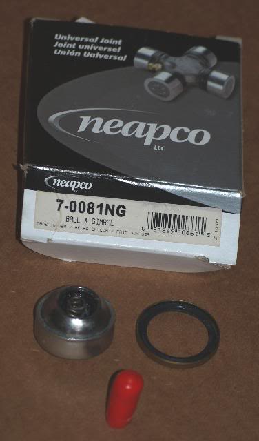

I tackled the front driveshaft rebuild yesterday. I had no problem replacing the U-Joints (which were literally made out of rust, glad I am doing this.) However, I cannot find the centering yoke ANYWHERE (replacement purchase I mean). I found P/N 7-0081NG through Advanced Auto, but when I opened the box, the components are already inserted into a bolt on yoke. Does anyone know where to get just the centering yoke bearing, seal and spring?
Sounds like they shipped the wrong part.
This is what it looks like (this is one I got at the local Advance Auto):
NAPA, O'Reilly, etc carry the Precision version.
