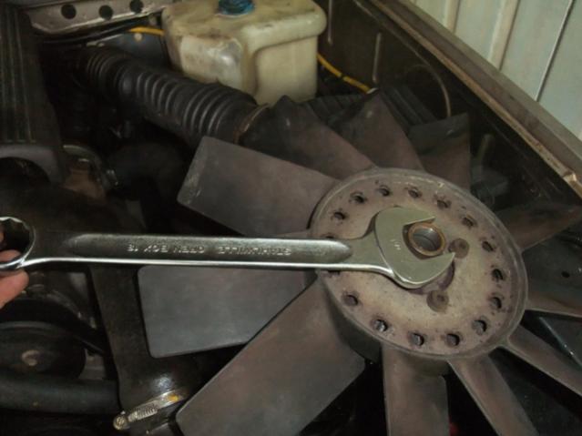

Few tips for pump body o-ring cx:
1. For discovery bolts holding body some are torx 30 and others 5 mm allen.
2.Fitted dial gauge with an old sun visor rod to ensure pump is on stroke, eg spring inside at max compression (opposite of normal timing)
3. ONly bring pump body back enough to change o ring, eg no more than 1/4 inch,
also use vaseline or similar lubricant before pushing body back together
4. Bracket on engine side only has a very small clearance to slide o ring past,
i managed to do this but would suggest removing inner bracket from pump
and now......
I have to reseal pump front seal, which I will do in situ of course
regards
OZ
