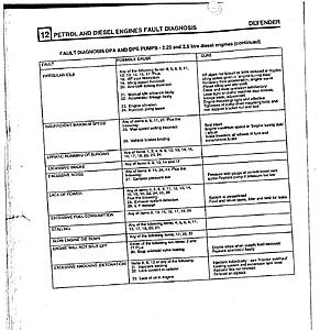

Old Mar 11, 2018 | 04:48 AM
raid13's Avatar
Joined: May 2007
Posts: 314
Likes: 9
From: North Carolina
try replacing the stop solenoid valve on the injection pump, when the solenoid gets old fuel will still bypass when its off.
Attached Thumbnails Tdi300 starts but engine keeps running even after ignition is turned off. what to do?-capture.jpg
