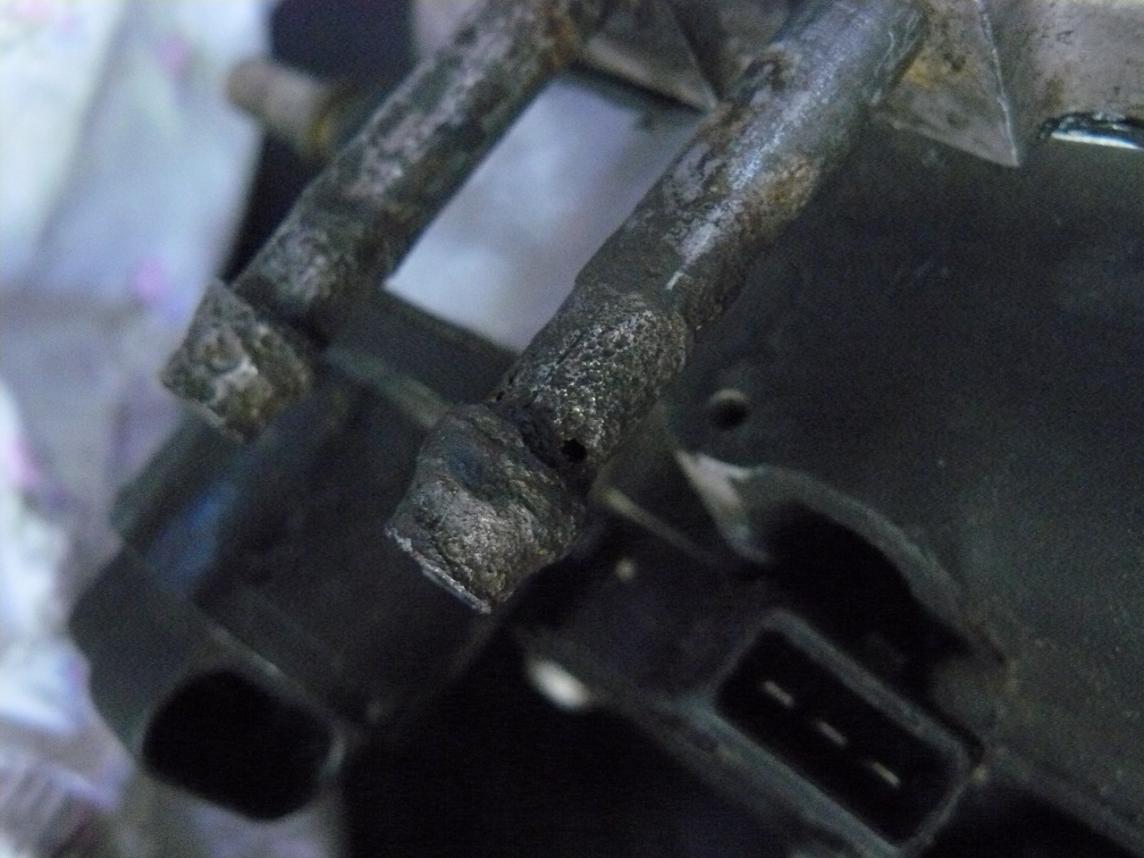

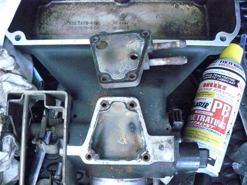

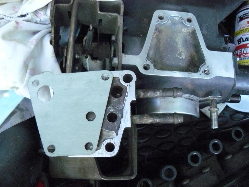

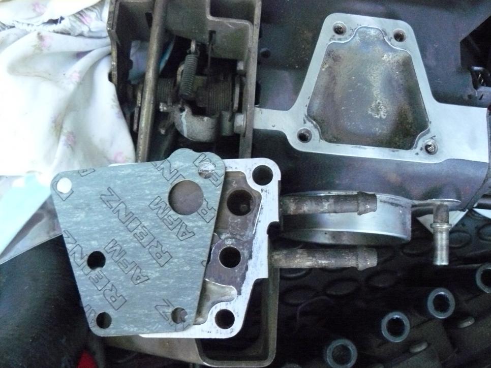

Pix of TBH on my D1 currently being tinkered with for head gaskets. You'll note that the heater cavity circulates coolant to warm the bottom of the throttle body, which prevents ice up of the butterfly valve. Has no easily measured value for mpg, etc. It is possible to put the gasket on backwards, this might not be easily seen without a mirror if doing the repair with throttle body still attached to intake.
If reversed, there would not be good flow. Of course, after cleanup, new gasket, I blew thru the hose port to be sure, and was rewarded with a whistle from the new leak.....
Pix of old, new correct line up, wrong line up, and leak. Time for new parts.
