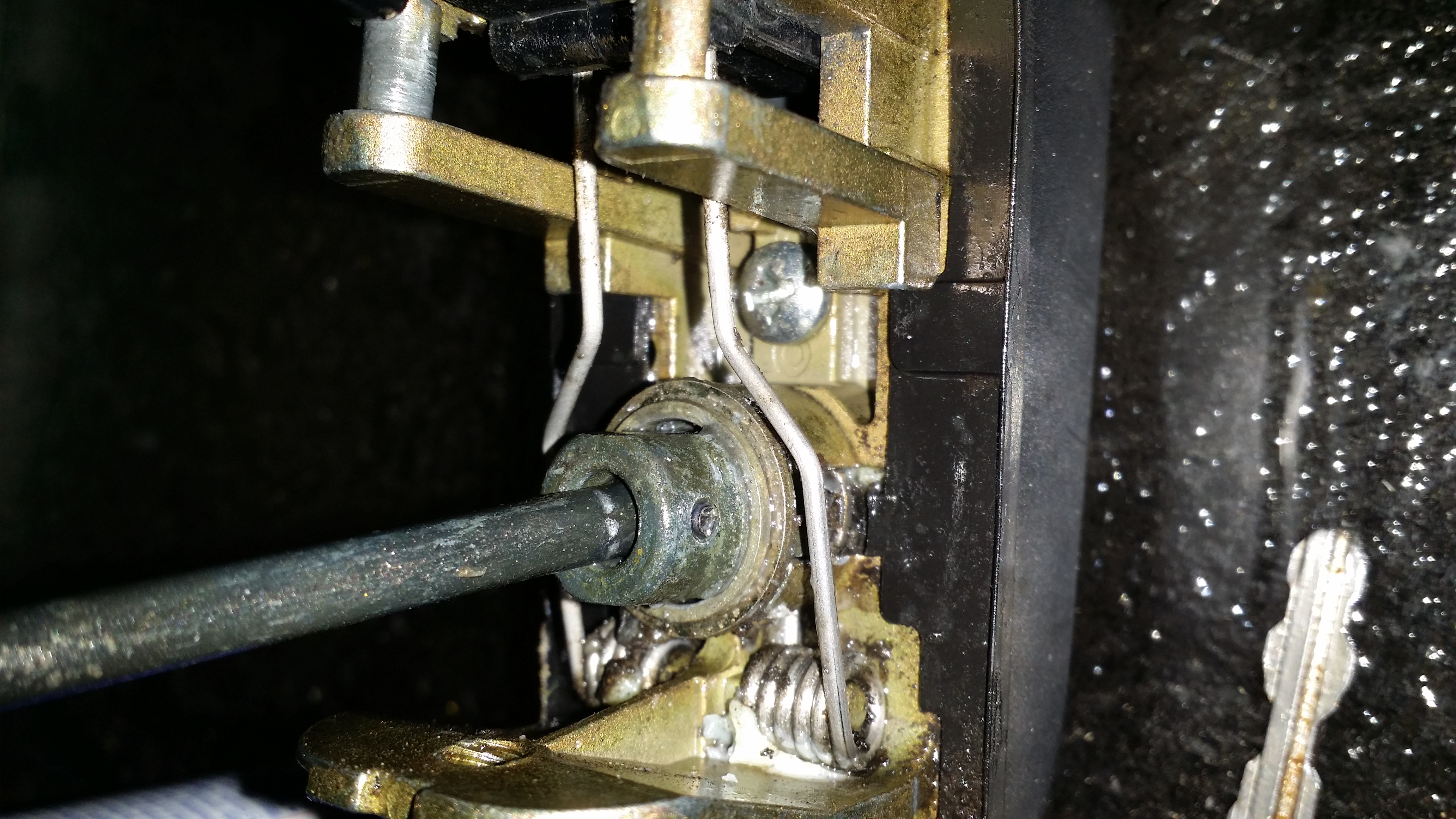

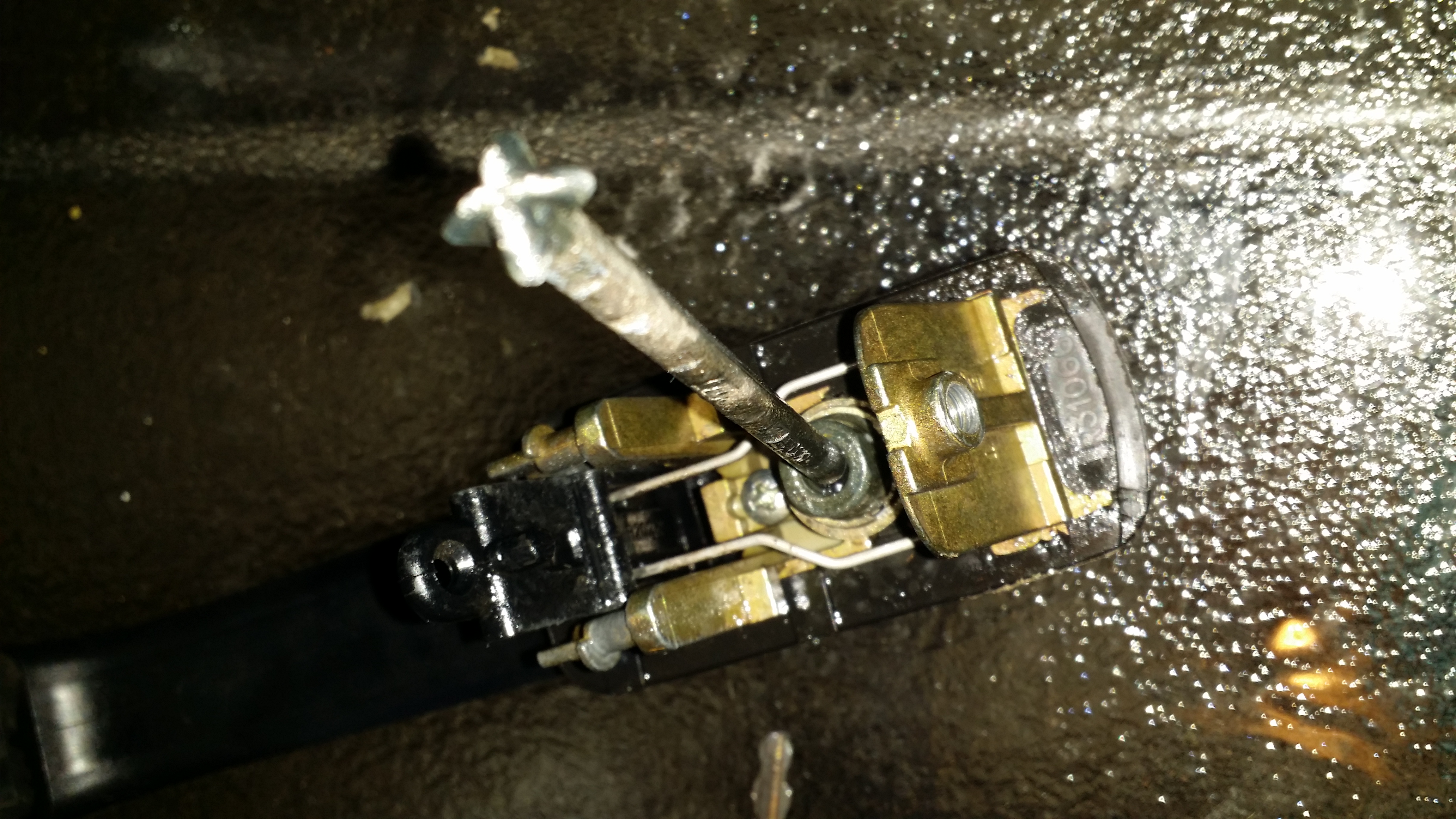

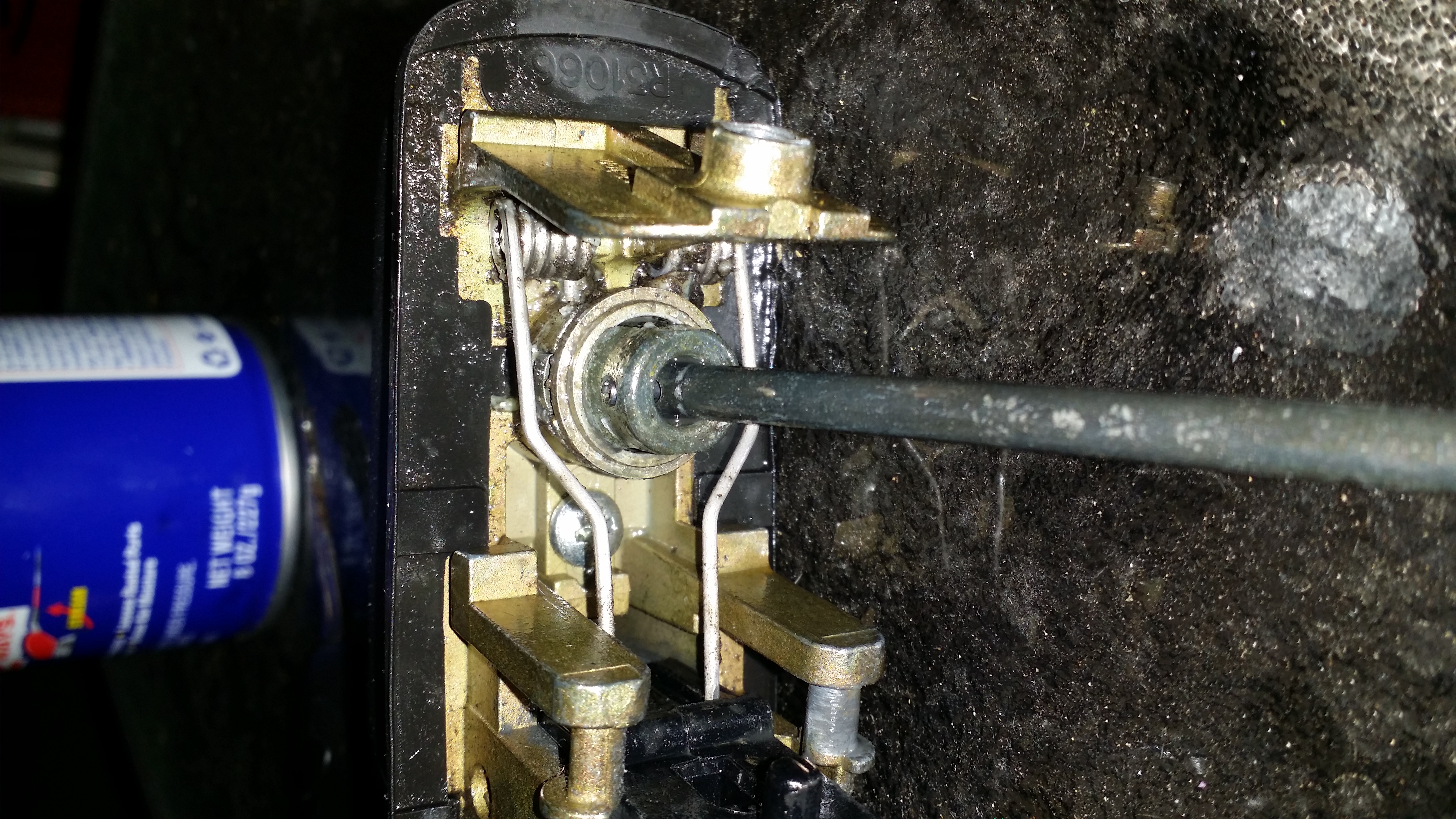

I am having some problems with my disco2 (never ending story) and I couldnt find a solution to one of them. I would really appreciate if yall can help me out.
I have a disco2 and the drivers door lock actuator wasnt working so I replaced it. I put everything back into place and put the key in to lock/unlock but it doesnt turn left/right at all! I took the part out to take a look at it but I dont see anything weird (actually I have no idea about how it suppose to look anyway ).I tried to clean it and used a ton of wd40 but it didnt help at all.
What should be my next move?
Thank yall in advance!

Can you turn the key with the door handle removed? If so:
Is the "Mace" end inserted into the white cross hair section on the door lock actuator when you put it in?

No, key doesnt turn even when the handle is seperated from the car.
what is white cross hair? ))

It's the plastic "female " receiver for the door lock pin.
Did the lock move with the key prior to changing out the actuator? If not, maybe you have a mismatched set of ignition and door lock?
That's all I got, I'm stumped on the no turning. You will have to disassemble I guess. Have you tried flipping the key? The pins/wafers in the lock only read one side of the key.
