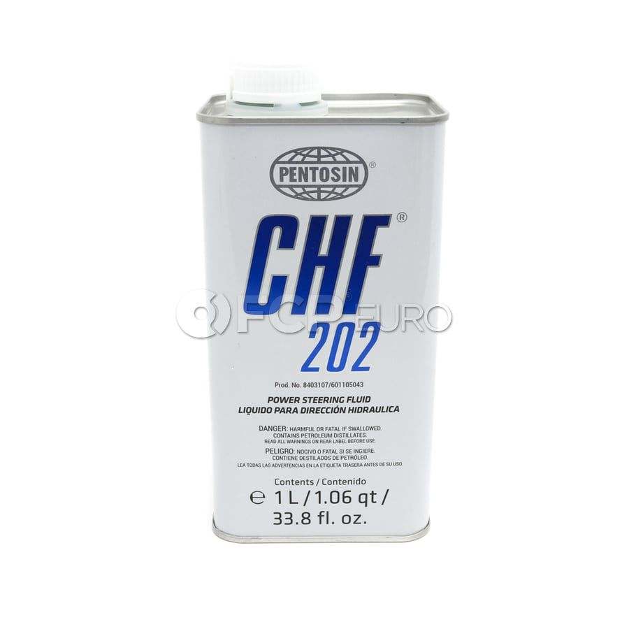

This is what is specified for the 2008 LR2, and what I've used for system flushes over the years. I don't know if the EHF is the same spec.
Amazon Amazon
