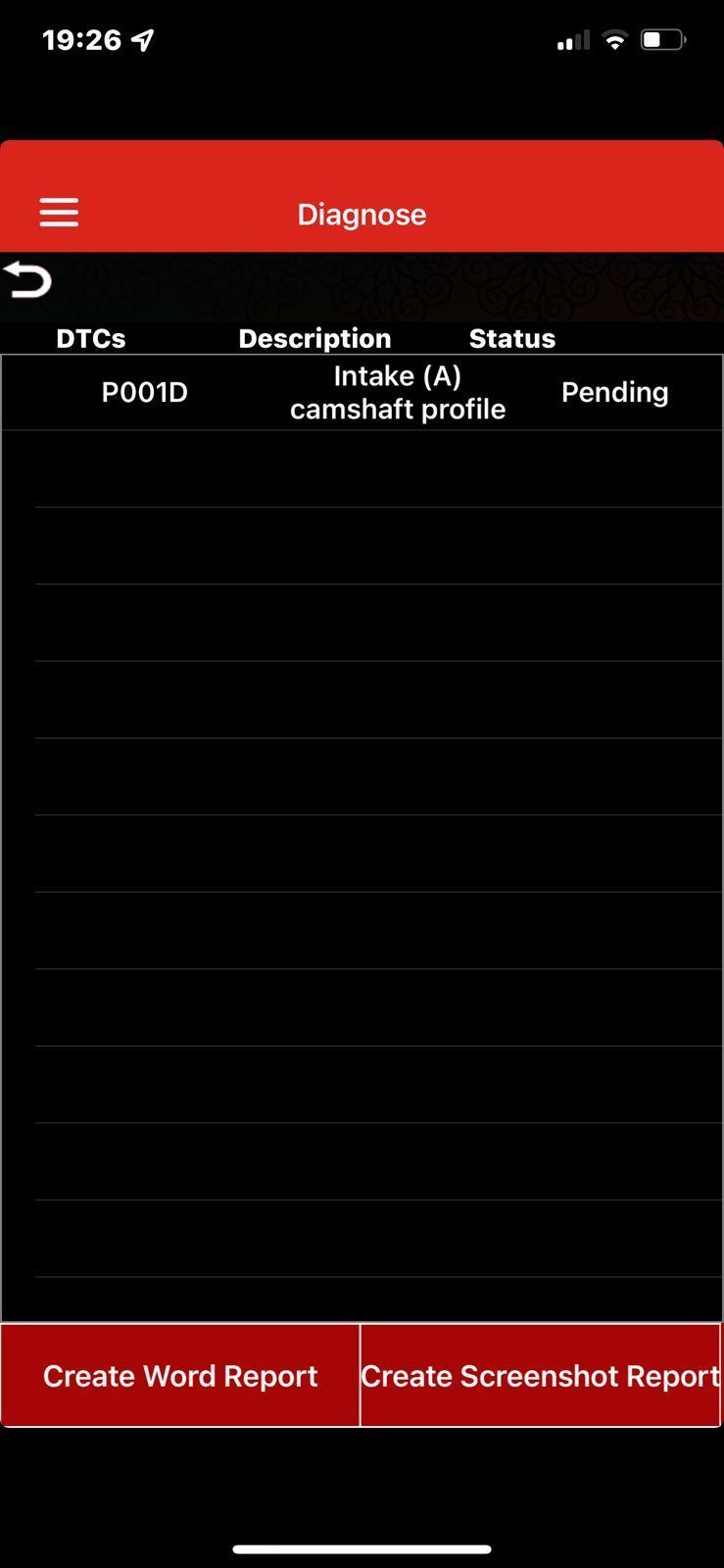

I replaced my fuel pressure sensor with my friend's Volvo aaaaand, nothing changed.
But, the launch scanner read an error: P001D. Now, time to research.

Possible causes:
Camshaft profile control circuit: open circuit
Camshaft profile control circuit: short circuit to ground
Camshaft profile actuator fault
Action:
Check the camshaft profile actuator and circuits. Refer to the electrical guides. Rectify as necessary
I cannot find the location of a camshaft profile actuator but there is a solenoid, located at the top of the engine.
