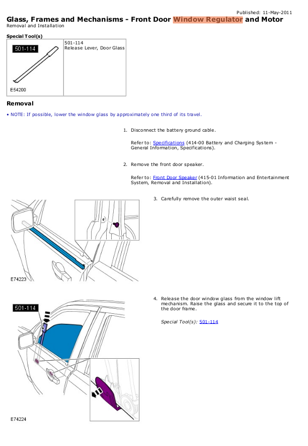

I have a 2010 LR2 that needs a new widow regulator. Took of door panel and unable to reach second clip on glass to remove glass to install new regulator.
White plastic clip is not accessible need special tool were can i get one. Only access is through speaker. This is a horrible setup.

Instructions and special tool to raise and hold the glass:

Thanks, I was looking for the door glass release lever but was unable to find. Found part #501-114 as asking mechanic to give me part # at Land Rover.
I had to buy it Europe would not sell here.
