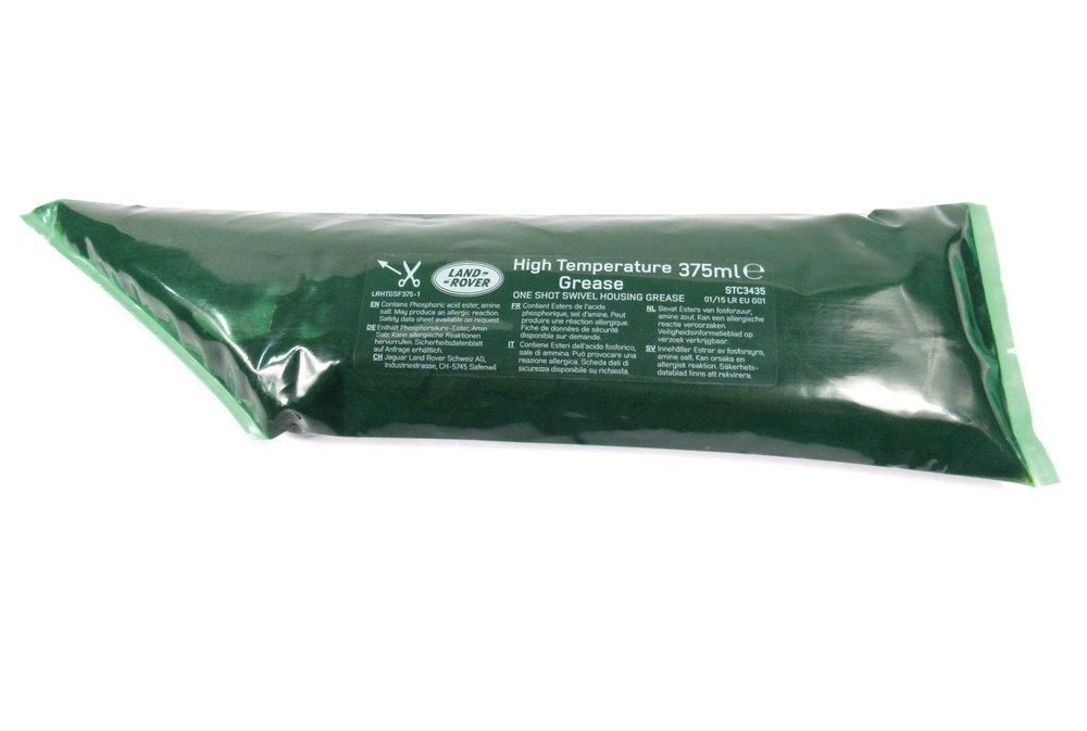

The grease appears to be the same, the kits are supposed to include two packages of grease, 375cc each. It's Nicrotec grease, the LR part number is STC3435.

Thanks for this additional detail. The genuine LR boot kit is LR003160. But I could not determine anything from the OEM listing about the grease included.
