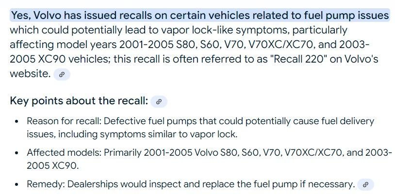

Next, the only Volvo recall that responded to a vapor lock issue was for 2001-2005 model cars. Check your dusty calendar and you will see that was long before the LR2 was introduced.
The effect of a damaged or malfunctioning purge valve is the same symptom, but not the same root cause (look those up on Google if it confuses you). A malfunctioning purge valve will cause a problem with engine starts because its job is to purge fuel vapor from the EVAP canister. Hence the vapor lock issue when it fails. That is why replacing the valve in my car fixed the problem without having to replace the fuel pump, which is what Recall 220 required dealers to do.

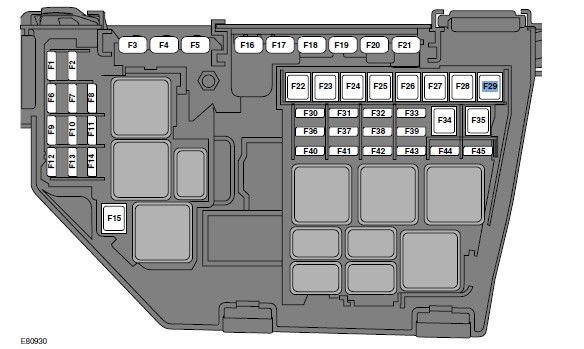

FWIW, fuse F29 is shown in the manual for my 2008, there is a slot for it in the fuse block but it's not installed. I have an SE, not sure if HSE accessories might use F29?
Entirely plausible that somebody wired up that slot for an aftermarket accessory. Although in many cases it's easier to just add an inline fuse and tap whatever hot makes sense (battery hot or ignition switched as needed). Depends on how easy it is to access the backside of the fuse block.
Also possible that somebody did a lazy and connected an accessory which *should* be switched with the ignition instead to a battery hot, creating this kind of issue.

If you look above you will see that someone on this forum posted some recall information from Volvo which only affects vehicles from before Volvo was making the 3.2 Si6 that is in our LR2.

Ah. Looks like LR used the F29 designation in both fuse boxes then.
I have an empty slot labelled F29 in the box under the hood.
The fuse box under my glovebox ends at F28. Entirely plausible to me that additional OEM inline fuses in that area could be labelled F29, F30, etc.
