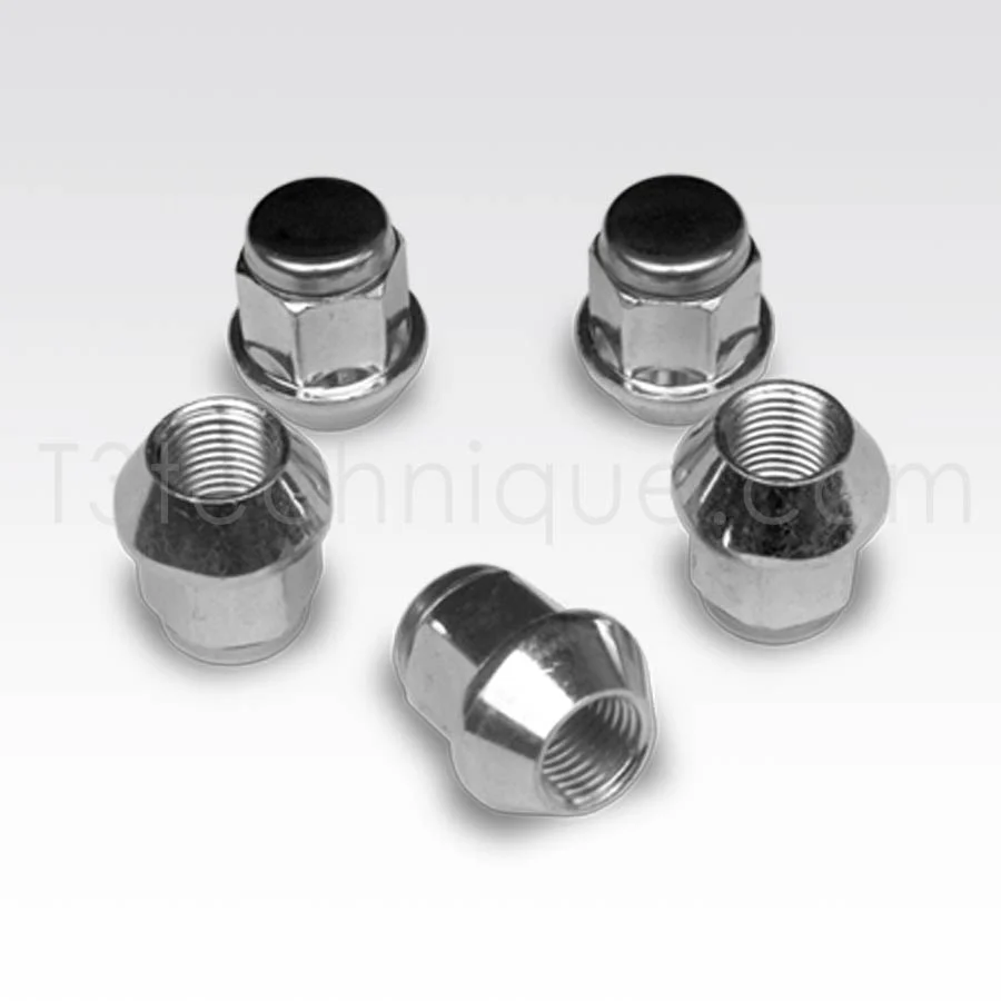

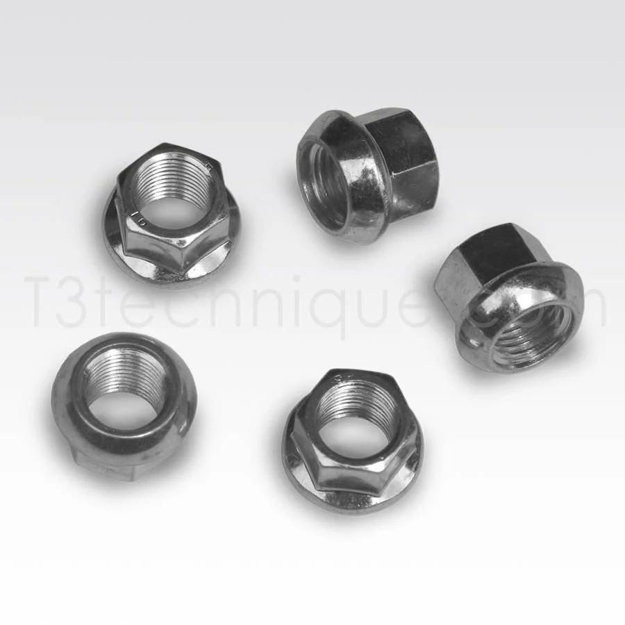

Hello
I want to change current close end lugnuts to old school open end lugnuts. What size lug nits do I have to order? According to my search I'm seeing a result of M14x1.50. Is this correct?
Thank you
From
To this

14 mm x 1.50 thread size, 7/8" hex, 1.78" length
