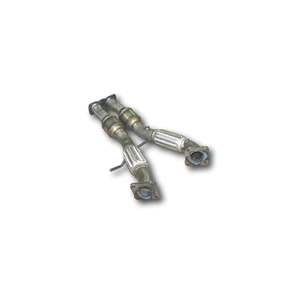

I've got a leak somewhere in one of the flexipipes between the front and rear catalytic converters. There are no codes at the moment, just noise. Can flexipipe be replaced, repaired or patched, or should I replace the entire assembly?

If you need to replace one of these (don't bother looking at YouTube videos on how to fix flexible pipes, it won't work on the LR2) the best place I found is this one:
https://mufflerexpress.com/products/...ytic-converter
Quick shipping, excellent customer service and the price is about 1/3 of what you will pay on eBay and 1/5th of the dealer price. Note that if you buy this you will need your own rear gasket, bolts and nuts. If the front gaskets cannot be reused you'll need those too, but those run about $200 for a pair.
