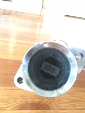

Ok, so I went ahead and ordered the WCD502470...and it's different than the one I have on their currently and shown in the parts diagram. Instead of the rear O2 sensor being after the converter, it's mid-way through. Everything I look up says it should fit a 2008, but why on earth is the O2 placement different? Should I even try to fit it?
Also, there is a sticker inside on the cat material. I'm assuming that just burns off?
Sticker on the inside of the cat?
Why is the O2 bung midway through the cat?

The new one is the way my 07 cat looks like

They changed the bung placement in 07'. You are good to go.

So just for anyone looking at this in the future, WCD502470 fit fine and was the correct part. *whew*
