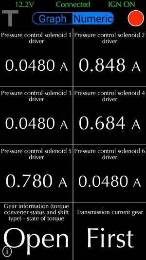

got the transmission back in and hooked up. Filled it with fluid, it took about 9qts. I put it in reverse (to back down the ramps) and .... nothing. It is behaving exactly the same way that it was before the rebuild. I can not confirm that it will move if I rev it up, because i don't want to damage any of the new parts. So the question is, what is causing this lack of power/torque? Could the solenoids cause it? Beyond that the only thing I can think is that the oil pump is not functioning properly, or the o-rings that I could not get to inside the clutches are bad5280LR3 you mentioned that you could tell your solenoids were bad using the gap tool. What values should I be looking at and seeing? I've attached two logs where I slowly cycle from P>R>N>D>DS>1>2>3. One is the solenoid amps(?) and the other is the on/off for the solenoids.
I am slightly skeptical that the solenoids could cause this, but I need to look at all the possibilities.
Any other thoughts?

Here are my amperages. Sorry, I don't have graph info... too hard to see while driving. If you switch to numeric view you can watch the amperages change while the trans is shifting. The first image where solenoid 1 is at 0.0480 is in park with the engine running. The second image where it starts where solenoid 1 is at 0.848 is in drive (standard mode) engine running foot on the brake (static). See how your numbers compare to these. Please compare all the amperages as they work in coordination. Start here and see what you have.

your amperages are essentially identical to mine at those two conditions. I don't know that this rules the solenoids out from being an issue however. It just confirms that the TCM is doing what it is supposed to. What were the symptoms that you were seeing when you needed to replace the solenoids?
