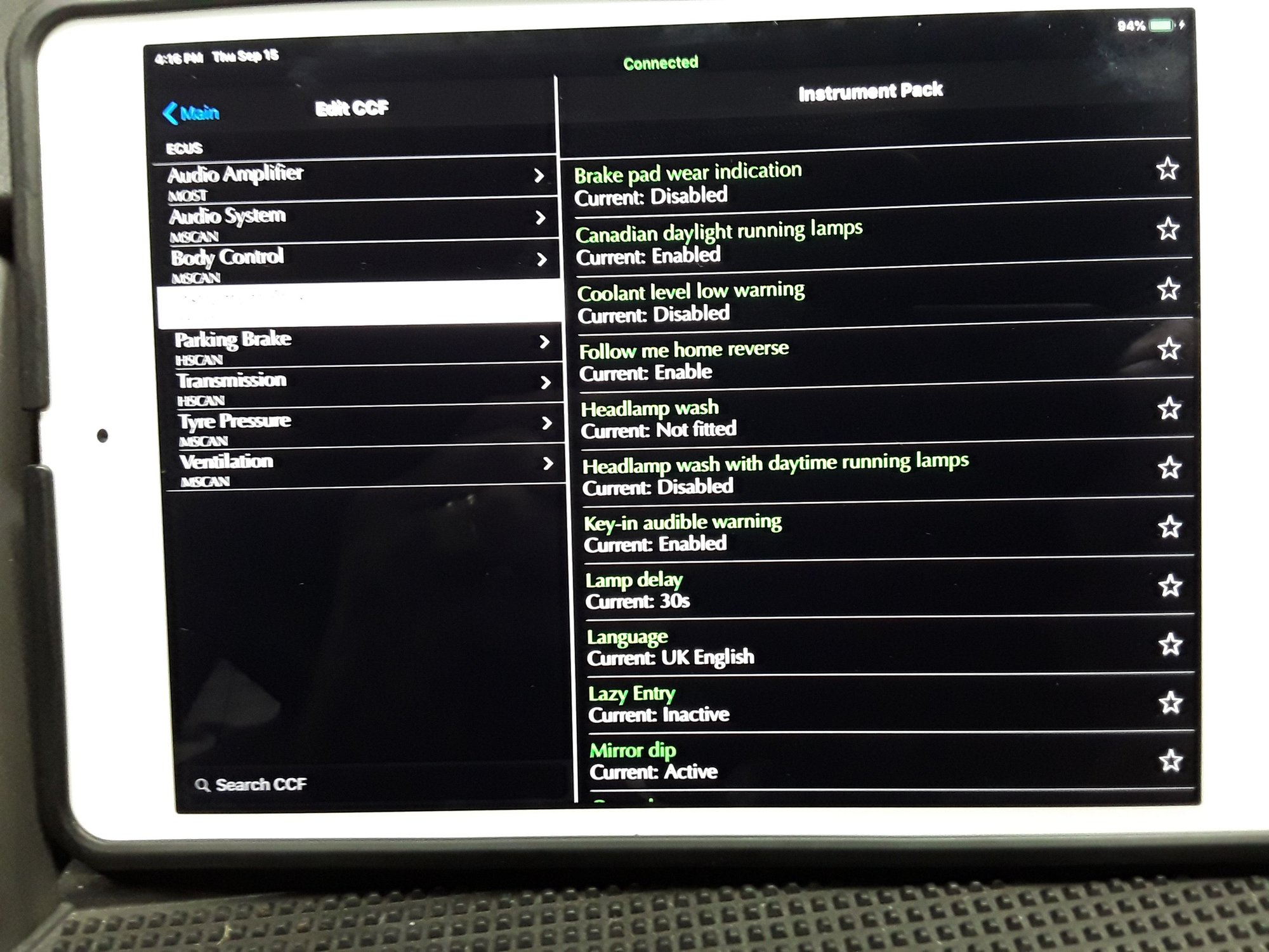

2007 LR3 with the pad wear warning light "ON" and have used my IIDTool to remove that option from service, pads are not worn and the wiring is new, but the light is still on. Anyone know if this is an instrument panel problem? As I understand it there is no current flowing when normal but the circuit grounds and the instrument panel amber lights when the contacts wear down at the rotor...
Pad wear indicator on and engine running
IIDTool Instrument Cluster
if the pads get too close to replacement time. Any ideas are welcome...

Just because you can change a setting, does not mean it will function that way. I am not sure it can be disabled for sure because I believe, like the oil pressure sensor, it's direct to cluster. No computer sits between so it is more like an old fashioned dummy light than anything. So the cluster itself can see the "fault" and give a message, but no faults stored in the ECU. FYI, the way the sensors work is the front and rear are in series and current does flow through them. When a sensor is worn the circuit goes open and that triggers the light. In fact, if you look at the wiring diagram its from cluster through each sensor then to ground. What I have noticed though it because the sensors are part of a simple circuit, they can sometimes cut in and out as they ground out on the rotor and the light may go out during braking. I will also add that the pad wear indicator is a backup to the parking brake system. If you have disabled the parking brake in any way, the brake pad wear light will always be on even with a known good sensor set in the pads.

Thanks, I have ruminated over this for some time and it can certainly work the opposite of what I thought, current flowing and open instead of a ground. The thing is, should I open up the instrument cluster to try and fix it or am I better off just replacing? I'm thinking fixing might be easier and cheaper but then again I'm not sure of what's in the cluster and can't seem to find any internal diagrams...???
