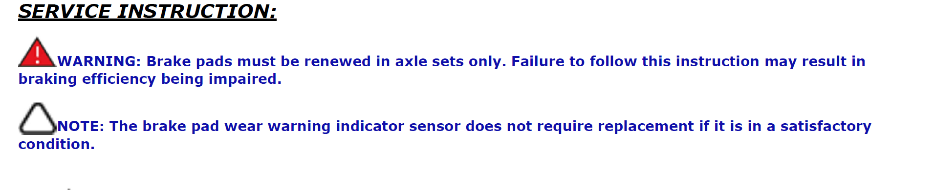

When we sell a brake job, we always quote a new sensor and we always replace the sensor. People often drive them until the light comes on (rendering them useless) or they have been in use for so long, the years of thermal cycling makes them very brittle and fall apart during removal.
If you have not worn through yours and it didn't crack or fall apart during removal, then there is absolutely no reason to replace it. In fact, Land Rover recommended in a TSB for brake noise, to re-use the sensor if in good condition (see picture).
