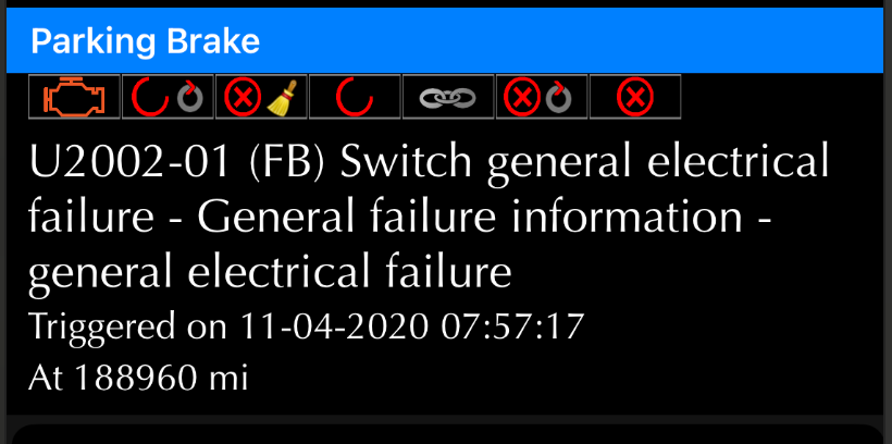

Yeah it's a smaller diameter pvc tube inside the larger roof drain hose. I've got everything still apart right now, Fixed the Green / Green White and Red / Red Red wiring splice breaks in the passenger channel. Leaving the loom propped up for this series of thunderstorms that are about to come through, just to make sure the tubing that is there will not leak and put me back in the same situation that I am working on getting myself out of.
Fixing the two sets of wires should give me the ability to use my key fob, which I've never had and should stop the random HDC Fault, Transmission Fault, Suspension lowering so I am pretty happy if that all works out.
I've just got one outstanding issue that I am hoping may be in the same area as long as the tubes don't leak and that is a Parking Brake Failure.
You can do a full clear and it comes back immediately. Didn't happen until I had all this water pour in. Any idea? If I do have water in the channel over the next day or so I will just commit and pull all the trim down and put new tubes in all around because I'm sure if it was done on one side... it was likely done all over. This was someone's project before it got to me.

I would swap the actual switch. They are problematic. Maybe you can take it apart to clean any corrosion.....never tried.

Yes. The switch itself. If the switch is not installed, you will get a fault too.

So I actually have some good news, I've got the Brake Switch showing up now as seen in my print out below. No more Parking Brake Failure.
And my key fob works for the first time in my entire ownership of the vehicle. It was a Kodak moment when I hit the fob and the lights flashed, absolutely thrilled.
So fingers crossed when the brake light switch comes in on Wednesday I will be able to get that swapped out and we should be back in business.

L319 - LR3 2005
Vehicle scanned on 07-07-2025 23:09
Using IIDTool BT V4.0 B2691
Body Control
  • B1C57-14 (2F) Passive start ignition relay coil circuit - General electrical failure - circuit short to ground or open
    ( on 07-07-2025 23:09:44 at 188958 mi )
Engine Petrol
  • P0504-64 (2A) Brake switch A/B correlation - Algorithm based failure - signal plausibility failure
  • P0504-29 (2A) Brake switch A/B correlation - General signal failure - signal is invalid
Parking Aid
  • B1B44-96 (2F) Rear right outer sensor - Component failure - internal failure
  • B1B52-96 (2F) Rear sounder - Component failure - internal failure
Suspension
  • U0416-86 (A7) Invalid data received from vehicle dynamics control module - Bus signal/message failure - signal is invalid
    ( on 07-07-2025 23:09:51 at 188960 mi )
Terrain Response
  • U0416-94 (27) Invalid data received from vehicle dynamics control module - Component failure - unexpected operation
    ( on 07-07-2025 23:09:44 at 188960 mi )
Transmission
  • U0416-86 (2F) Invalid data received from vehicle dynamics control module - Bus signal/message failure - signal is invalid
    ( on 07-07-2025 23:09:46 at 188960 mi )
