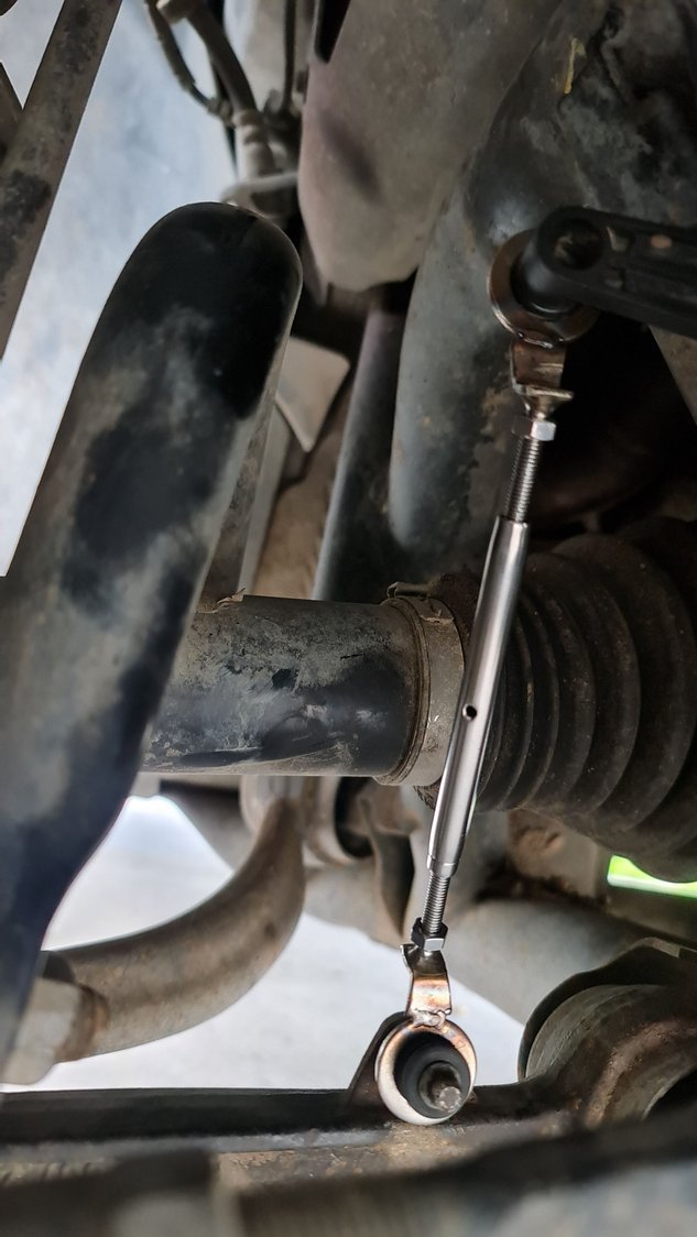

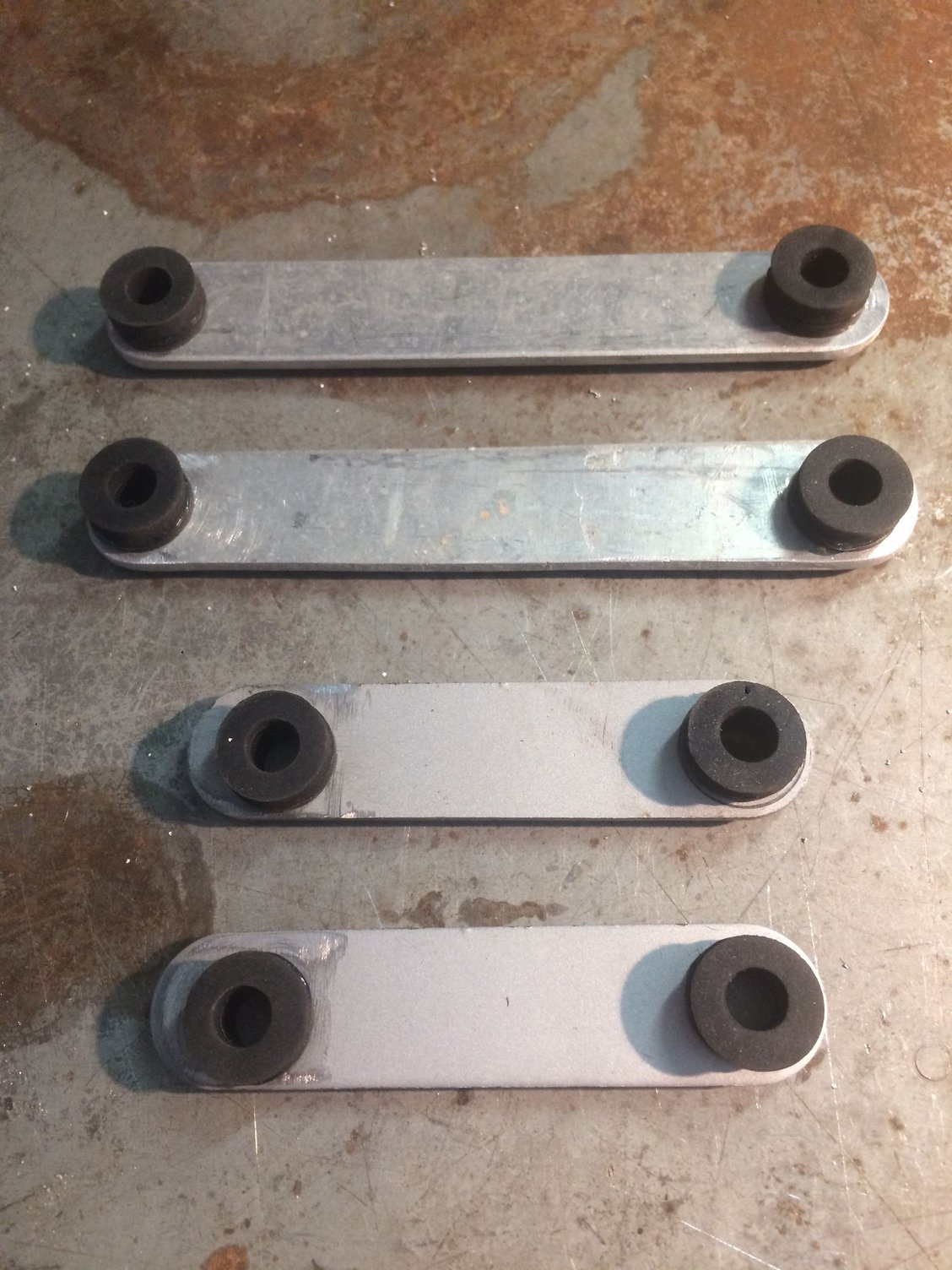

I followed your advice but custom made the rods differently. Total cost 20€ and a bit of work. Thanks

I custom made lift rods for my L494 RR Sport (see pictures above) but following Xrover recommendations but this is not valid for my model. To lift the car, front rods need to be shortened and rear rods need to be lengthened !
