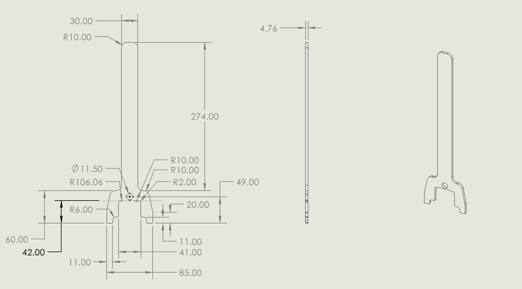

Hi All!
For those of you compelled to remove the fan from your truck, don't have the proper holding tool (a.k.a. part number 303-1143) AND want to act after some offered comment "... you should do something with all the scrap that you have in there or throw it away...", here is a drawing of an EQUIVALENT tool.
DISCLAIMER: I did this drawing based on a template that I took out of my own fan pulley in our LR3. This is not a copy of the actual part from Land Rover, neither a copy of any of the many available to be bought in Amazon, eBay, AliExpress, Tool World, ... Use and build it at your own risk!
Cheers!
Fillet: 1.0mm unless otherwise specified. Dimensions in mm.
