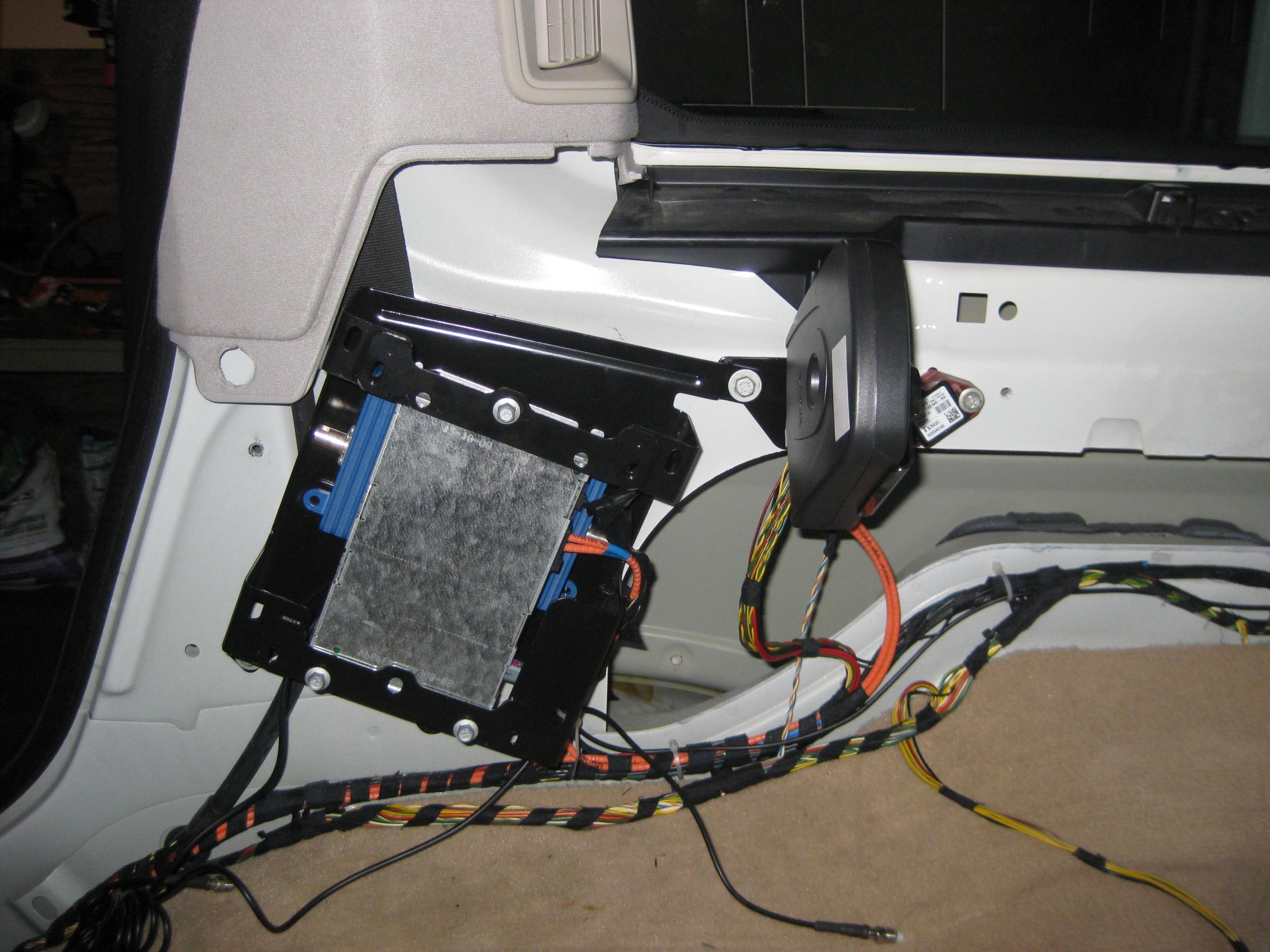

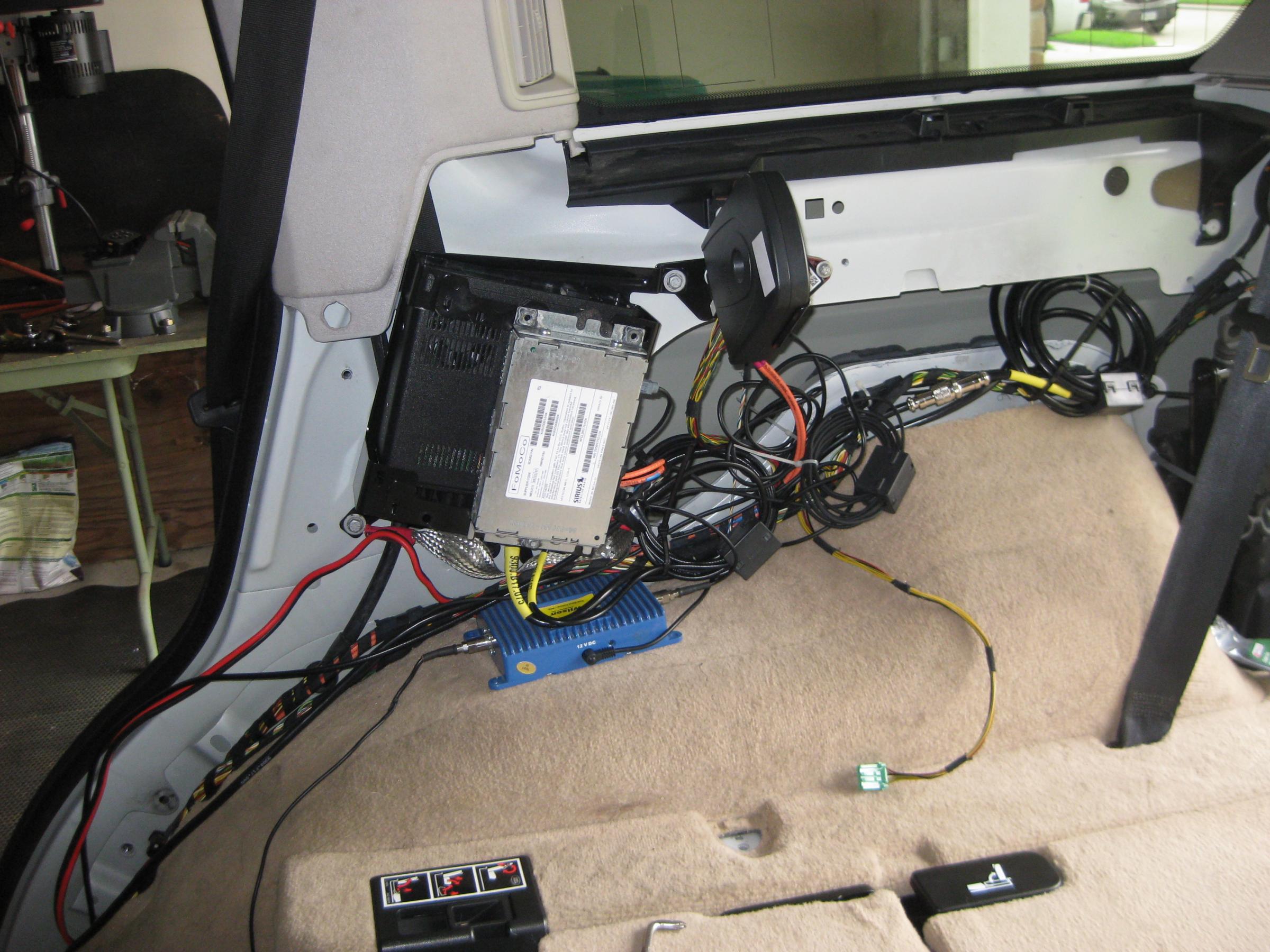

UPDATE:
I have moved the radio unit itself to a place behind the right rear trim panel. I also moved the VHF antenna to the left side of the hood.
Fist the main unit. After removing the trim panel as outlined in the manual, I had this...
https://landroverforums.com/forum/at...3-img_1623-jpg
I removed the satellite radio unit from the frame, removed the Wilson cell phone booster I had previously mounted in the frame. I found that once I removed the rubber feet and small bracket on the Icom IC-7000 main unit, it would slip into the frame for the satellite radio just perfectly. I wedged a small piece of foam in there to make sure it did not rattle. I removed the top of the trim panel and did a test fit ( with the top removed, I could see where I had room to mount the smaller satellite radio and cell phone booster). I found there was 2 inched between the frame holding the radio and the trim panel, so I mounted the satellite radio on the outside of the frame and used plastic tie wraps to secure the cell phone booster and all of the other wires.
I placed a number 31 ferrite clap on bead on the the mike cable, VHF/UHF and HF coax and the antenna tuner control cables. I tie wrapped them to the existing wire bundle and the end result before I replaced the trim panel looked like this:
https://landroverforums.com/forum/at...3-img_1631-jpg
I now have the radio unit out of the way from passengers kicking the wires or the dogs getting it dirty when the seats are folded down and all of the wires are concealed.
I does not look like it, but moving the radio unit from under the middle seat to behind the trim panel took me more than 7 hours. I had to re-route all of the cables to the new location which meant pulling out all of the wires back to the main hole in the fire wall and re-routing everything under the dash then along the right side door thresholds then up behind the trim panel.
You can't see that any work was done, but like most projects on the LR3, I feel good knowing I did it, and it is a better installation once it was moved.
