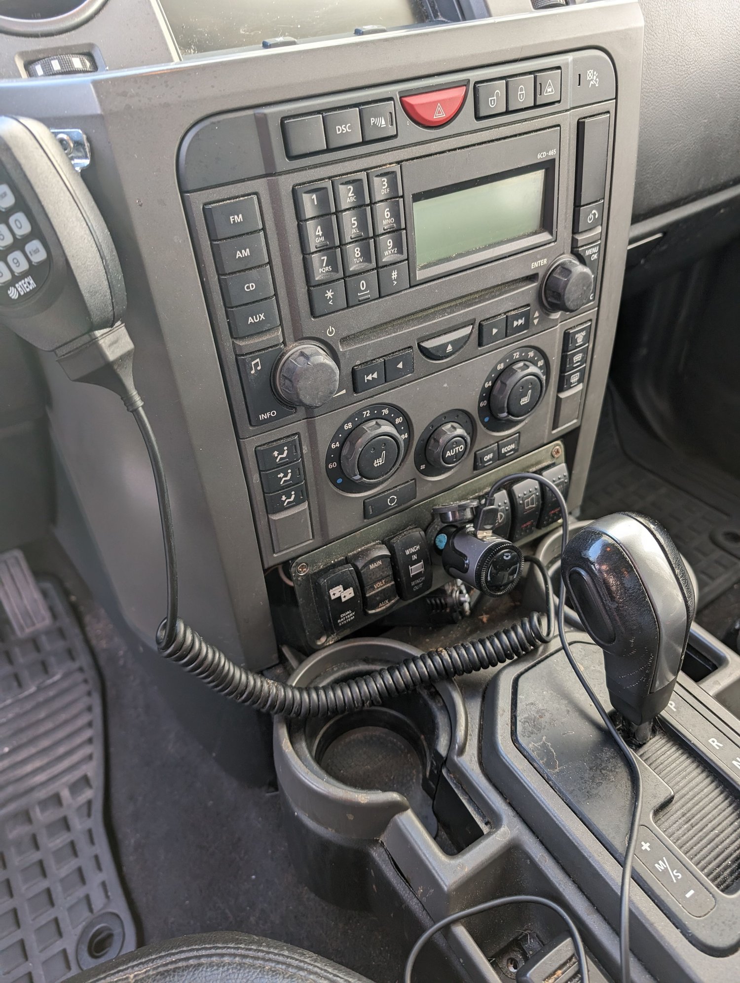

Sorry for the delay. Here's two pictures of the ARB bumper with fog light and one pic of my switch setup. Last one shows one of my 7" Hella lights. The box on the bumper is the adaptive cruise control radar from a Range Rover Sport. The fog lights are wired to the factory fog control switch. The Hella lights are wired to a switch panel in the center console. Third picture is a picture of my ham radio setup and center switch panel which has controls for 1. linking my dual batteries, 2. displaying voltages of both batteries, 3. winch control, 4. Hella light switch, 5. wired 'on' switch for my ham radio, and 6. a switch to supply aux battery power to the panel when the car is off (this lets me start the car with both batteries linked in parallel if the main battery ever runs down).
