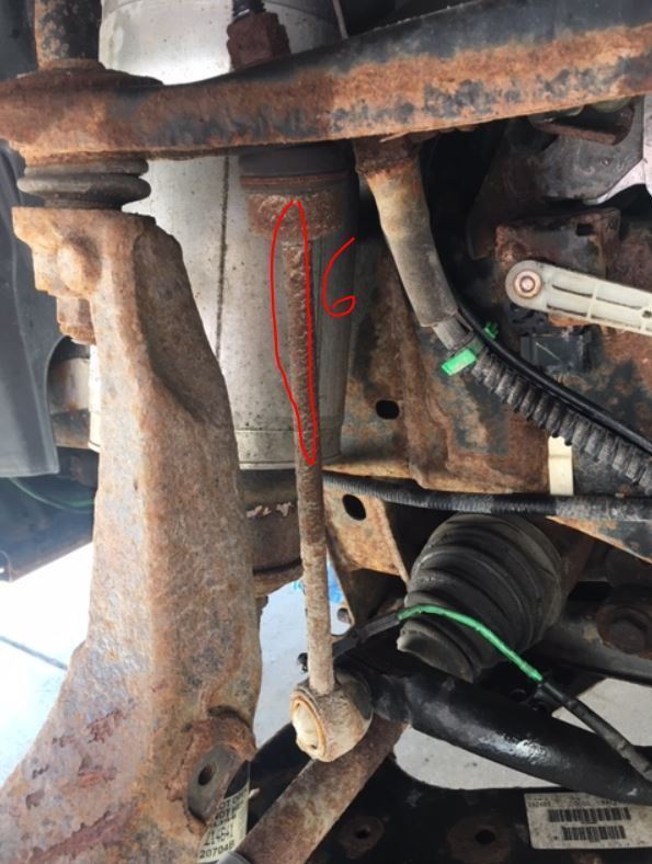

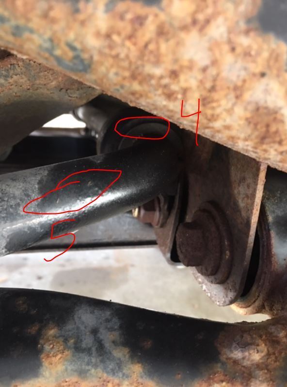

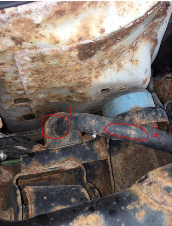

Hello All,
Been trying the search function here and been searching on atlantic british, however I cant find these few parts which need to be replaced. I'm in the process of all new brakes, lower/upper control arms fluids etc. Apologize if I'm using the wrong term, but I'm trying to identify these parts with part numbers. I've tried torsion bar, stabilizer bar and sway bar I can't seem to land a result. If someone can provide part numbers or a link to each, would be grateful! On the longer bars, theres two bushings, I'm not sure if Ill replace the whole bar or just the bushing, if you can help with the right term, hopefully I can find both.
1&2 rear (Torsion?) Bar and Bushing
3 Rear (Sway Bar? linkage)
4&5 front (Torsion?) Bar and Bushing
6 Front (Sway Bar? linkage)
Thank you in advance.

Here is your front parts
https://www.lucky8llc.com/collection...ac1-suspension
Here is your rears

Long black bars are sway bars. Those unless snapped do not need replaced

To add to this they are called stabilizer bars, stabilizer bar bushings and stabilizer bar links. For the front and rear. Section 204-01 and 204-02 in the workshop manual. Also a pretty helpful video at Atlantic British website.
