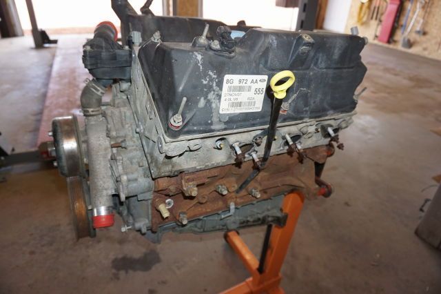

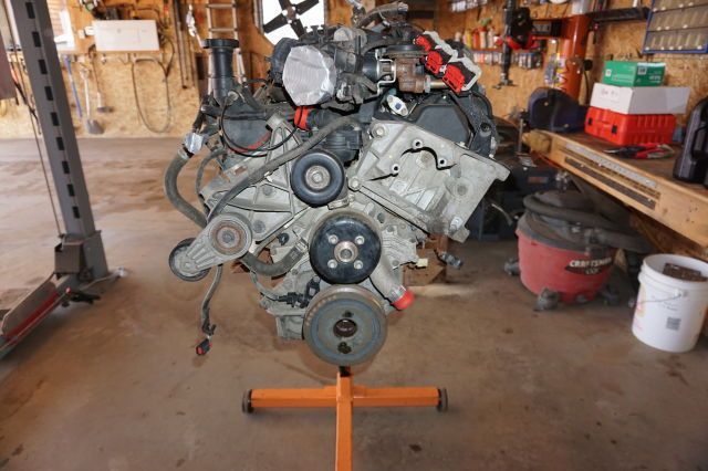

Just a quick update, have a 2008 Ranger VIN "E" engine with a bit over 100K miles, just replaced the hydraulic timing chain tensioners and ran it up to about 2000 rpm (using an electric drill) with fresh 5W-30 synthetic oil and new filter, lots of oil pressure and no strange noises. Attached are photos of before (ancillary components attached) and after (long block). Moving the machine out to the shop within a few weeks...

Make sure you check the oil pan girdle for a place to install the oil temperature sensor. You have to have this sensor. I broke the wire to the sensor during installation of my engine and the truck went into fault mode. Lowered suspension, engine check light, etc. I can't see if there is a plug on yours or just a casting boss.
As I said before, I cannot stress enough the importance of at least changing the rear (passenger) side cam chain guides while you have the engine out. You have to pull the engine to change these. Ideally, you should do them all. Do it now.

@5280LR3 Thanks for that, we have not pulled the engine on the LR3 yet, but when I get out to the shop this week I'll examine the Ranger block. I was thinking of mounting the oil temp sensor to an extension off the oil sender location which is just forward of where the oil temp is on the LR3 engine. If not, there must be some way of tricking the temp sensor into believing that the oil is at some fixed temperature? As far as the timing chains go, they tightened right up as soon as we spun up the engine and it got oil pressure, so going with a pre-oiler/pressurization system from Moroso to ensure that chains are tight at startup. The Ford Explorer/Ranger forum has many tales of the 4.0L V6 SOHC timing chain issue and they are unanimous in advising pre-pressurization methods to eliminate chain slap at startup. I did install new hydraulic tensioners and with the Moroso unit should never hear the dry start ticking. I will be rebuilding the original engine with new chains, gears and whatever else is required, but am planning on some experiments with an Eaton M90 supercharger, maybe, perhaps, possibly... Thanks again for your help...

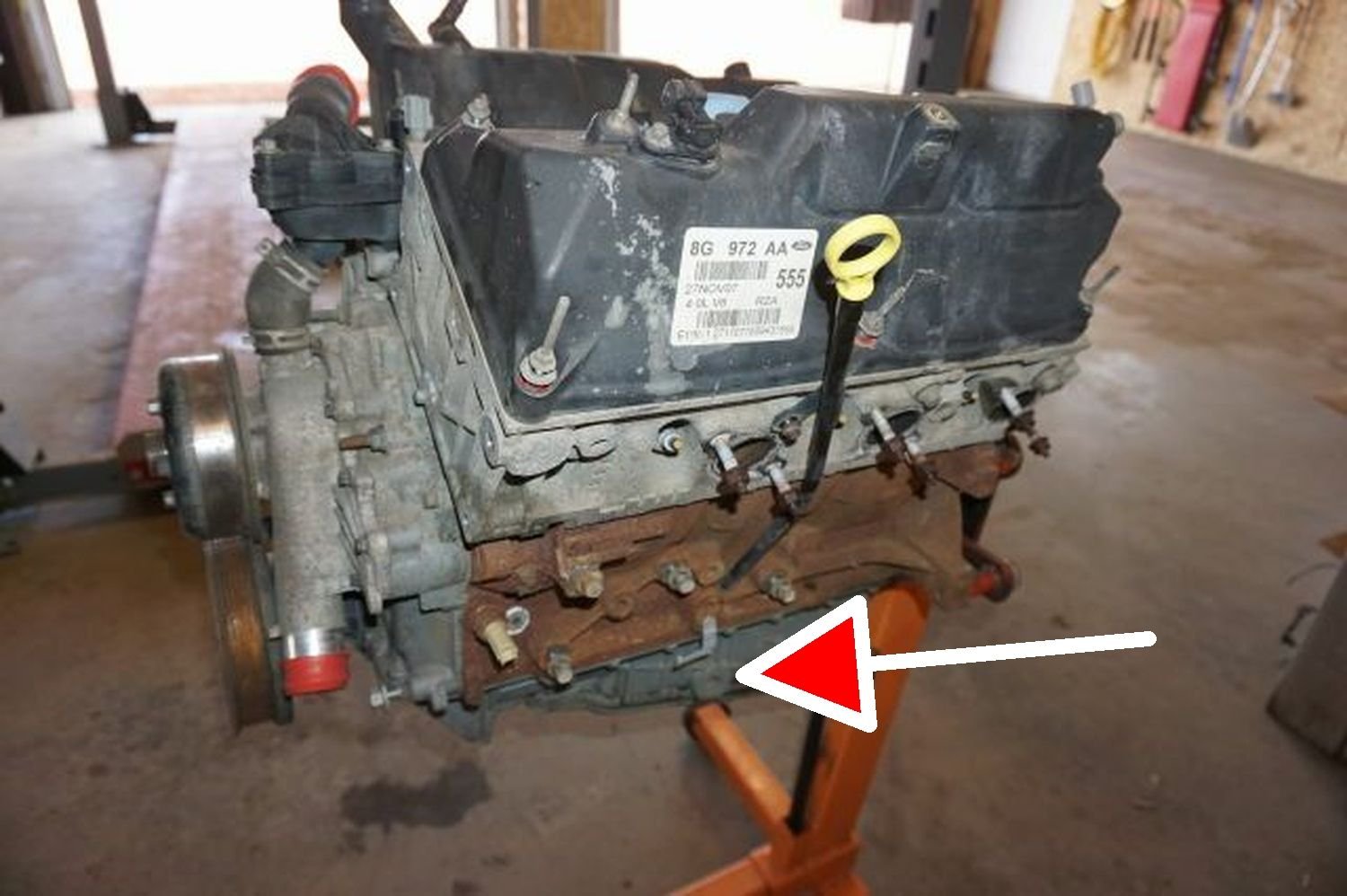

Well, looks like I spoke too soon about that absolutely necessary oil temperature sender, we will either have to figure out how to make it look right to the ECU or use the upper oil pan from the Land Rover, unless by luck there is a dummy plug in the Ranger pan, some Explorers came with an oil level sensor in the same location. The LR3 ECU needs that oil temp measurement to calculate torque load which of course influences throttle control, blah, blah, blah so tricking the ECU is not going to be an option. I guess Wednesday will tell when I get out there...

Well @5280LR3, looks like I will have to figure out how to re-invent the LR3 oil temperature sensor location or use the oil pan from the LR3. I sure hope to figure out a solution, the indent is there but plugged and not threaded, will have to wait until the machine is at the shop and we get the engine out before the crying begins. The crying part won't likely last long, there are always solutions if you persevere. Have we all not seen those Russians solving these complex problems with simple hand tools on YouTube? Or maybe not...???...

OK, get the oil temperature sensor plug off the lower drivers side (North America) oil pan BEFORE removing the starter motor, and remove BOTH exhaust manifolds. the Ford overhead valve covers will NOT accommodate the Land Rover intake manifold so be really careful at engine removal time, we are removing the engine mounts once we get some tension on the engine, have fabricated a homemade mount which lifted the Ford engine, stand and my 160 pound friend so we feel safe using it to pull the engine, likely this Saturday.
