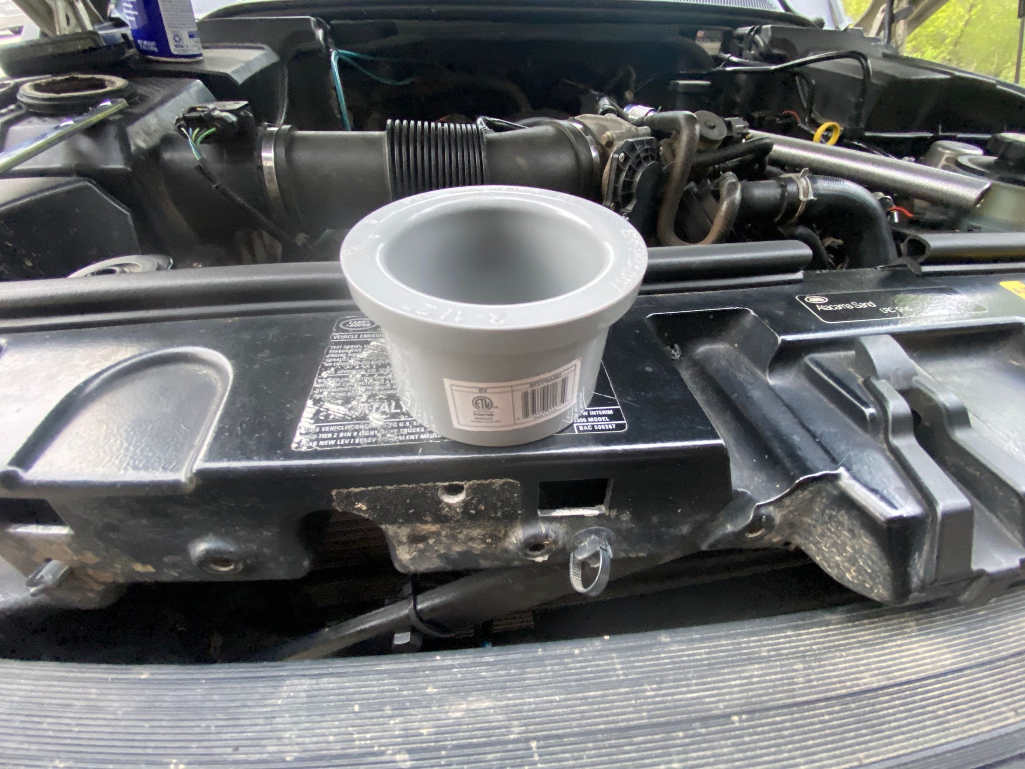

I may have found a "tool" to do the job for $5 USD.... A 2.5" electrical conduit to box coupling. It is dang near a perfect fit. And I think I can use the crank pulley holding took kit parts to drive it in. Guess I will find out. But even so a gentle hammer should even work. I mean if a 3D printed one works, this should hold up fine. The plastic is pretty thick and the one I actually bought from Menards has a much thicker "hat" which is the end where force will be applied to drive it in. The smaller end fit really good on the seal's surface with only slight contact on the inner dust lip. I just have to be careful not to drive it in too far. I will be making some marks on the tool with the old seal in place. And with a caliper I should be able to set the new one to the same depth.

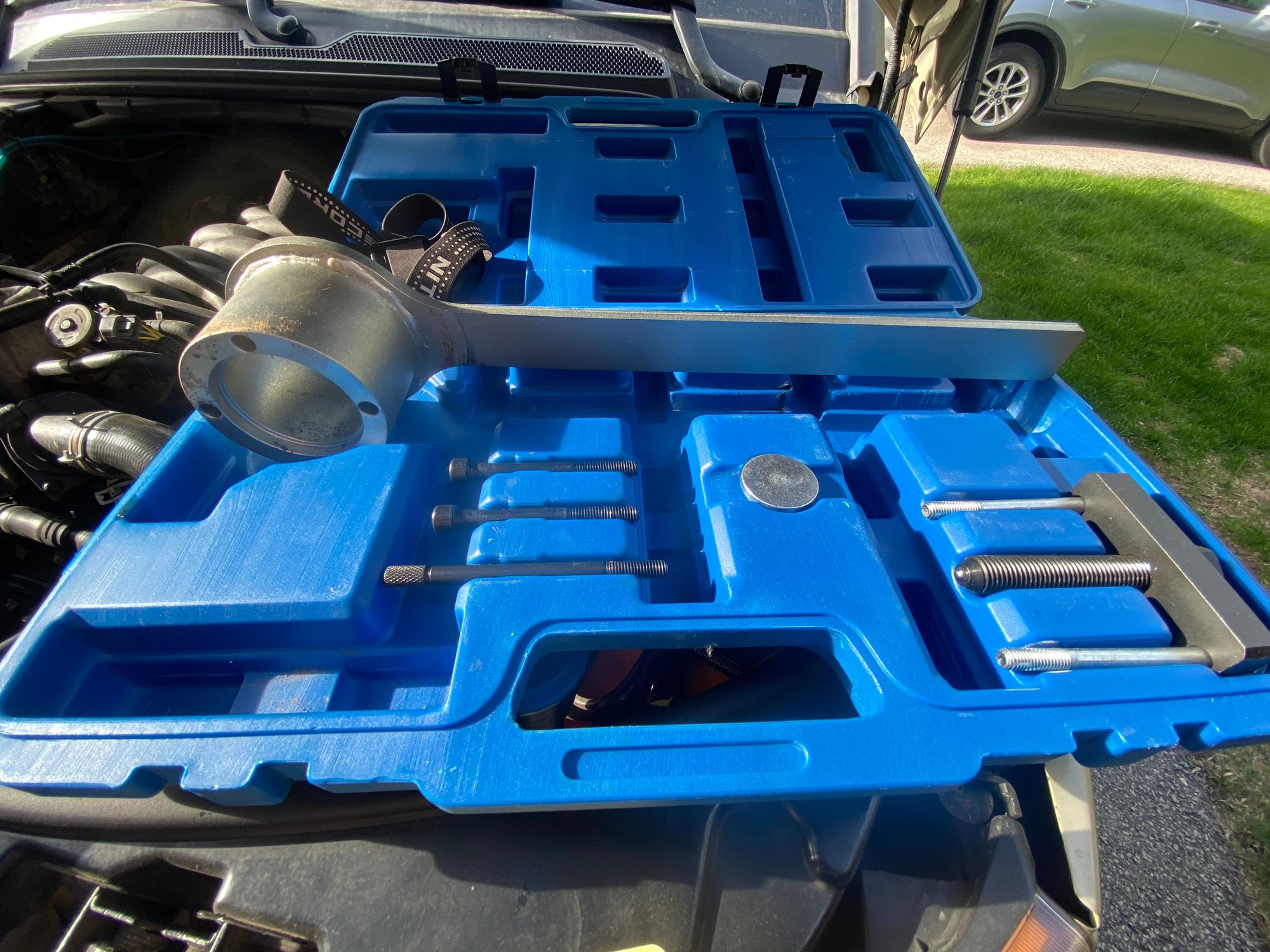

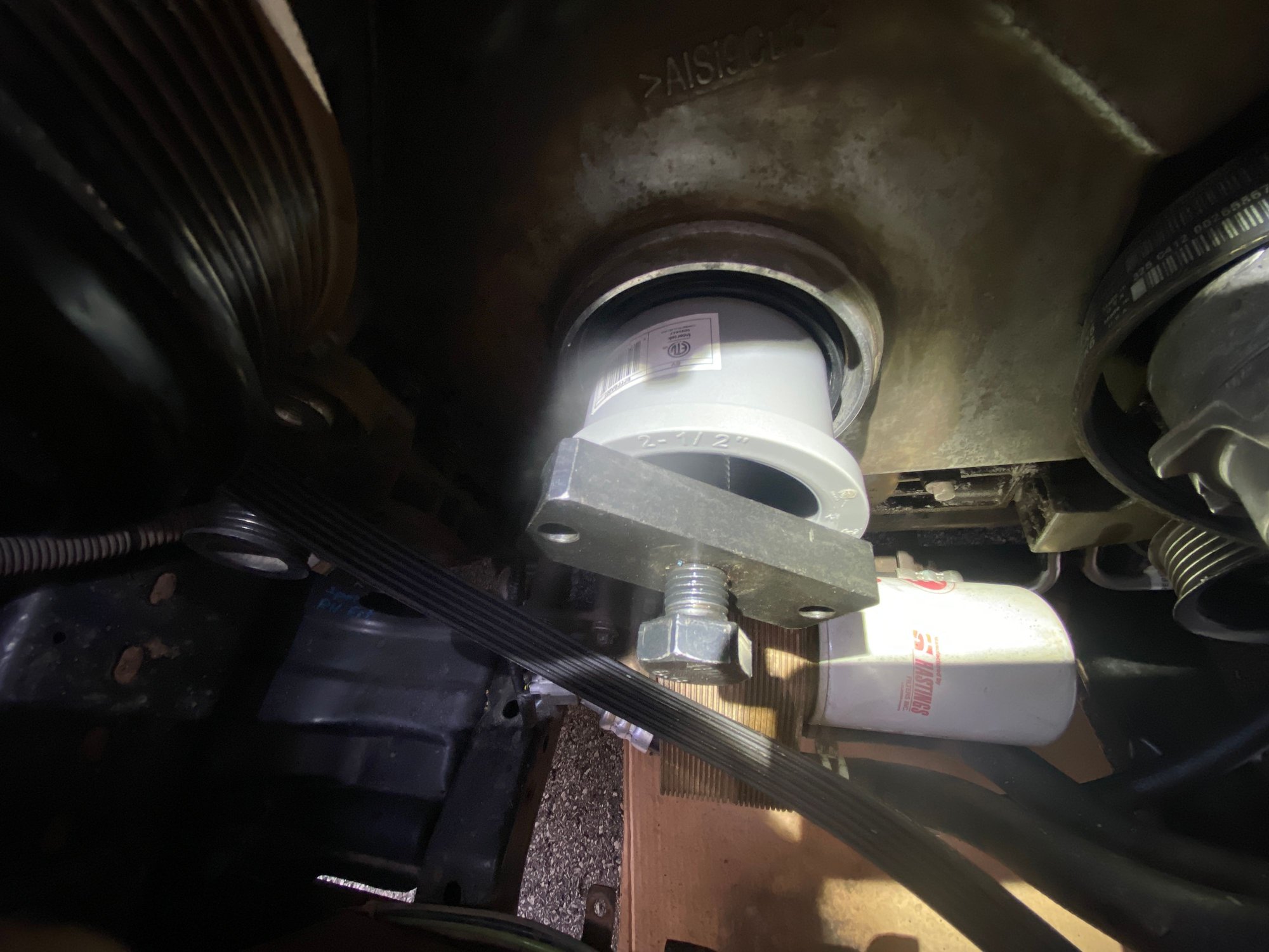

New seal installed. Sadly it was not leaking! I was deceived by messy oil! But my setup worked well. The "tool" was an electrical box adapter, part BPFPBA007. Used in conjunction with the crank holding tool kit. You really need the crank holding kit, about $80 USD, to do this job. With that kit I used the puller to install the seal with the electrical box adapter. Carefully centered the adapter onto the tool and spun the metal block. The bolt was barely finger tight and not touch! It does NOT match the crank thread but got enough bite to do this job. Initially I tried with a hammer but it was tricky and hard to get it even.
Again, when installing the surfaces must be clean of all oil and the Rover must now sit for at least four hours so the seal can sorta mould itself to the balancer for a proper fit.
