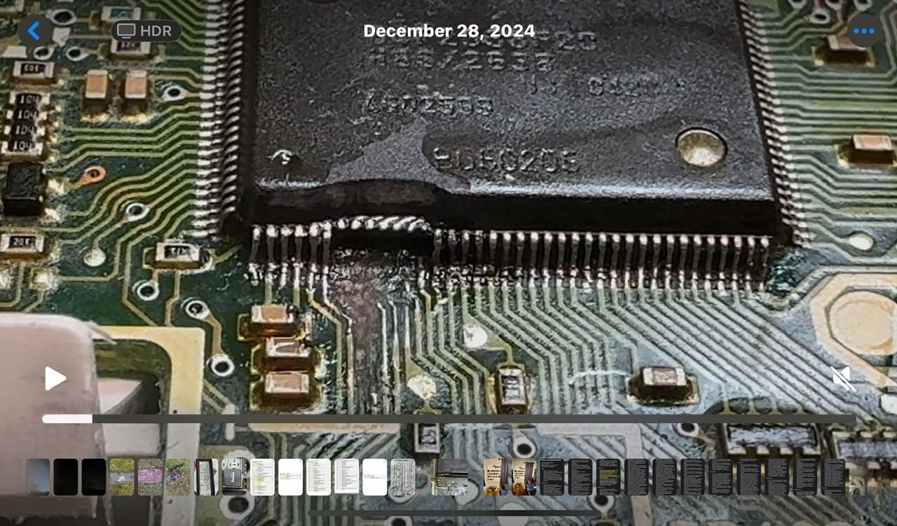

Long story short, I have a ton of MILs and faults, I thought it was the instrument cluster connections as so many others have had issues with that and all the modules had lost communication to the IPC. Soldered the connector connections just fine and then tried to re-flow the main IPC chip and totally messed up a selection of the pins on the chip and the traces on the board. Oops, my mistake, I’m handy but apparently not that skilled when it comes to soldering, lesson learned.

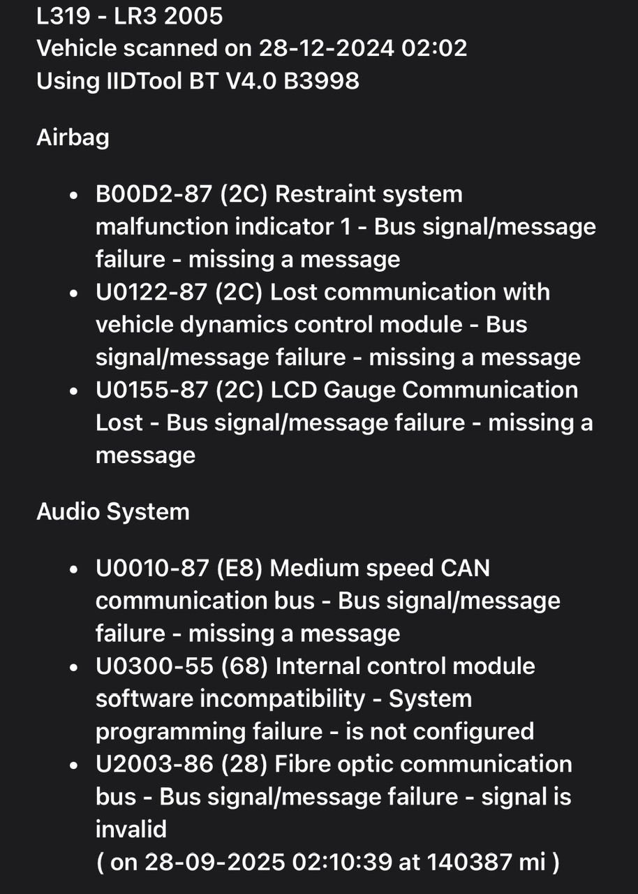

here is a list of the codes I was able to pull the last time the original IPC was still recognized when it was in the vehicle. Now it doesn’t recognize the VIN or the ignition status thanks to my ****up when trying to re-flow the main chip.

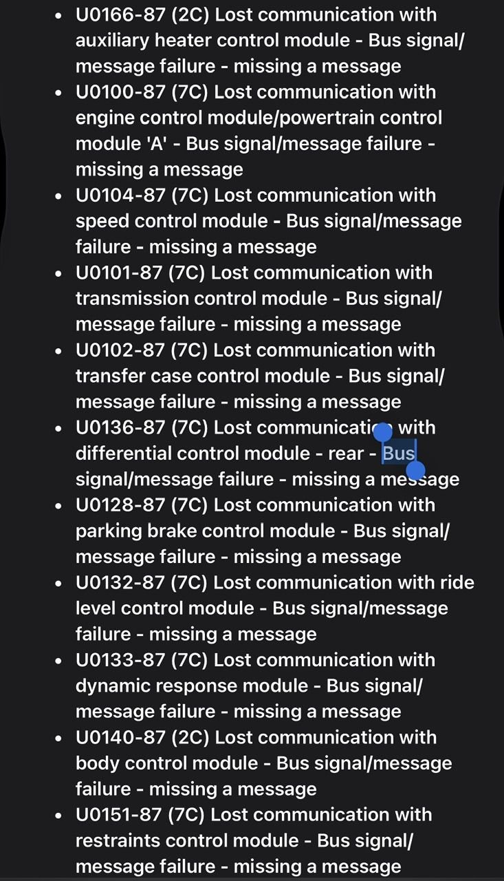

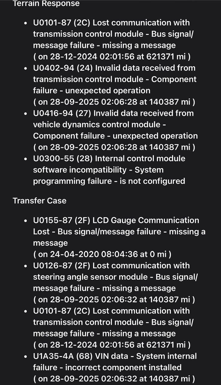

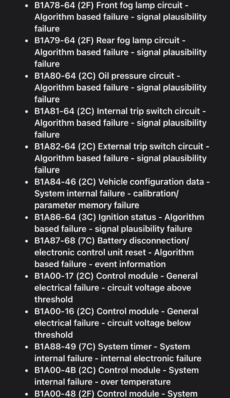

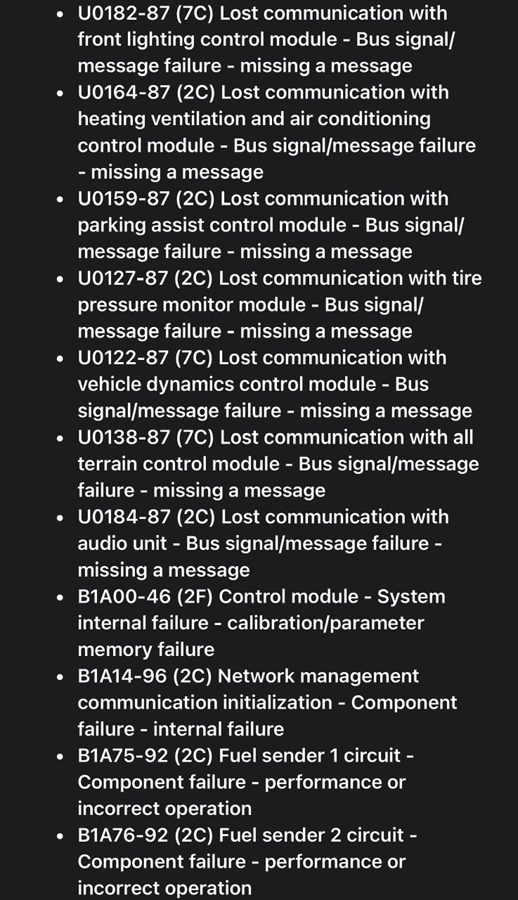

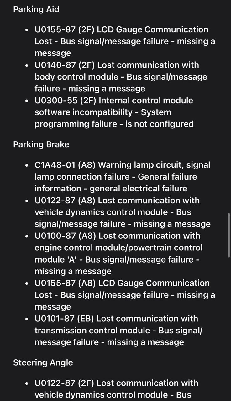

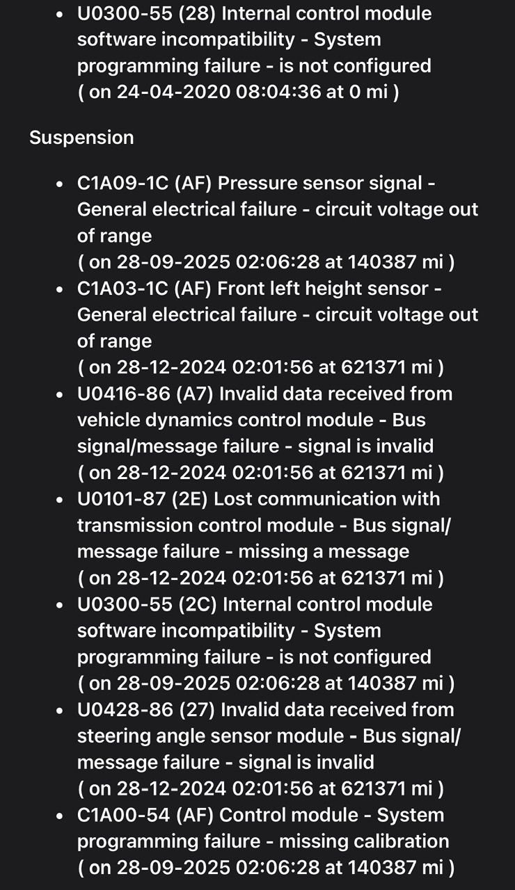

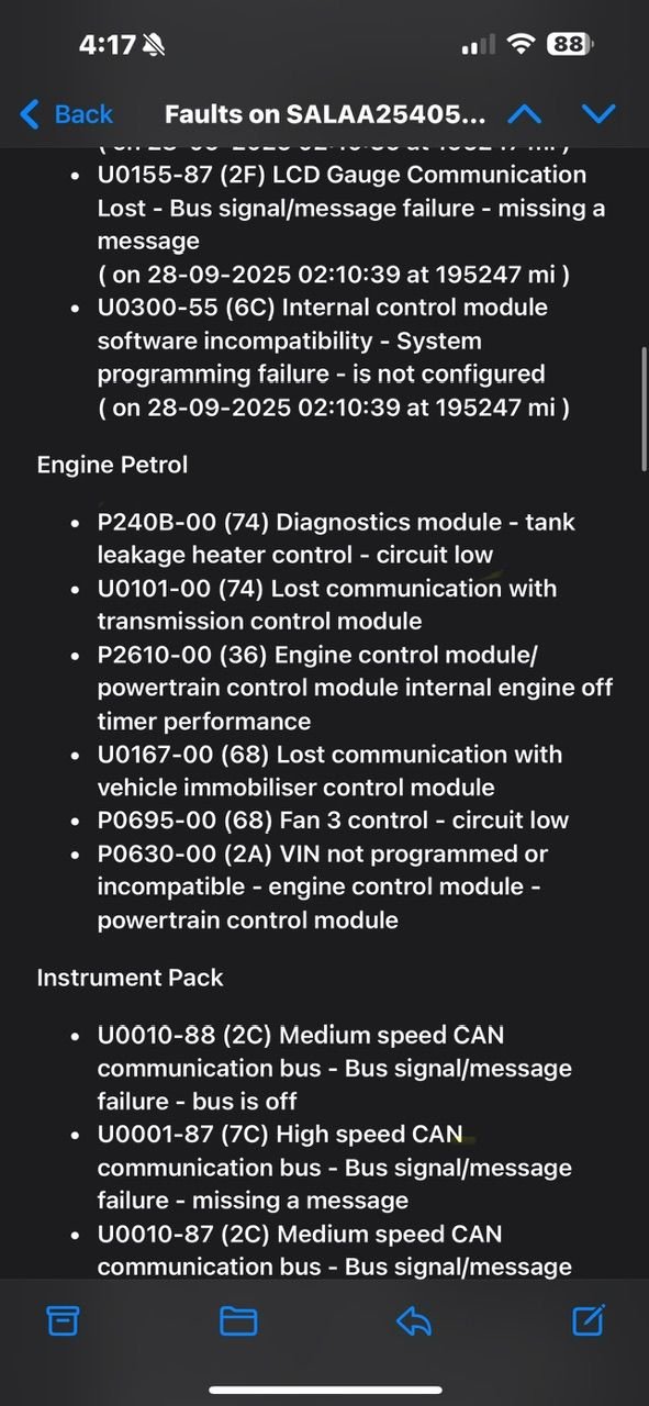

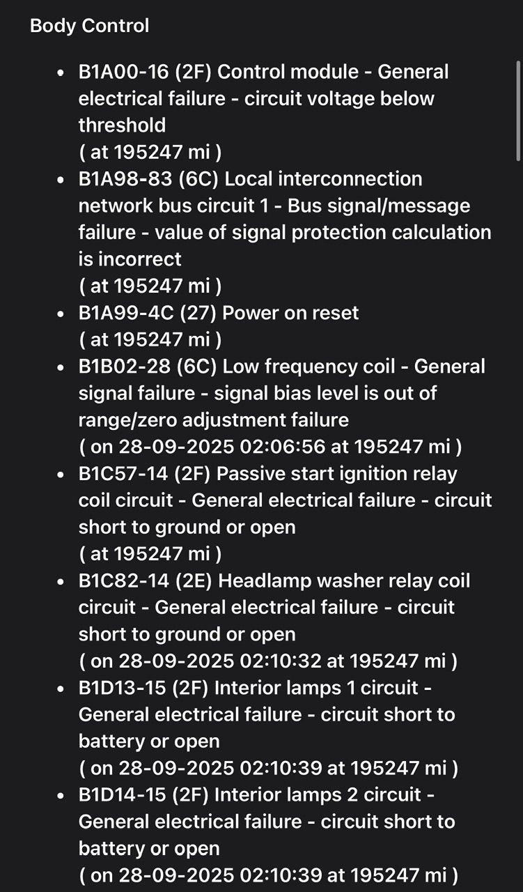

Actually here is a more accurate list of the faults and codes I have now.
