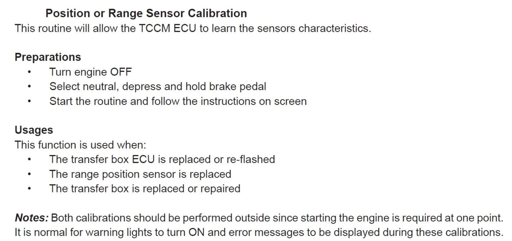

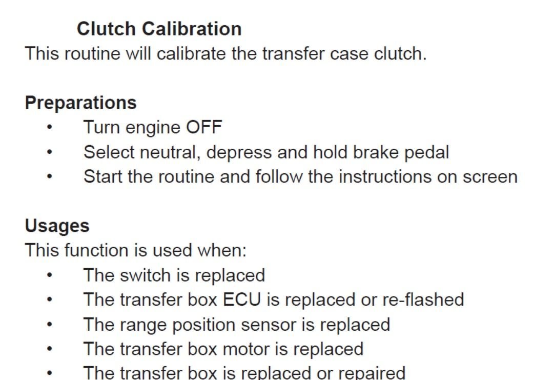

I faced similar issue without being able to start, locks cycling and all the warning lights. While I cannot recall the exact order of things as so many attempts were made, aim to clear what faults you can with the Gap. There is a calibration that will need to be done on transfer case clutch and range sensor. Believe the key should be in the ON position. I'm not near my tool to pull up which menu the calibrations were under. May be as simple as in the Calibration menu but may also be a bit further buried.
