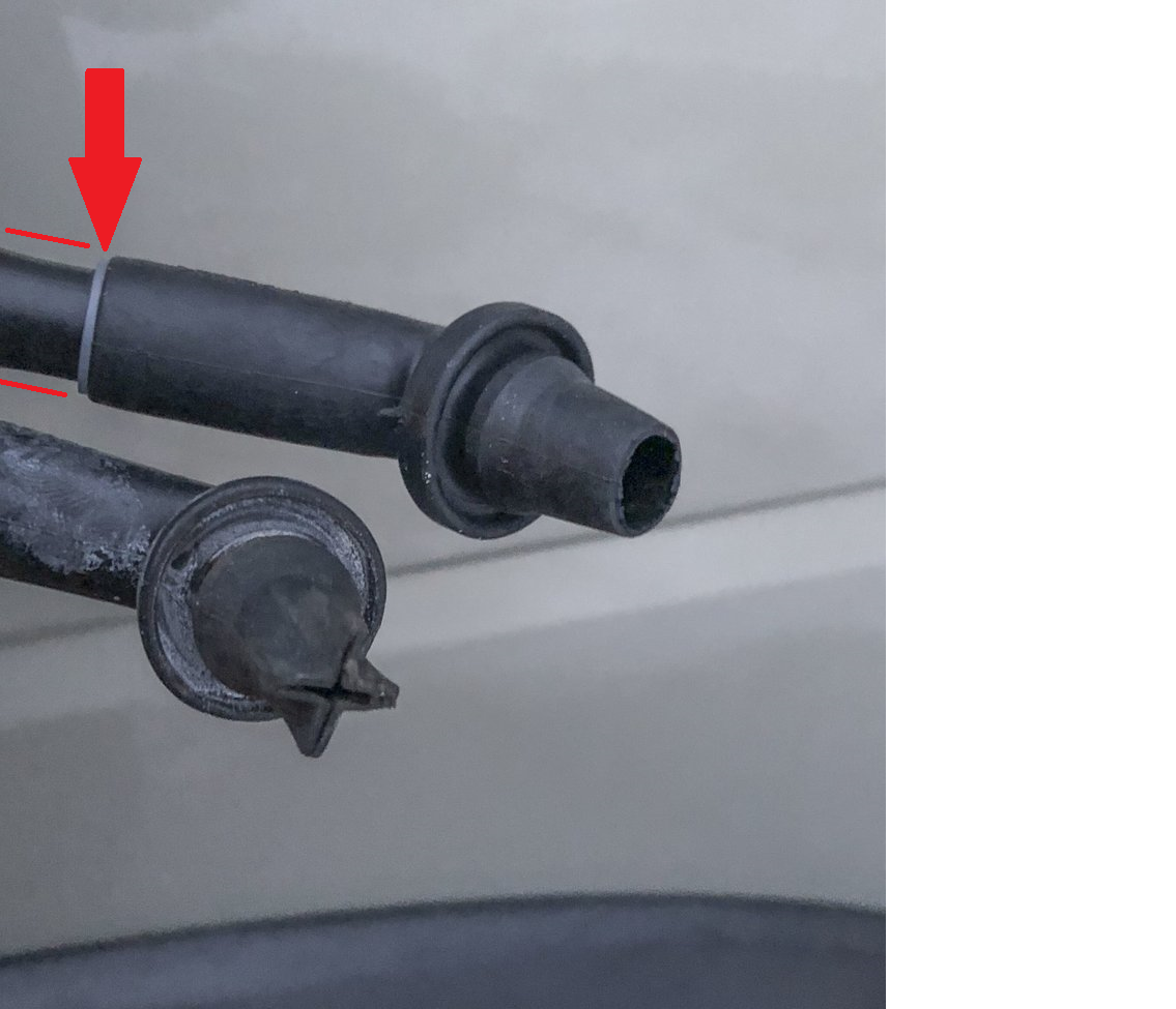

I am working on the passenger side sun roof drain tube. I have only had limited daylight to work with. I purchased the 12mm push to connect connector but ended up not using it. The new drain tube I purchased off of eBay came with a white plastic piece that was not on the original I took off. I cut the tube around the white plastic piece and just stuck it in the exposed drain tube. It has been a pain so far.
I got the tube in, and will add some silicone to keep it firm where I want it. Before you start the process (I would recommend paying someone). Make sure your passenger seat is all the way back. Also if you go the push to connect method you can put a little vaseline on the tube to help it squeeze in there. It’s a really tight fit and there is a good YouTube video on how to do it (makes it look real easy).

You can see the plastic on the new piece shown by the red arrow. The one I received had a small plastic tube that went up where the red lines are drawn. I simply stripped the hose off of the new piece where the red lines are, and stuck it in the old drain line. Much easier this way, and a great fit. You can add some adhesive to ensure a good seal.

Do not use vaseline.
Just use a push connector. That nylon insert is a one-time fit onto the tube.
Well now you tell me
Guess I will be the guinea pig for what I tried. I just plugged in the rear connectors on the back of the fuse box this evening, and I’m not doing that again anytime soon (was a really tight fit).
